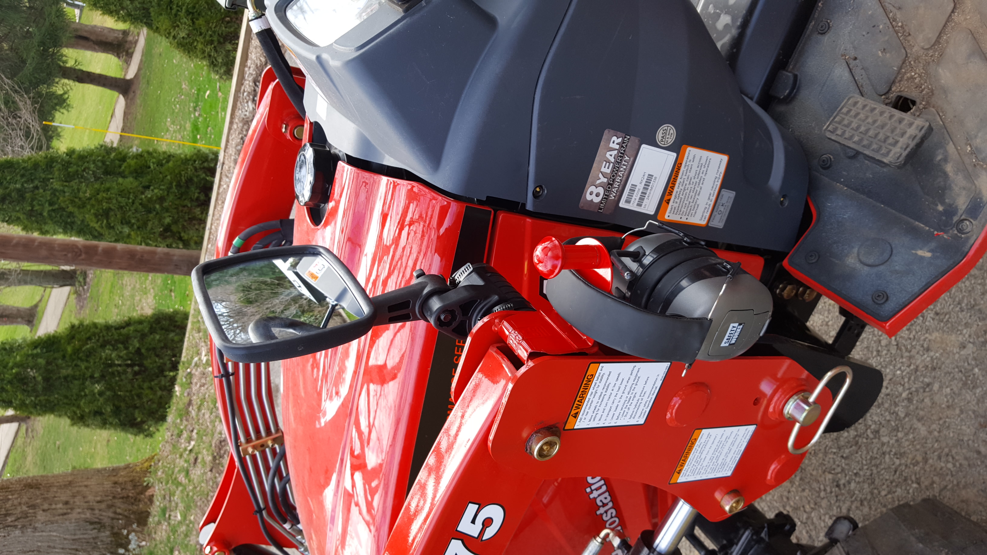

Mirror

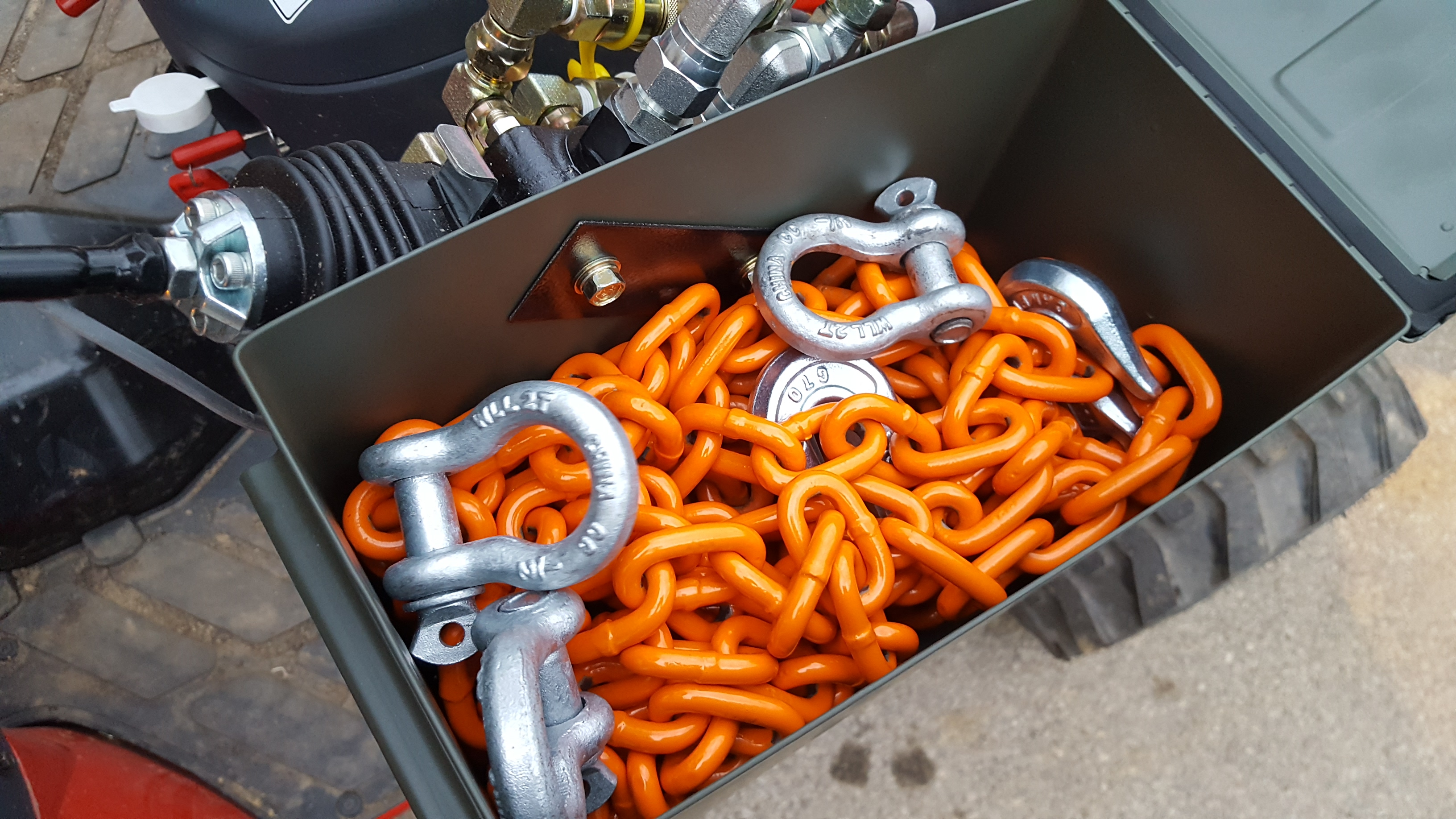

Tool Box For Chains
Caddy for FM Headphones
The mirror is an ATV mirror purchased from Rural King. I ended up tack welding a 4" piece of steel pipe to the side of the loader frame to mount it where I wanted it.
The location works perfectly, clearing both the hood when it's up and the loader arm when it's up. Since it's just 2 small tacks, it's easy to remove if I ever want to.
The pipe is painted to match and wrapped with rubber tape to provide a grippy clamping surface. (FYI Rustoleum Sunrise Red is a perfect match to the RK red color.)
The tool box is just an ammo box from Harbor Freight. I cut the carry handles off to keep them from rattling.
I drilled two holes in it and bolted it to the side of the loader control valve frame using two of the existing bolts.
I added a backer inside to keep the bolts from ripping out with heavy chains in the box.
Waterproof, and required no modification to the tractor.
The headphone caddy is fashioned from half of a Harbor Freight magnetic paper towel holder.
I just popped off two of the three magnets, trimmed the sheet metal with tin snips, bent it to shape, and painted it to match.
It hangs right on the loader frame without drilling any holes and keeps the headphones within easy reach.
It can't be seen in the picture, but there is still one (rubber coated) magnet on it, just below the bend, that holds it fast.

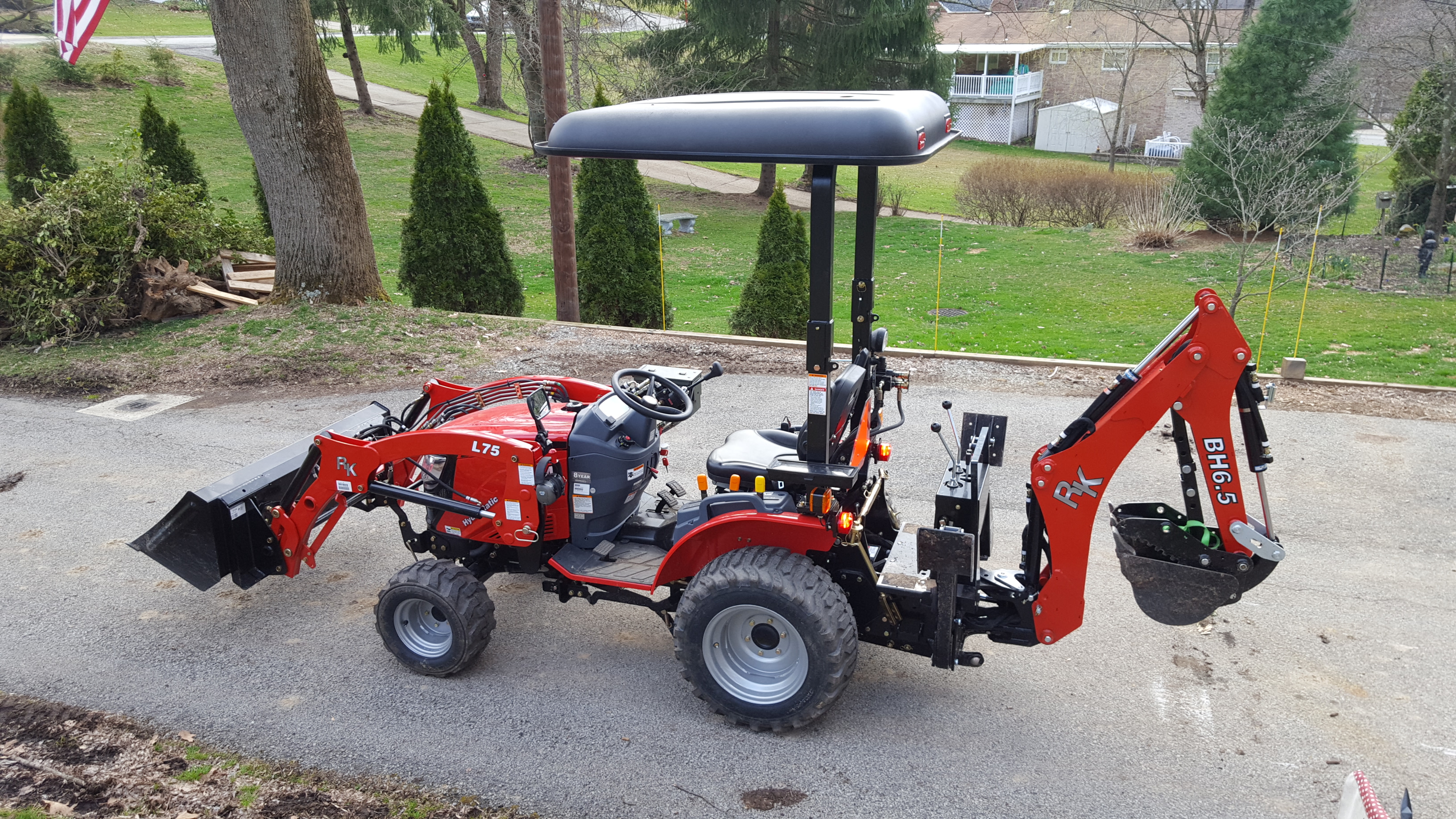

I also finally got around to throwing the roof on it momentarily to make sure it fit.
(It won't fit in my garage with the ROPS up, so this is the first time I've had the roof on.)
A note on the roof:
Apparently this is a one-size-fits-all roof for the RK tractors.
Since I purchased mine separately (not pre-installed), I had to make one quick adjustment to get it to fit on the RK24.
The brackets that bolt to the roof frame (and clamp to the ROPS) were too far apart and were hitting the curved corners of the ROPS.
They simply needed unbolted and flipped, to put them closer together. This way they clamp on the flat, top section of the ROPS.

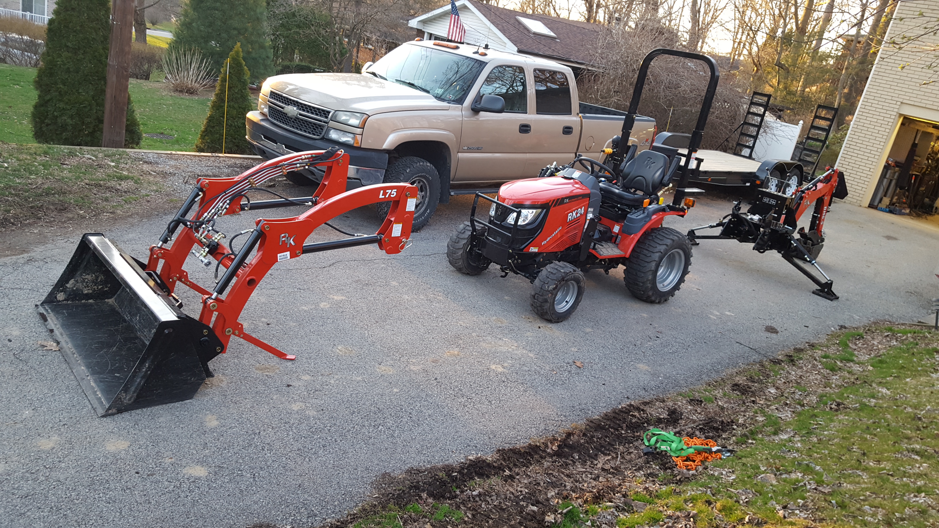

I also took the loader and backhoe off, just to see how easy it is.
It's pretty easy. I had them both off and back on in a matter of 15 minutes.
