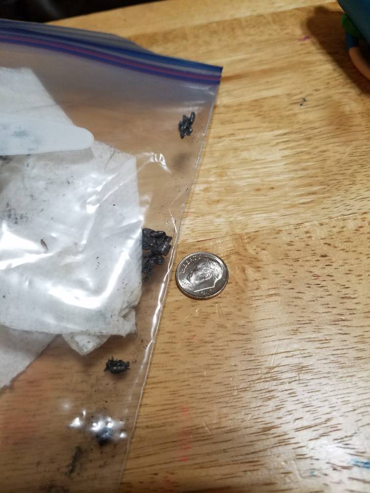

Apparently having plentiful and sizable metal shavings at your first 50 hour Hydro change is normal for tractors. They apparently dont clean up the metal shavings from the required drilling. Since many of us are new and may not know this, sharing here. You can see the grooves from the drilling 20180719_082354.jpeg

Apparently having plentiful and sizable metal shavings at your first 50 hour change is normal for tractors. They apparently dont clean up the metal shavings from the required drilling. Since many of us are new and may not know this, sharing here. You can see the grooves from the drillingView attachment 587644
You know, it varies, and most tractors nowadays don't have you change the hydraulic fluid until 200 or 300 hours so by then quite a bit may get collected. I have not found any metal shavings in my last three tractors other than fine particles on the magnetic drain plug (more like gray sludge). But one fellow here on TBN extracted a clot of shavings that looked like a Brillo pad! That would not be comforting to me.

Hydraulic systems, differentials will have metal at the first service (Don’t be alarmed), ALL industrial Equipment I service at work REQUIRES an early service to flush the system, even tractors. Follow the service manual for intervals.
All products above I use, and have seen keep equipment going upwards of 30-40k hours.
