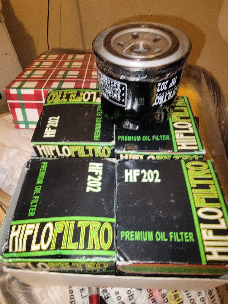

I also had to wait for the engine oil filter but it did show up in the store eventually. Turns out that except for color, it looks exactly like a Honda HP 202 oil filter.

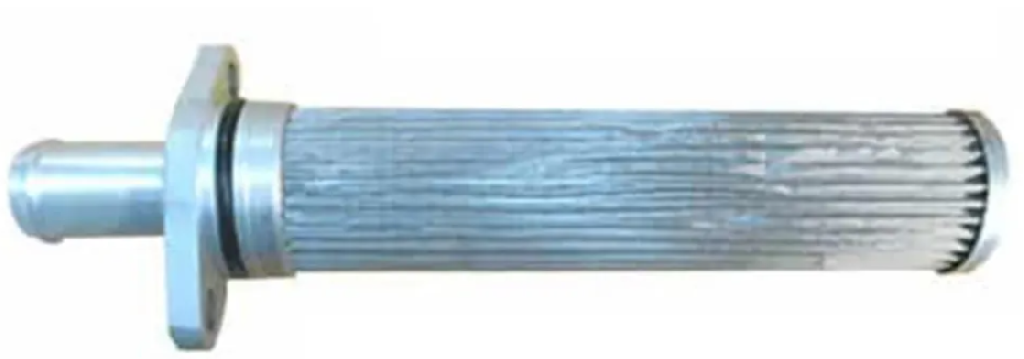

Just reassembled my RK37HC and will put fluid in tomorrow in daylight. Turns out I can’t get the mesh filter out without bending or damaging it. The opening is exactly the diameter of the end caps and the far end has a lip that catches on the casing, plus there is no room between the opening and the loader frame. You have to remove, or at least move, the port loader FRAME beam to get this out. You can get ½ to ¾ out and then wash it with diesel while still in place. Rotate and spray diesel in the tube opening to wash the inner part. Leave the Hydraulic drain plug out as you do this so the diesel can run out. On mine, most of the metal flakes / dirt seemed to be near the spout so I think it is adequate. But lots of wasted diesel - sprayed from a spritzer to give it a little umph.
