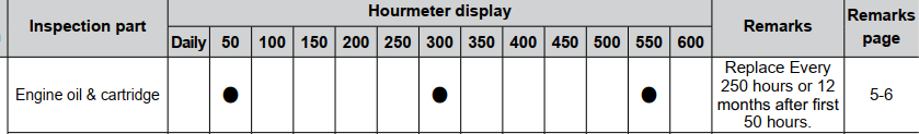

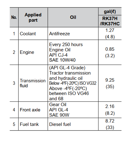

37HD, the manual is kind of confusing to say the least. If you look and the table listing capacities is shows the crankcase holding 6 quarts with filter. Yet in section 5 under maintenance it shows the service taking less than a gallon. A couple months back when I did my second service I put in just put in just under a gallon and the dipstick shows right at the full mark.
I had never noticed the table showing the 6 quarts so I have no idea which is correct. I'll have to check with the RK folks next time I'm there.

Thanks guys. I'm going to drain oil measure and keep it. My store has had 3 different tractor guys in the past year. The new one said change oil every 50hrs. I showed him the maintenance chart. Next scheduled oil change at 300 hrs don't think I'd wait that long. I agree owners manual is confusing. I asked if I could buy a service manual I don't think RK is allowed to. I haven't got to it yet other chores to do without tractor. Manual says to use 10w40 cj4 mast diesel oil is 15w40 what do u guys use ?
   / RK37H oil level increasing #9
I feel that the purpose of oil is to not only lubricate but also the additives are for rust/corrosion prevention. If you notice, the manual states every 250 hours or yearly which ever comes first.
