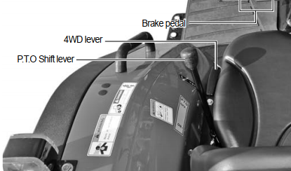

New user and rather new tractor owner only have about 10hrs so far and that means it's time for a dumb question. Is there any issue with leaving the PTO Shift Lever in the On position since you're controlling the PTO on/off with the switch and button? The lever is rather difficult to get in and out of position and it seems a little redundant.

Ransom, I have never noticed anything in the manual warning or addressing an issue with leaving the lever engaged. Maybe someone else knows of a reason. Only thing I see with it being engaged is that when attaching an implement the PTO shaft is locked and for me it's easier if I have the ability to turn the shaft slightly if need be to align the splines. It does seem kind of weird to have 3 different interlocks doesn't it?

Correct the PTO Shift lever is just another engagement, it takes shift lever to be on, plus switch plus button for it to then spin. When just leaving the PTO Shift lever is left on nothing in spinning or engaged.

Gunny, the two switches are the button above the ignition switch and the rotating switch is below the ignition.
The PTO lever that Ransom is talking about is to the left side of the seat.
Does seem like an over kill for safety............

The PTO shift lever serves two purposes.
One is putting the PTO in Neutral and therefore, the shaft can be rotated easily by hand, instead of being locked by the PTO brake.
The other purpose is to change between speeds. They doesn't seem to offer that in the US on the RKs and maybe the TYMs (?), but on other countries they ( TYM in this case) offer two speeds on the PTO, the regular 540 and the Economy 540 (540E) which is a great thing to have by the way. It's not uncommon to have 3 speeds either.

The PTO lever on the RK37HC sticks up too high. It pokes me in undesirable places when I get on and off. Leaving it in the On position helps but still sticks up too high. I released the stopper nut and screwed the knob down all the way. Better but not perfect. I would still like to have the shaft made shorter to be a couple inches below seat level.
I am tempted to leave it On permanently and remove the shaft. I can spin the shaft on my rotary mower by hand if I need to align the splines. I have not done it yet...
