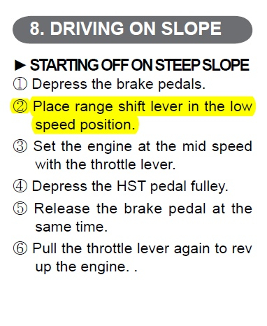

Just common sense. Low range is for operating under heavy loads such as driving up a hill with a backhoe fitted. 4WD increases traction. 4WD will be most valuable coming back down the hill.
It may go up a hill in mid range but doing so will place more stress on the components. If that were not the case the tractor would not be fitted with 3 ranges to begin with.

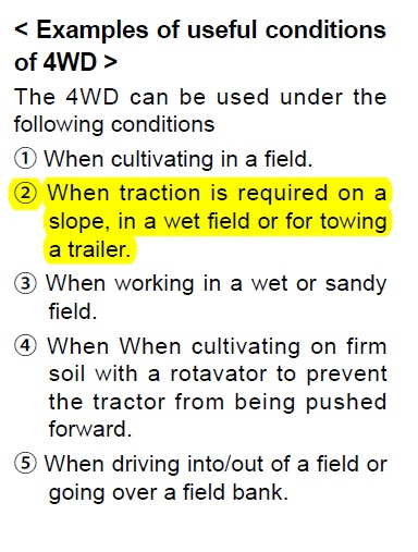

Slope instructions from the manual:
4WD Use
   / RK55 HST slipping probelm #16
Tractorguy, that is for starting off on a steep slope. If you use a higher range the tractor will not move as the transmission bypasses. Unless you just sit there with the hydro not moving and the pedal mashed your most likely not going to mess much up. I learned how to use differential braking due to the front on tractors being too light to steer when going up the hills were I grew up.
