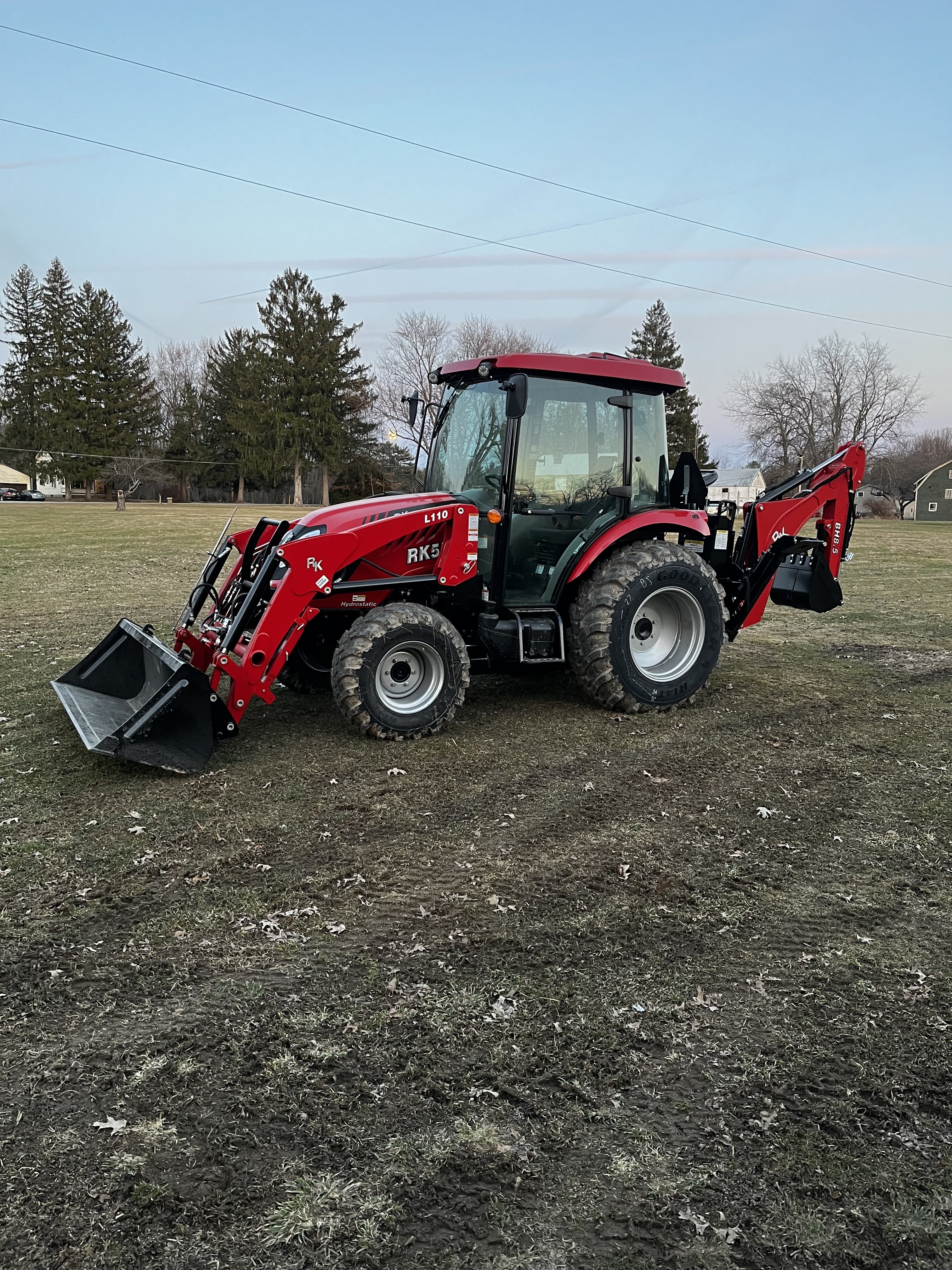

Hello all. I recently bought an RK55 and it’s finally dried out enough here in NW PA to use it without tearing the daylights out of the ground. My first issue is this deafening, ear piercing reverse alarm. Doing loader work with this alarm is insane. I am sure it’s not as simple as a dedicated fuse you can just pull and replace as needed. It sounds like it’s in the rear left of the tractor. The backhoe being installed doesn’t make it any easier to look for. What have you all done? Just go deaf? Thanks in advance!

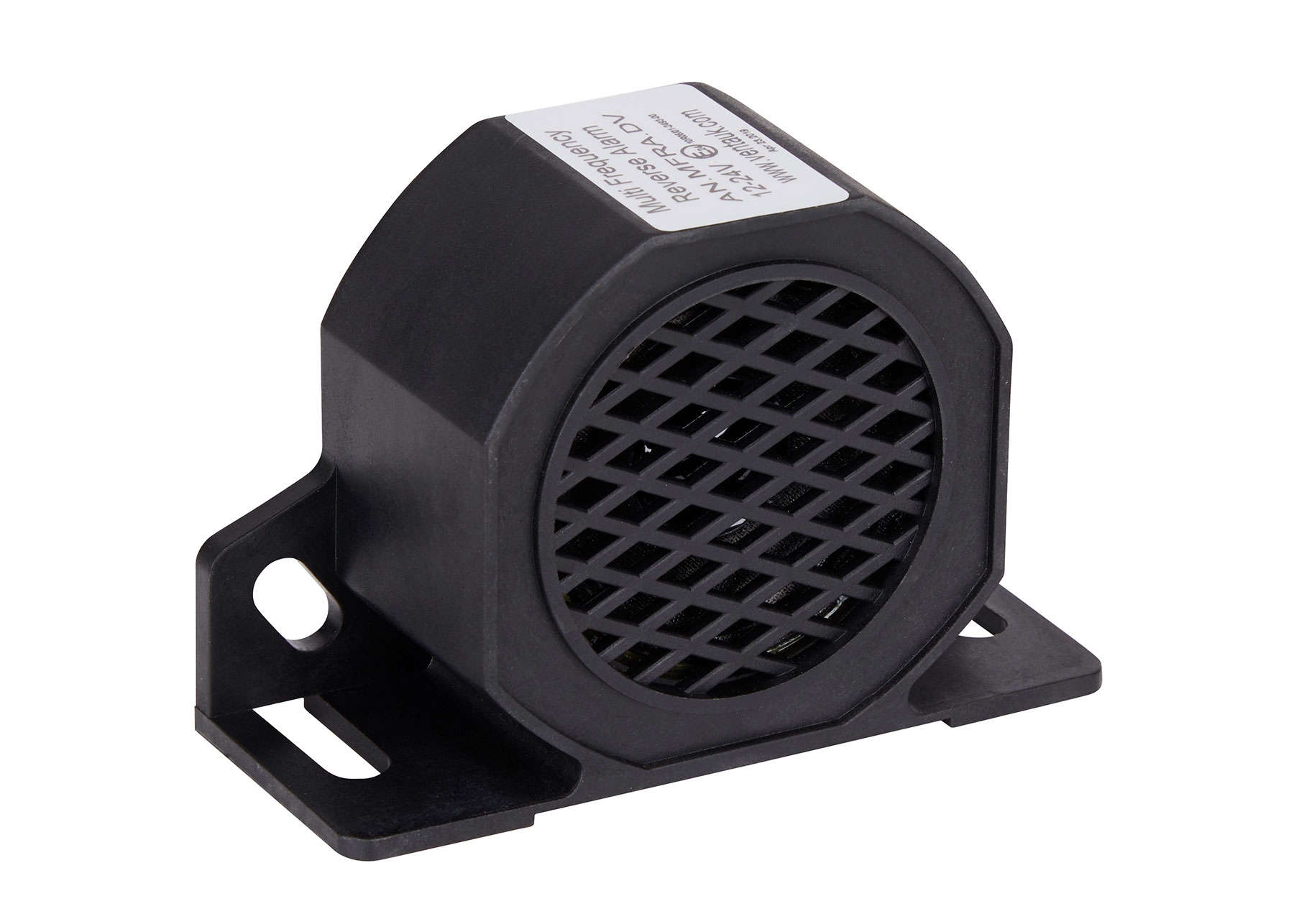

The range gear lever has a Neutral position. That may be an option too. Usually those beepers are located in the rear of the tractor, so I would start there.
Something similar to this:

The speaker is located on the inside of the rear left fender (as you sit in it). It’s mounted to the underside of the cab and looks very similar to the photo above. It’s behind a black rubber flap that hangs down about 8 inches. It’s about 2”x2”. If you trace the wires from the speaker they will run to a group of 4-6 other wires that all come together where they plug into the wires that run to the rest of the tractor. I was able to just unplug one wire from the speaker to disable it. The best part is if (for some ungodly reason) I ever need to have that speaker active again I can just plug it back in. It would also be 1000% easier to locate if you do not have the backhoe installed.
