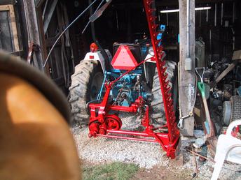

I check Junk Yard every time I go for old implements so far I have picked up a ford 706 Scoop for $20 , Cost about $30 more to recondition it. International back 6' blade for $40 cost about 2 hours work and 3 Lbs of welding rod to fix . Retrived a 14-2 Dearborn mower from my farther-n laws farm , as no one would claim it , Rebuilt it using a side mount that brother-n-law gave me for parts. Have about $80 in it .

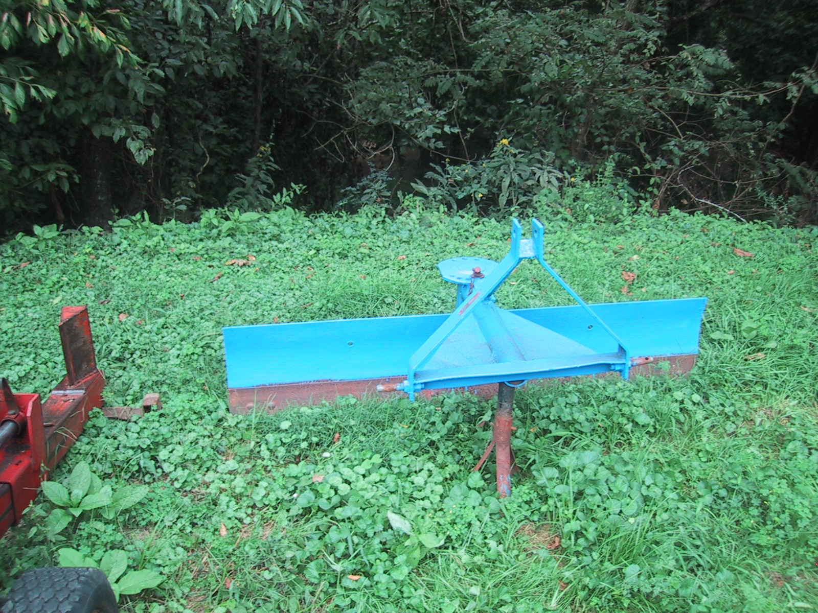

I also made ciopy of the road boss grader,I used 3 inch squae tube and bought two blades from Tractor Supply. Blades are 7 foot long. It is three point hook up with a slot in the top link to allow it to float a bit. It is the best thing I ever saw, short of a big 6 wheel grader. I take care of about a mile of steep mountan road, lots of rock and washes badly after big strms. Have not tried to use it in snow. I pull it with a 30 HP new holland 4x4 and have plenty of power. By it, youll like it. No teeth. R

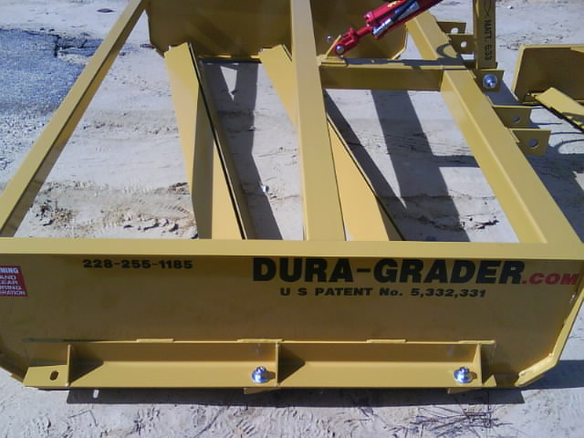

so I did some research on the net and found a the company that invented these types of graders called Dura-Grader. Dura-Grader has a very large selection of different models and sizes some of which are still patented. I purchased an adjustable unit from them at a reasonable price and it worked perfect behind my tractor . With the adjustments I would have had to buy four or more Road Boss units to do the Job of this one Dura-Grader. Also they have been in business for 31 years and stand behind their products with a satisfactory guarantee an a warranty. I strongly recommend this product to anyone looking for a grading implement. here is the Dura-Grader website
