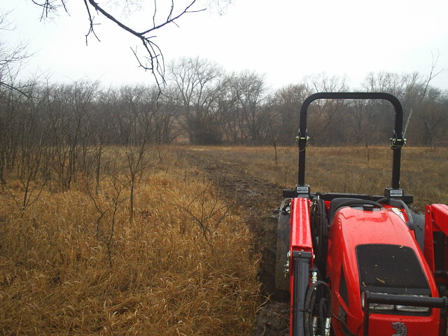

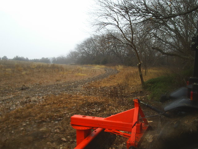

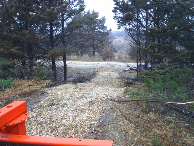

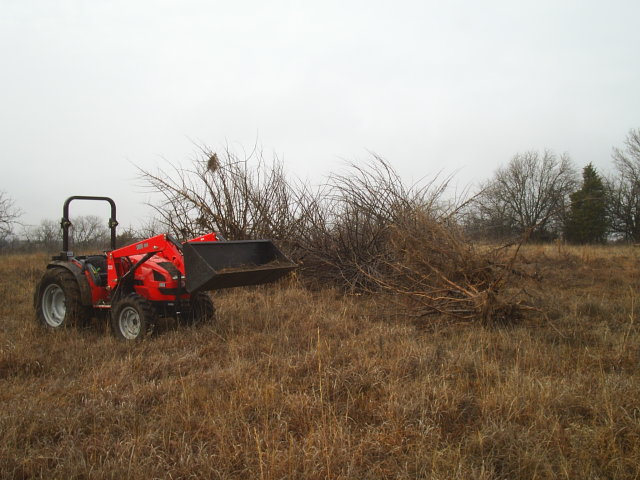

Lots of rain here today.....very muddy.....did manage to rough blade and chainsaw my way the entire 2500 ft

Dave how did you make the ditch for the culvert did you use your box blade with rippers or the front end loader. I need to make a ditch just not sure of a good way to do it ?
   / Road Building
I used a combo of the fel and drag blade plus a little shovel work.....it turned out well as it supported a heavy dump truck already

Drive ways need either money or time! From the looks of your photos, no steep hills or heavey forest. Idealy, you would want to remove all the top soil on your road bed and build up the road bed from the future ditch area. This will create an elevated road with good ditches on both sides. This requires a dozer! Then many tri axels (20 ton loads) of #2 base stone. The #2 is a crushed stone about the size of golf balls to lemons. Go with about 6-8". Then drive it for a few months and top with 4-6 " of 5s an 3s and dust. This stone is grape sized and smaller but with lot's of dust. This settles real well and locks it all together. at 2500 ft x 12 ' wide 1.2 ' deep, you will need 1333 yards of stone. This will cost $10,000 to $13,000. in stone.
Or if you want to save money up front, wait untill July when it's real dry and skip the bull dozer work and just get 4to5 inches # 2. Use a yard box to make your drainage. In dry times keep buying stone. Never have stone delivered in wet conditions. The stone they drive over will be half way to China! Save your fine road building for after you build. Concrete trucks will make you cry
Looks like a fun project.
