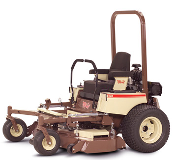

letsroll great job i read the entire post and now i wanna make one just for fun,lol. its great when they publish so many pics of products made for our tractors. I made a grade blade and tooth bar for my kubota bx23 and now i get to do it all over again for the new b3030. tractor work is great around here, seems like no one does it anymore. if you get real serious about it then i suggest you get some insurence, its only 52 bucks a month for 1 million coverage through state farm and worth it for the peace of mind. i quit my full time job to do tractor work because of that little bx23 and now ive bought a new tractor and ztr mower to do lawns. just like you im having the time of my life and making money doing it.
what demensions would you suggest for my b3030? the outside width of the tread is 54 inches. how long and how wide and how far apart ar those blades?

Same here about tractor work. Everybody and there brother is mowing commercially. I tried it for awhile, but I was getting underbid real bad and decided to keep my full time job. My mower is a zero turn grasshopper. Pretty much I just mow my own yard (2.5 acres) right now. Allot of commercial rigs place a bid and later on down the road, they raise there price/rates (seen it to many times). Thought about trying that route but decided against it for the time being. But I will be making a carrier change here in the next year or two. Just got to get some frying pans cleaned out first before I go out on my own. Tractor work around here is slim, but that will probably be the route I take with a little mowing on the side. As for the demensions on my road grader. Front to rear= 5ft, side to side= 7ft and height= 18inchs. The blades are 2.5 feet apart. First one is in the middle and the back one is in the back. As for your tractor, I'd make it the width of your back tires plus 6 inches. 5 foot blades would work real well with your tractor. Sides, I'd go with 12 to 18 inchs. Length, I go with 4 foot. The cuting edges is what really make these graders the cats meow. By the way, your ztr mower is a nice set up. I just wish I'd bought a diesel mower instead of gas. If you dont mind me asking, what are the diesel Kubota's going for these days(like the one you own ZD326)? I might just trade mine in since I dont owe a penny on it.
