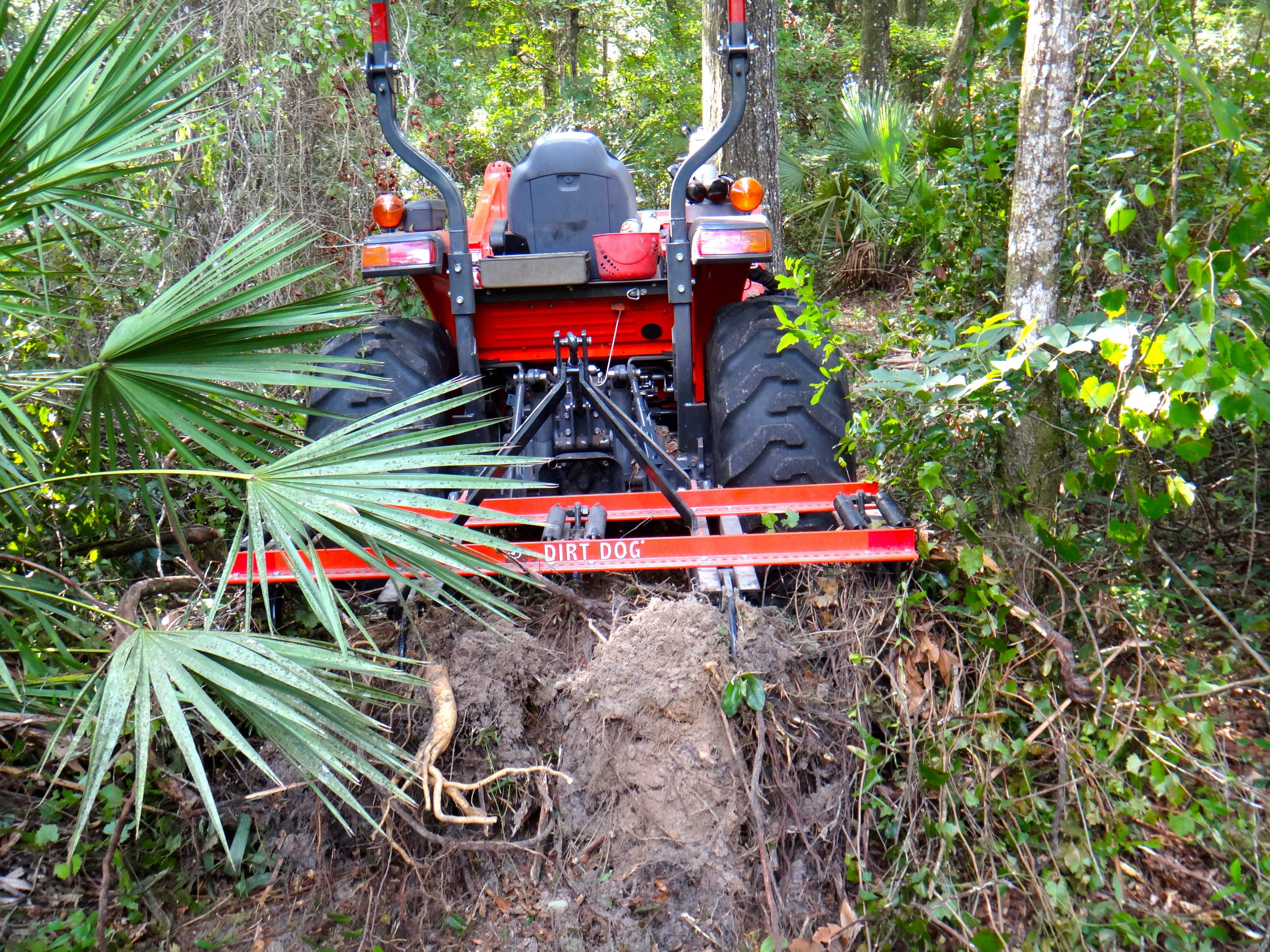

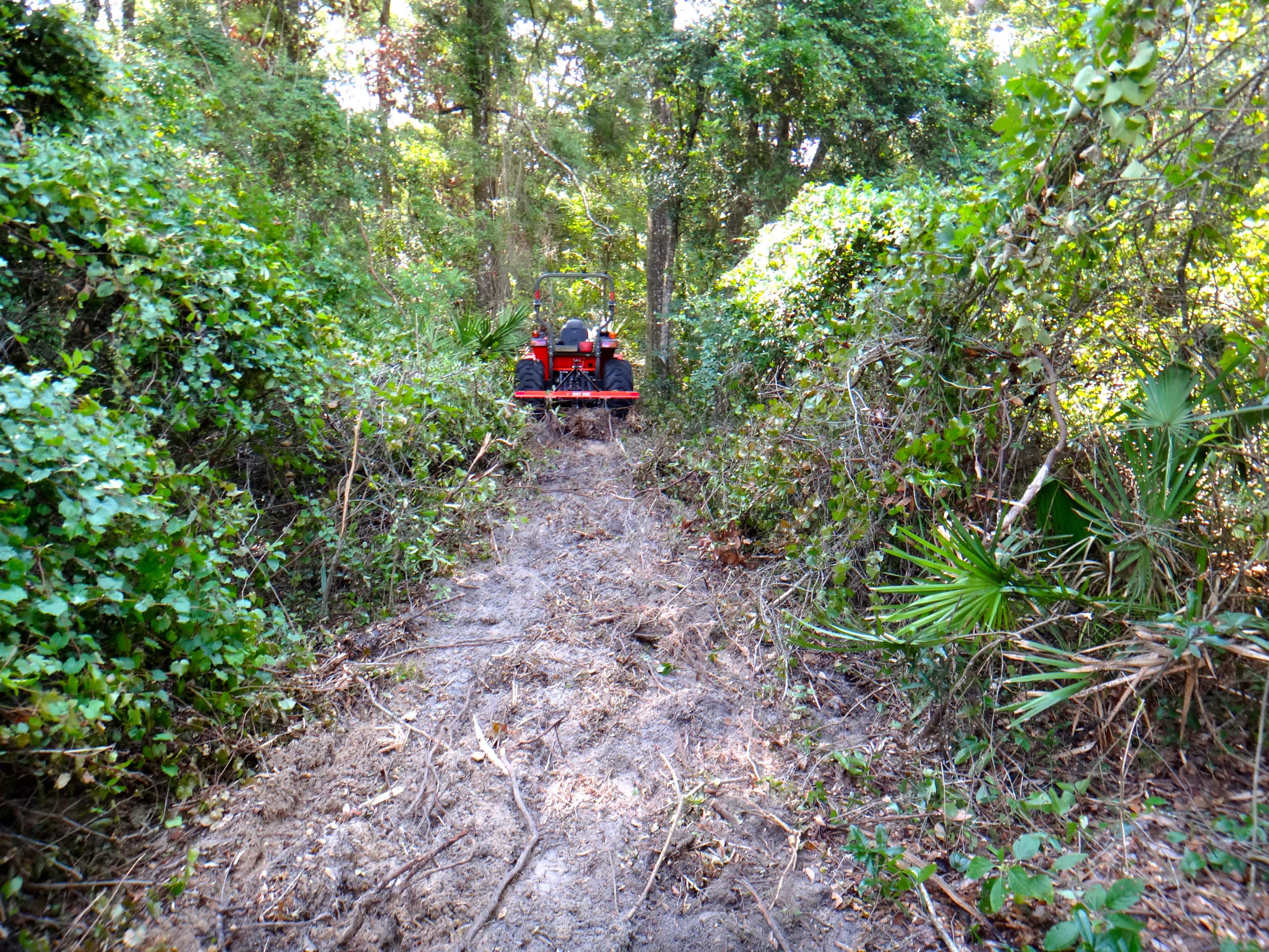

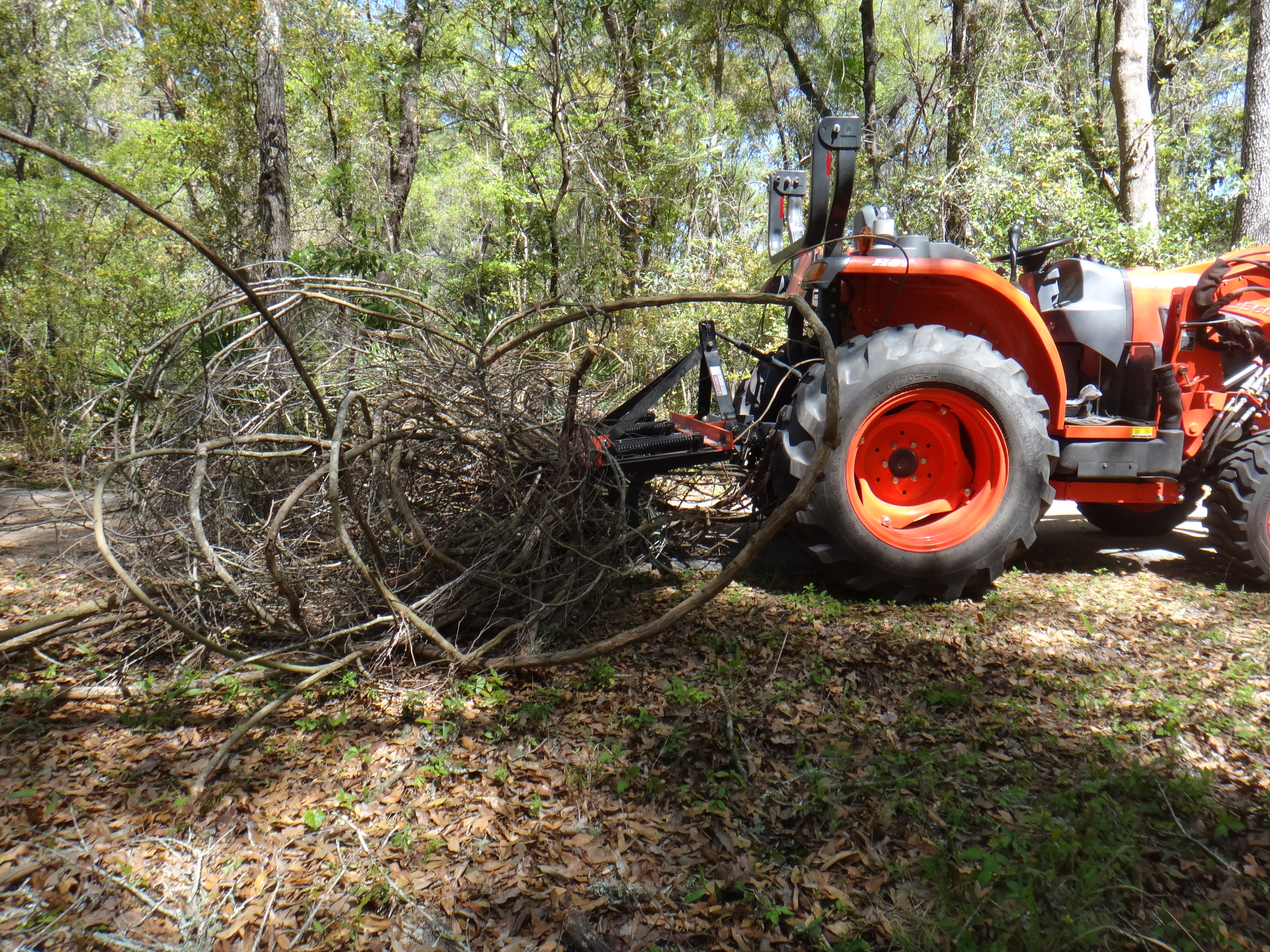

I use a Ratchet Rake attachment on my bucket, paired with a Landscape Rake with gauge wheels, mounted on the Three Point Hitch, for maintenance.
During construction I used a <$900 Dirt Dog (brand) All Purpose Plow, more generally known as a Field Cultivator, for softwood root removal, including Yaupon Holly, grape vines and rose corms. My soil, like yours, is mostly sand. I used a Box Blade some.
Gordon's Brush Killer, sold by TSC, will kill Yaupon Holly in one, sometimes two sprays, timed four to six weeks apart.
