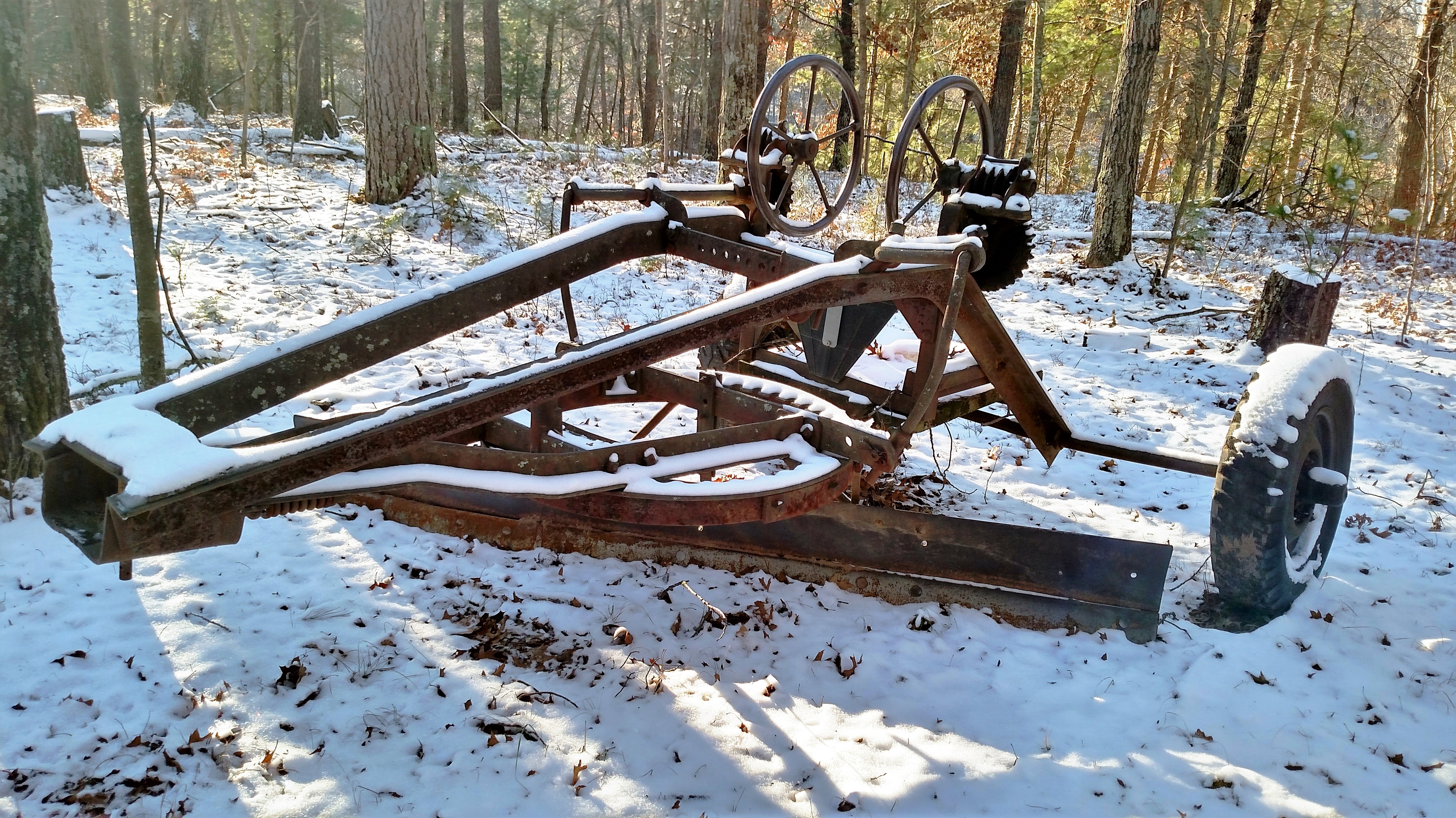

I maintain 1/2 mile of road. I have a rear blade and a box blade, but here are my weapons of choice ...

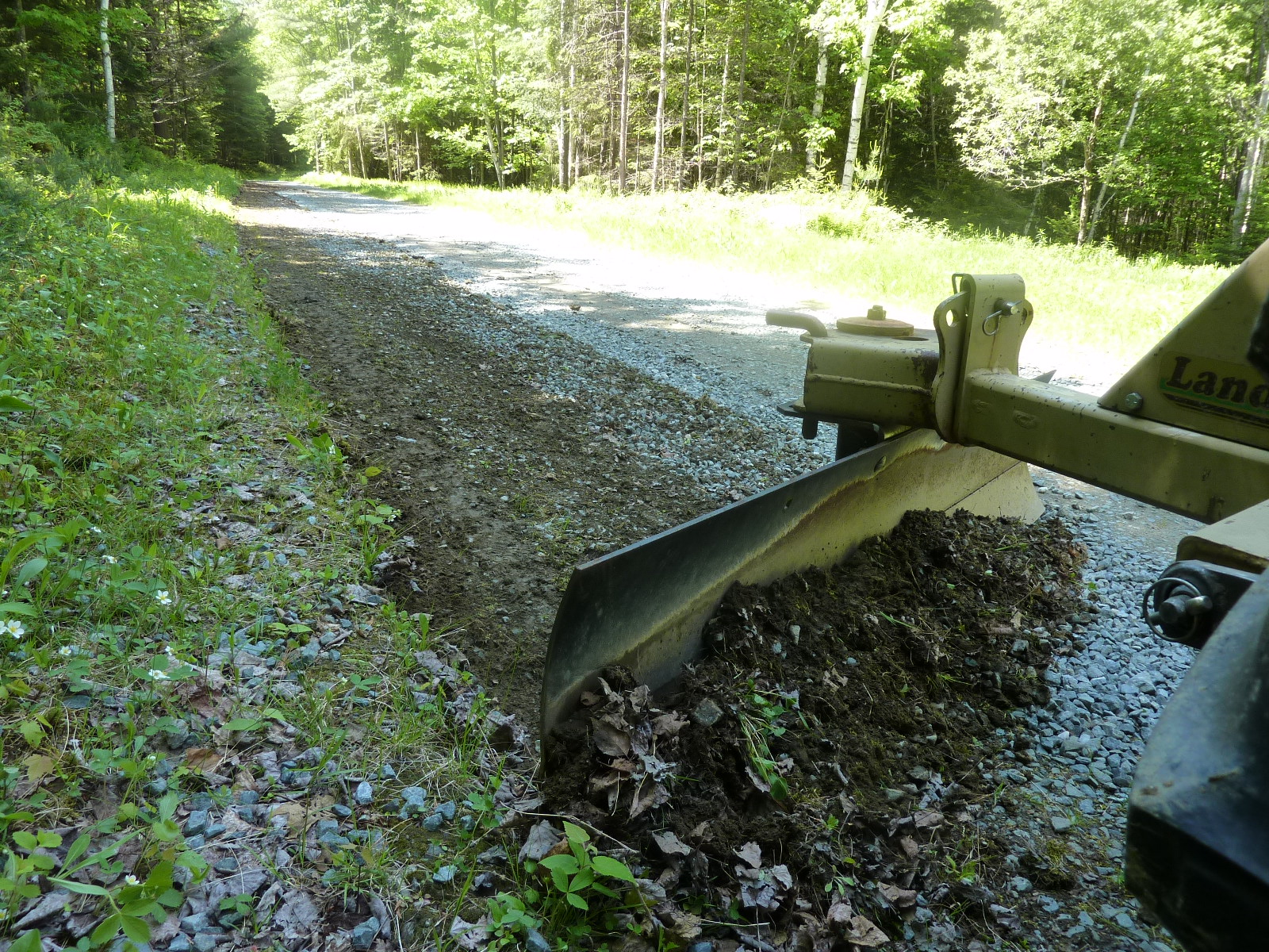

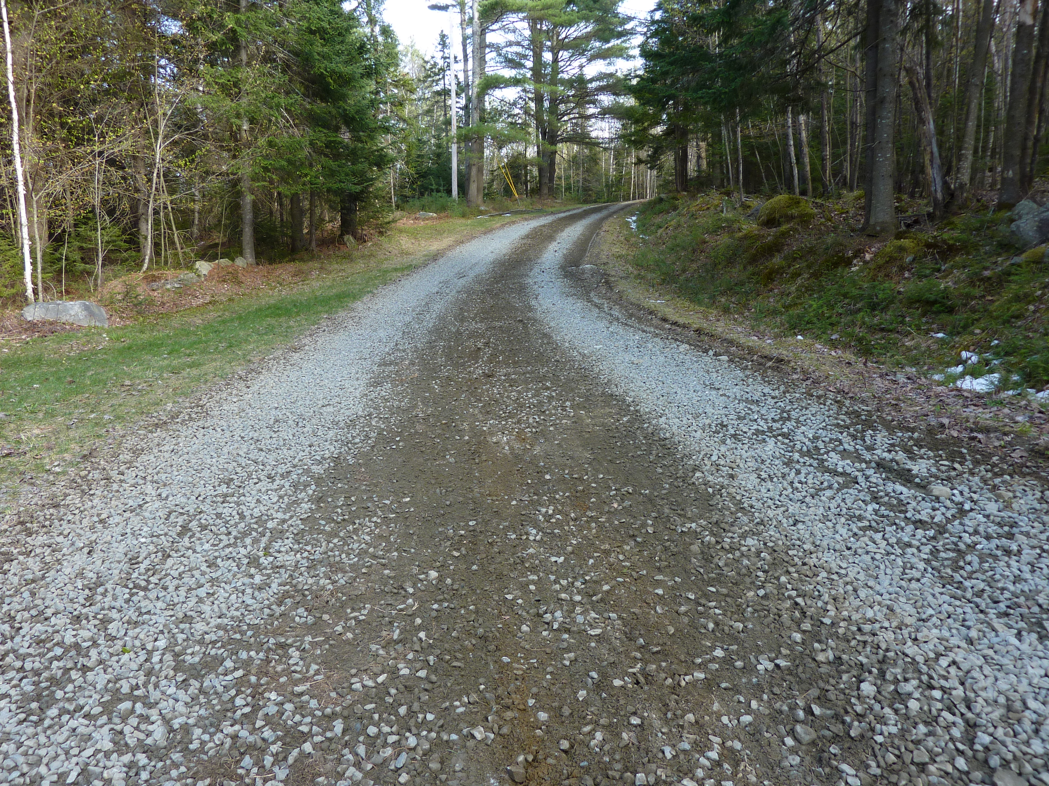

I bought a 6' Land Pride rear blade. And for the first 10 years that is all I had or needed. No TnT or anything else. When the first mud season came I would back in and dump 3/4" stone into the very worst spots that I couldn't drive thru with the p/u and spread it with the bucket and blade. As the frost came out and things started to get a little firmer but still muddy I started filling the ruts with 3/4" stone and leveling with the tractor. After 2 years of doing this we could drive my wife's car in during mud season instead of leaving it at the end. And after about 4 or 5 years it was a solid year-round road just by continuing the same process. The mixture of 3/4" stone and dirt gets very solid.
You learn to use the blade pretty fast. You can't make the road worse so what the hey. After ten years when I thought I was pretty good with a blade I bought TnT and that made it easier and faster to grade and then I built a Land Plane Grading Scraper and that has become my main tool now that the road is really established. I only use the blade to recrown when necessary. Here is what the stone and dirt road looks like before and after grading in 2010 when I first built the LPGS. There is not crown there it just has a flat pitch to the left so water drains to the down hill side.

A couple more pics of stone and dirt road. Slight recrown with the blade then gilding the lily with the LPGS.

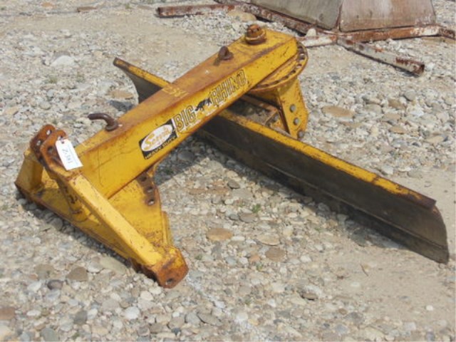

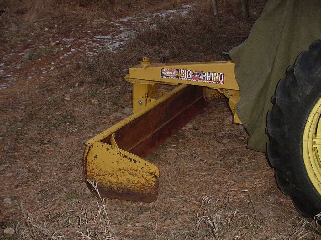

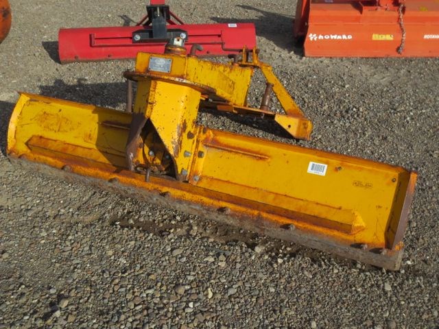

You don't have to choose between a box blade or grading blade. What you need is a grading blade that has removeable end caps so that it works just like a box blade with the added advantage that it can be angled. So one implement can do both jobs.
Inexpensive simple grader and box blades are so common that a lot of tractor people don't even know about the better options.
It's all in the implement. You alread have more than a good enough tractor, so now if you get a blade with three movements: Tilt, Offset, and Angle... and it has removeable end caps.... then you can work that road like a pro.
On the gravel, I ask for 1"minus crushed roadbase material with the fines left in (unwashed). That gives me a sharp but small stone that interlocks well because the fines (the dust) in left on the crushed rocks. When you say "roadbase" you are specifying a compactible material. Usually made by combining about 5% to 10% clay into the crushed stone above.
