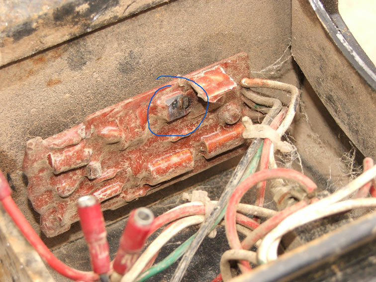

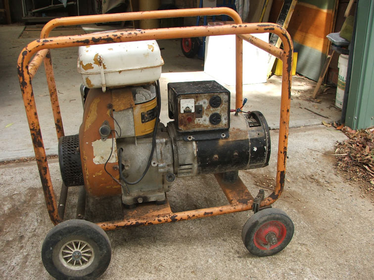

Hello all. I picked up this Robin 2KVA / 240volt Generator for $50. The Robin 4 stroke engine starts and runs quite well but its not providing any electricity. (I was told before purchase that it didn't work). I think it has a 'Waikin' generator but I can't find any info on that brand.
How can I test this thing to see if its repairable? First step I guess is to see if the gen is producing any raw juice. The generator has four wires running from the 'dynamo' (is that what its called?) to the control box. Red, black, white and green. Other than getting one of the kids to stick his tongue on these wires how do a test to see if they are 'live'.
Step two I suppose is to see if the control box is usable. Pic 2 shows the inside of the control box (upside down). Apart from dust and cobwebs its pretty tidy except for the obvious burnt or broken part on the circuit board thats encased in plastic. Does anyone know what that bit does and whether it can be repaired? (Or does the whole board need replacing).
This is a bit of a 'project'. I won't be shattered if I cant fix it but I'd love to get it working again. Any help would be appreciated.

Flashing the field probably won't do much good with that burnt component on the regulator board. There is only those 4 wires between generator housing and box? I would have expected 5 or 6(two hots, neutral and maybe a ground, as well as the 2 leadsto feed the field winding). That burnt board is most likley the voltage regulator. It takes a little of the generated power and sends it back to the rotating field via the aformentioned brushes or a separate induction coil. The amount sent back, controls the amount of voltage generated. IF that part is smoked, you might have a hard time finding just what that part is to replace, and what caused it to fail also. And as voltage regulators go, it would probably cost as much for that regulator board, if you can find it, as for a newer replacement generator...
Good Luck
/ Robin Generator - No power #10
I agree with Ron. Sorry, didn't look at the pics or read the post thoroughly. Flashing probably wont help. I have a perfectly "good" gas powered ac-dc welding machine that has a circuit board fried like that. They want 1000 bucks for a new board. Makes you sorry you bought it in the first place.
/ Robin Generator - No power #11
Oops me neither:( And I agree flashing isn't gonna help.
/ Robin Generator - No power #12
Yep.. looks like a popped transistor.. or regulator or diode in a to-220 package..
If'n ya could find a schematic, ya might be able to get that component from mauser/MCM and desolder it after chipping it out, assuming there are no other faults and it was just a component failure.. if it was a cheap component.. I'd risk it at this point..

The component you are trying to ID looks to have had the front of it's case blown off.. unfortunately, that is where it's ID info would have been. A schematic / parts list would be of great help here. as I said.. could be a diode, transistor, ets, in that package..e tc.
Quite honestly, i wouldn't invest a dime in doing anything else unless I got the regulator board part first... why go to the trouble of checking / changing brushes if the regualtor is a lost cause... kinda like pulling a car out of a junkyard and changing all the tires and wheel bearings before you try to get the motor unstuck and running.

I said it would be like an archealogical dig and it was! Heres the 'find'.
Before I take it to the 'generator shop' and get laughed at does anyone want to hazard a guess what it is?
I had no idea what a to-220 was so i had to look it up.
TO220 - Wikipedia, the free encyclopedia.
(P.S. Why do so-called experts always think the obvious answer to anything is to buy a new one for a $2000 instead if spending a few cents trying to fix the old one?)
WOW..Thumbnails!. Thats new!!!
/ Robin Generator - No power #20
The component on the right is a $2 transistor it could be a voltage regulator or a rectifier you will buy from Tandy or Jaycar . But what caused it to blow ? If your lucky the generator was overloaded and that may be all that is wrong with it . Can you see a partial number on it ?
