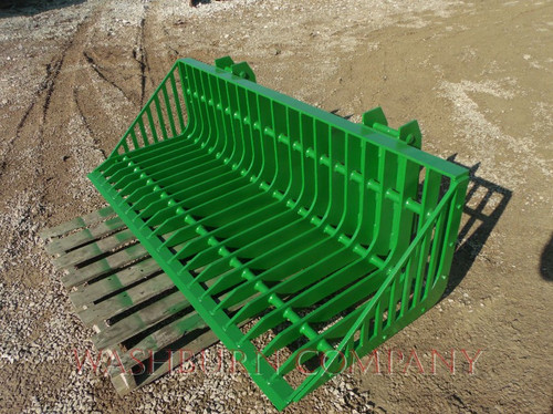

BTW - that rock bucket that TugBarge shows ( link ) is a fine looking implement.
