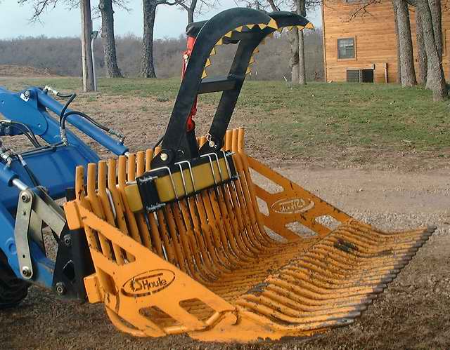

The 55" Bradco rock bucket from E-A seems a superb choice in my estimation. I've owned a 60" rock bucket for years and never ever wanted it to be wider. Several times I've actually wished it was only 48" wide because of uneven ground while picking up rocks and trying to get them into one corner of the bucket. I do prefer longer tines than the Bradco bucket, but with longer tines, you need them bigger and stronger so they won't bend. To me the Bradco design looks like the best of several designs I've seen. I especially like the way the they've incorporated the SS quick-tach into the structure. That adaptation reduces overall weight and yet retains a high amount of strength for very heavy loads. Give the choice of my S-Houle bucket and Bradco, I'd have a tough decision on which one I like best. Because my tractor can lift the heavier bucket, I do really like the digging ability of my longer tines. Bear in mind that longer tines reduce breakout force also. I find my rock bucket is ideal for popping large rocks out of the ground that are in the 100 to 200 lb range. Those are very tough to handle with a regular bucket and by hand they are an all-day job. The rock bucket pulls/picks them with ease and sheds the loose soil around them. Here's my bucket with thumb grapple.
I think the option of a thumb grapple on rock buckets would make them very flexible for many things besides digging rocks. The rock bucket is not ideal as a grapple because it has sides to the bucket. That limits the bite you can get on brush, but as you can see in the photo below, I still can haul a respectible amount of brush in my rock bucket/grapple, making it a true dual use attachment.
