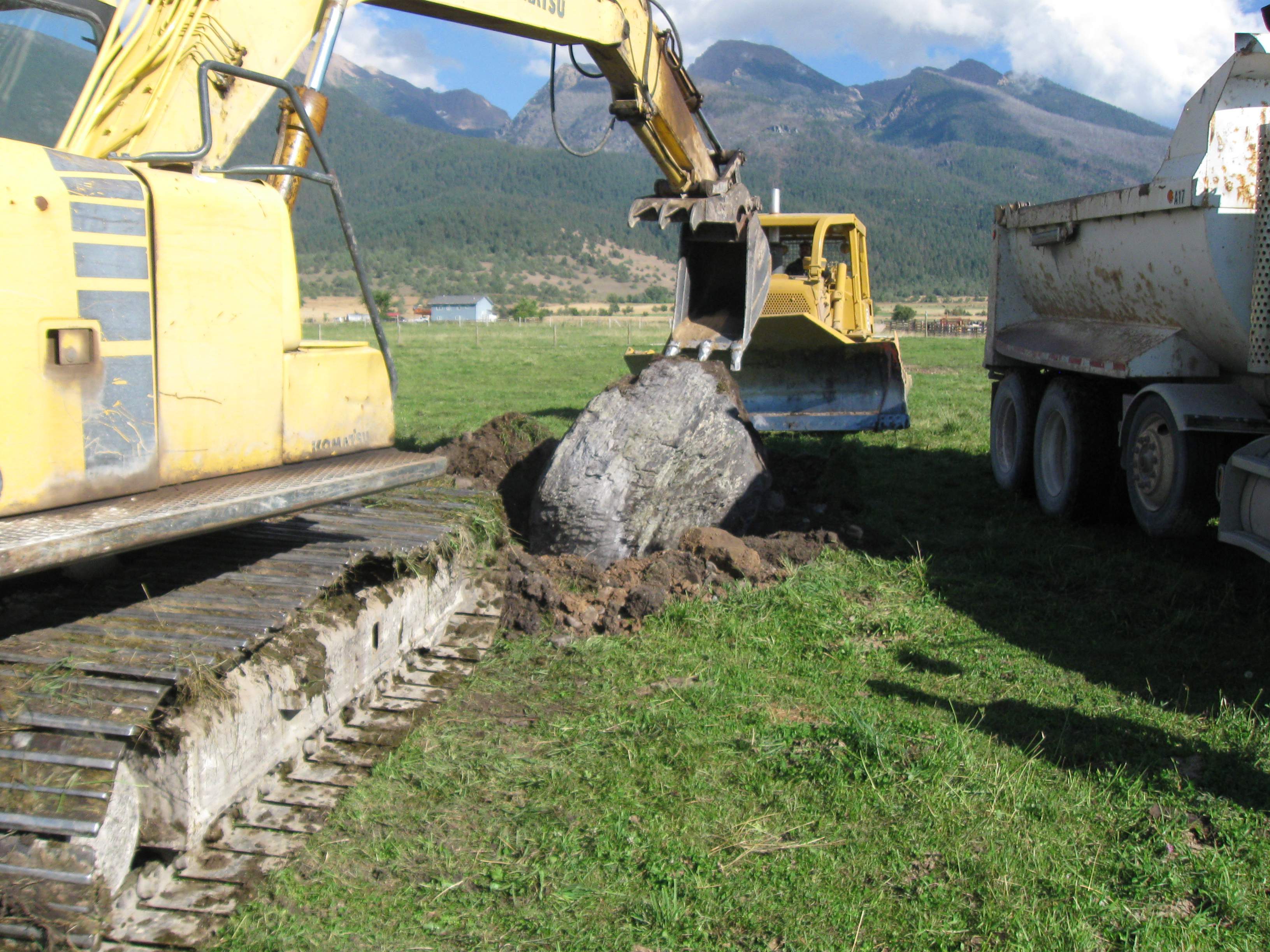

I live at what was once the bottom of Glacial Lake Missoula and our ranch is loaded with great topsoil that it studded with rock fragments from the size of a Volkswagen on down. These fragments were torn from the Mission mountains by huge glciers during ancient ice ages and were floated out over the lake when these glaciers "calved" and were deposited by melting or by the repeated draining of the lake during the cataclysmic floods that formed the chaneled scablands of Eastern Washington.
The picture below gives you an idea of the medium size rocks we have to deal with. This one is too big for the trackhoe to pick up so a hole was dug that would put the upper surface of this rock three feet below grade and then it was pushed into the hole. Not easily seen in this picture is the the small rock fragments, 10 inches or less. Anything less than about 3-4 inches we don't deal with on the large scale. These small rock fragments are generally hand picked and removed in gardens and flower beds but in the pasteiures 3-4 inch rocks are rolled down after seeding.
We are reclaiming an old pond, ~100 ft in diameter, and if were not covered by 5-6 inches of fresh snow I'd show the rocks we have there. After disking the area three times, I handpicked the 1 foot to 2-1/2 ft rocks and carried them to the ditch with the loader, one of our rock "storage" locations. Next, I used our Ferguson TO-30 and a 5 ft landscape rake (that I reinforced!) and windrowed the rocks. I only broke three tine bolts! (IF I had a rock bucket, this is when I would use it to scoop the windrows to remove the rocks. They are not designed to grub rocks out of the ground.) I will then use the rake to make small piles of thes windrows that I can scoop up with a loader bucket. we will then seed the area, put hot wire fence around it to keep the cows out and have a neighbor roll the remaining rocks down.

Gotta know, was the excavators thumb able to hold the ROCK while it was put in the truck?
/ Rock buckets #7
No that's why he's burying it! We had about four of them that had to be buried. Too big to pick up. the cat was able to move some toward the ditch or a fence line.
