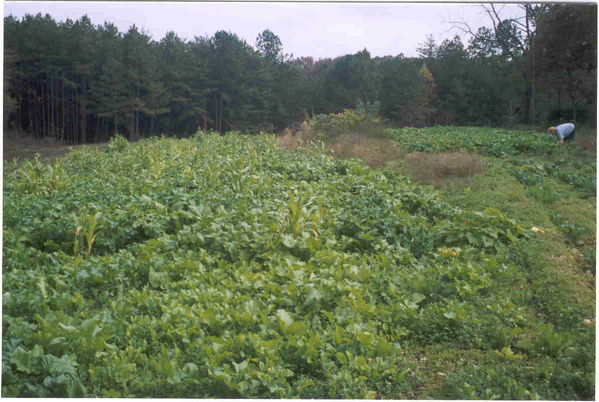

Thats an interesting approach. My garden is about 2 acres though, sounds like it may take awhile. I thought I might just turn about half of it into pasture so it might make it a little easier. I grew some 41/2 lb. turnips in those rocks a couple years ago but man they are brutal on my Woods tiller.
