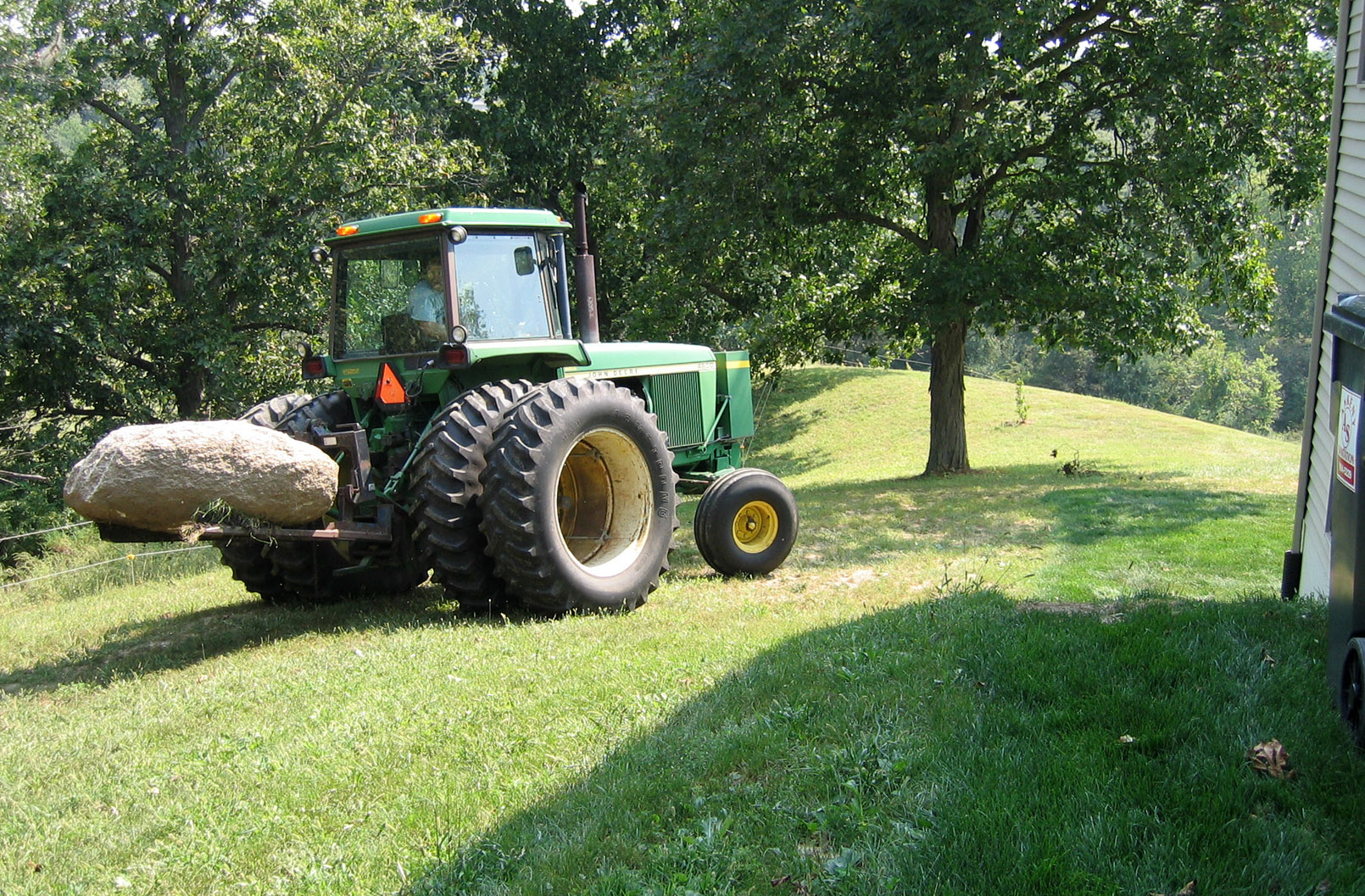

I think moving rocks is all relative in size.... This one kept pulling the front end up, so the entire move was in reverse...
IowaAndy

#27

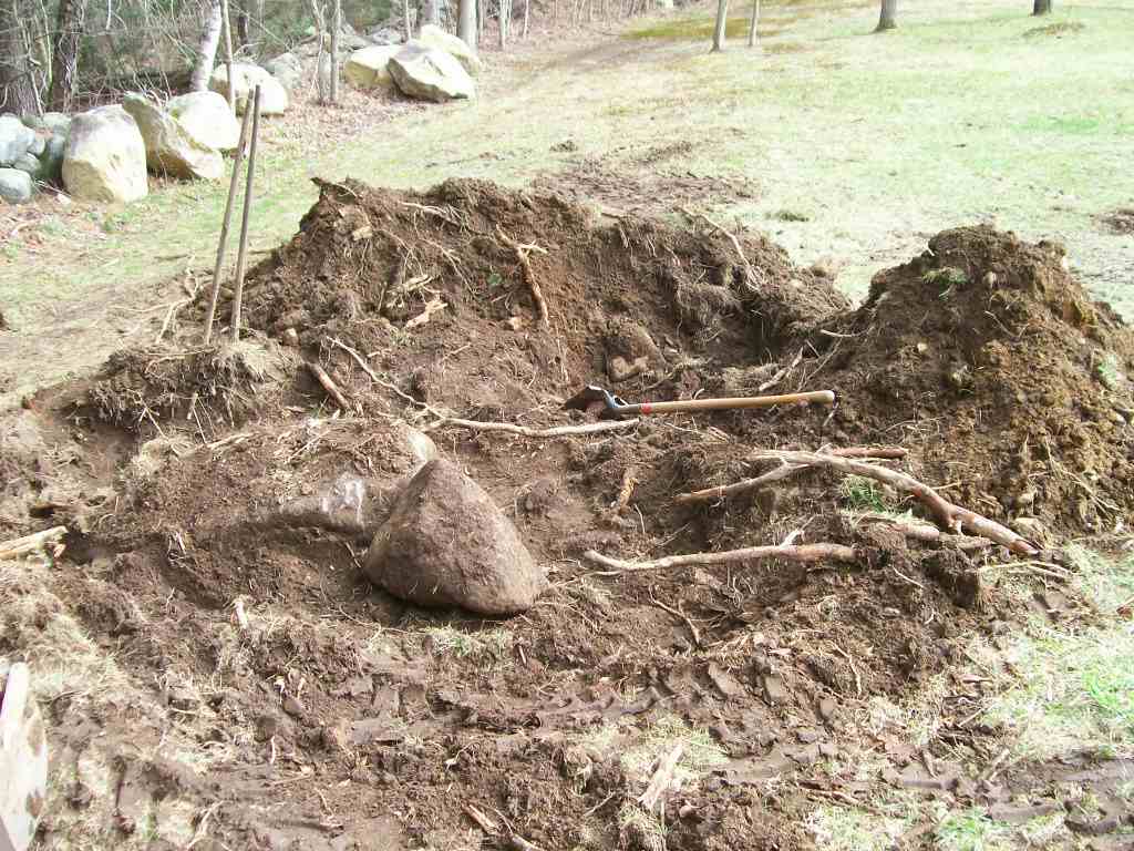

arrow said:
This is a job at my daughter's house that was going well until I hit this rock which was just a little bitty thing when a tooth scraped into it. I had to dig around the rock to budge it. No matter how I tried, the bucket would not even curl this thing. I am doubting if anyone makes a tractor in the 25-32 hp range that would of picked up his stone. If granite weighs 200# per cu. ft. I estimate this stone at 1400-1600 Ibs. If I didn't roll it , it was going no where.
The last picture shows the completed job that without teeth, wasn't happening.
