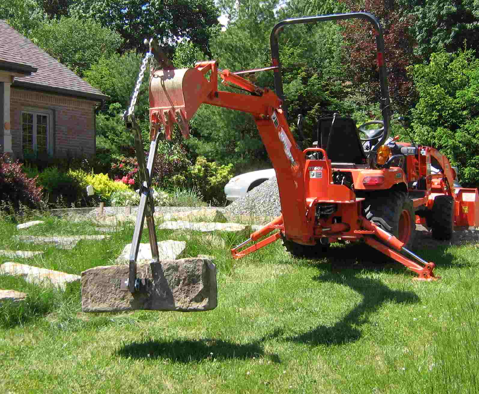

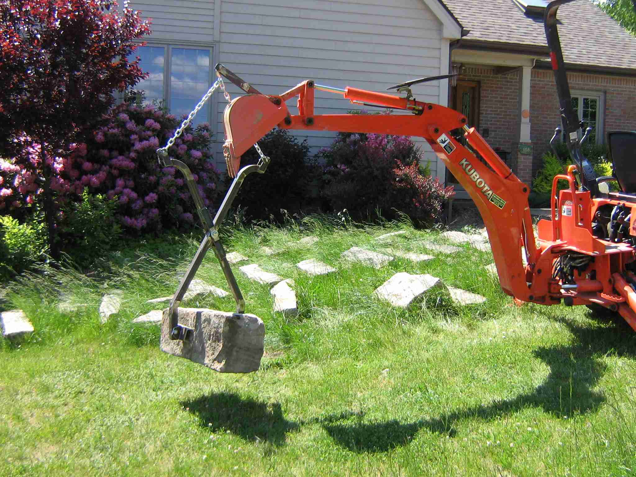

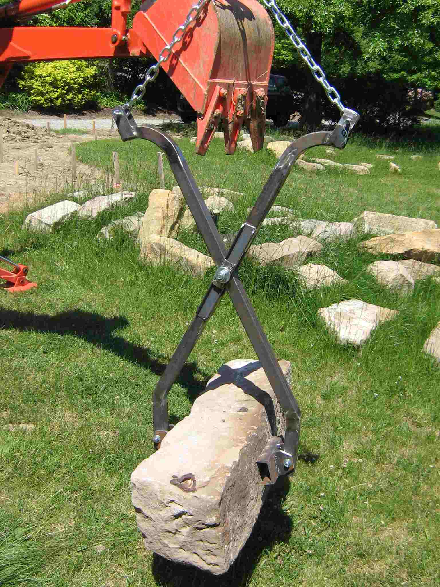

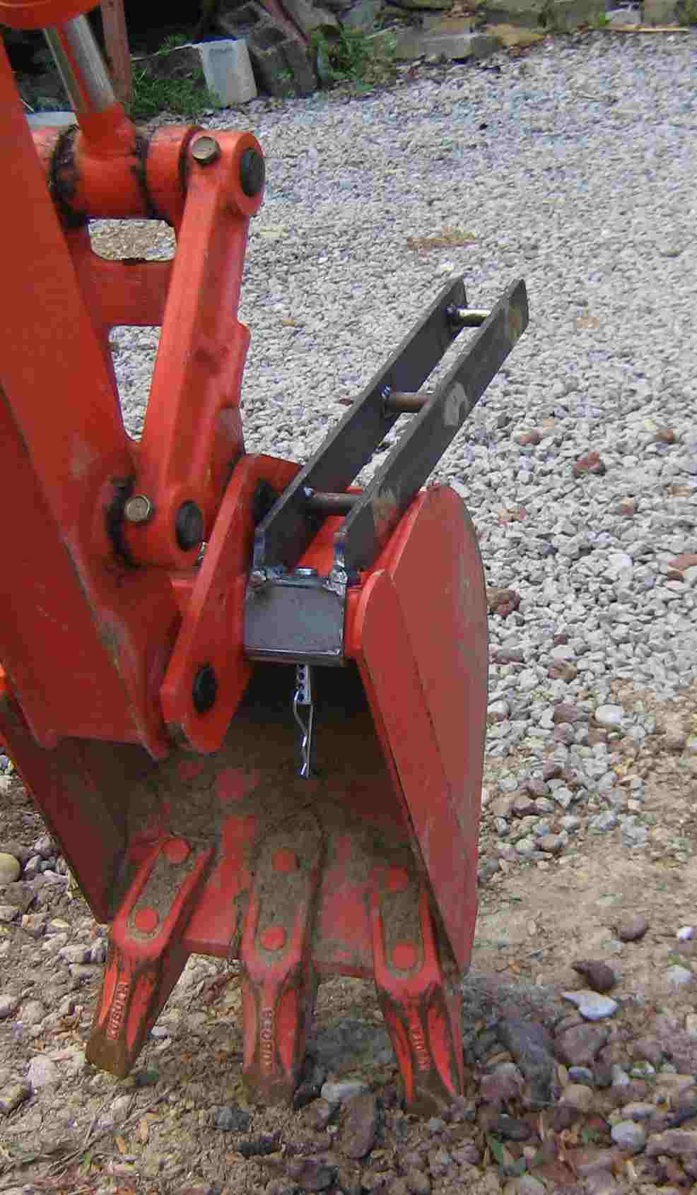

   / Rock Jaws #60
Here's a few images from the stone tongs that I made. The stone in the photo is probably around 300 to 400 pounds. It lifted the tractor front end off of the ground until I put the stabilizers down.
