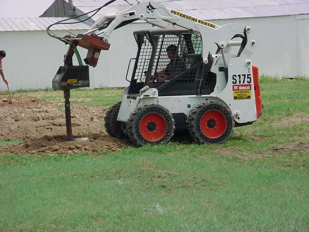

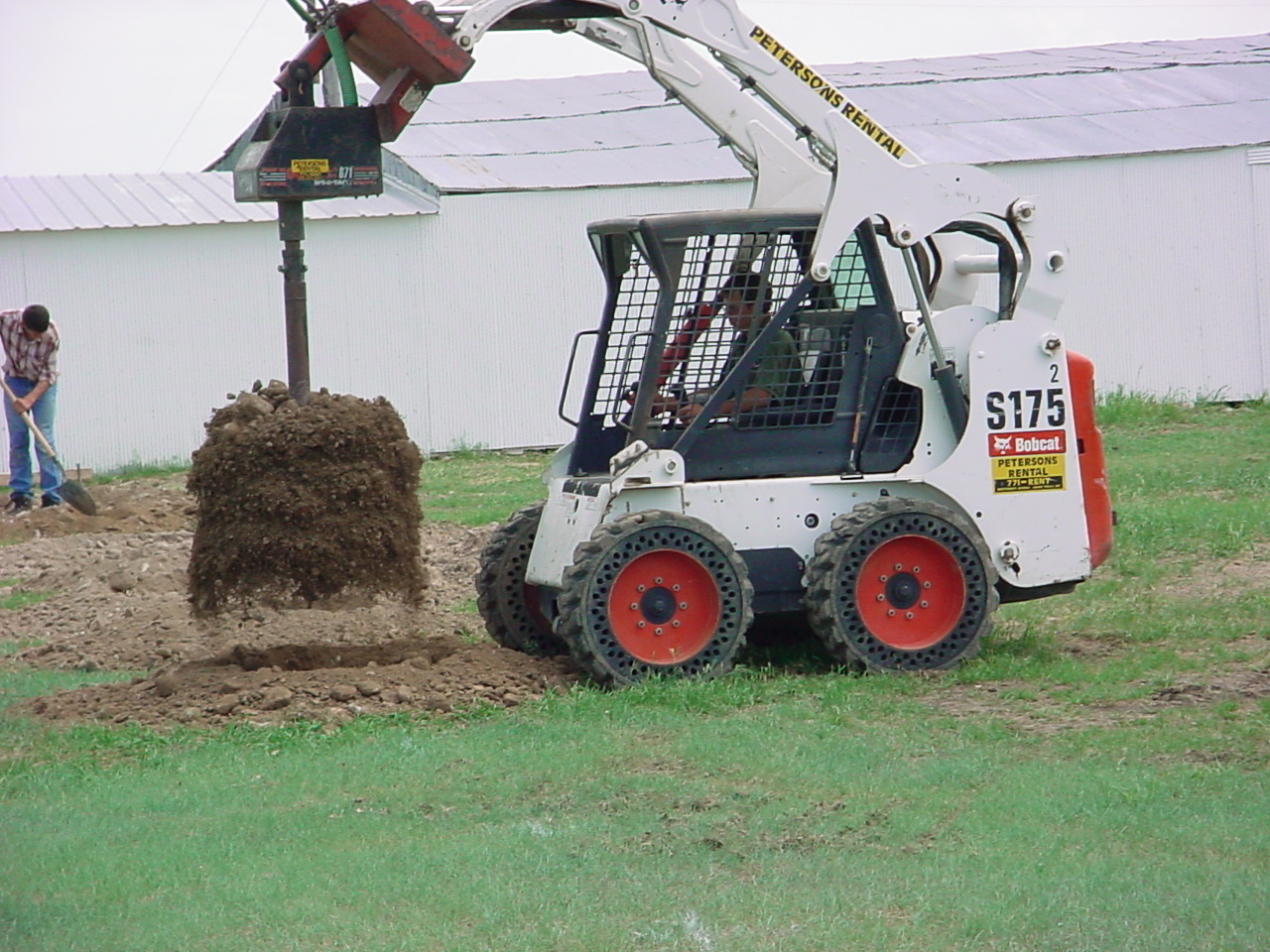

They use them here but down pressure is what's needed. A good skidsteer in combination with the auger will get the job done in rocky environments. I know this works because I have had holes dug for both post's and my poles for my barn.
My place is very rocky, Here's a couple of pictures of the Bobcat / Auger combo used for digging our holes for the pole barn on my place:
