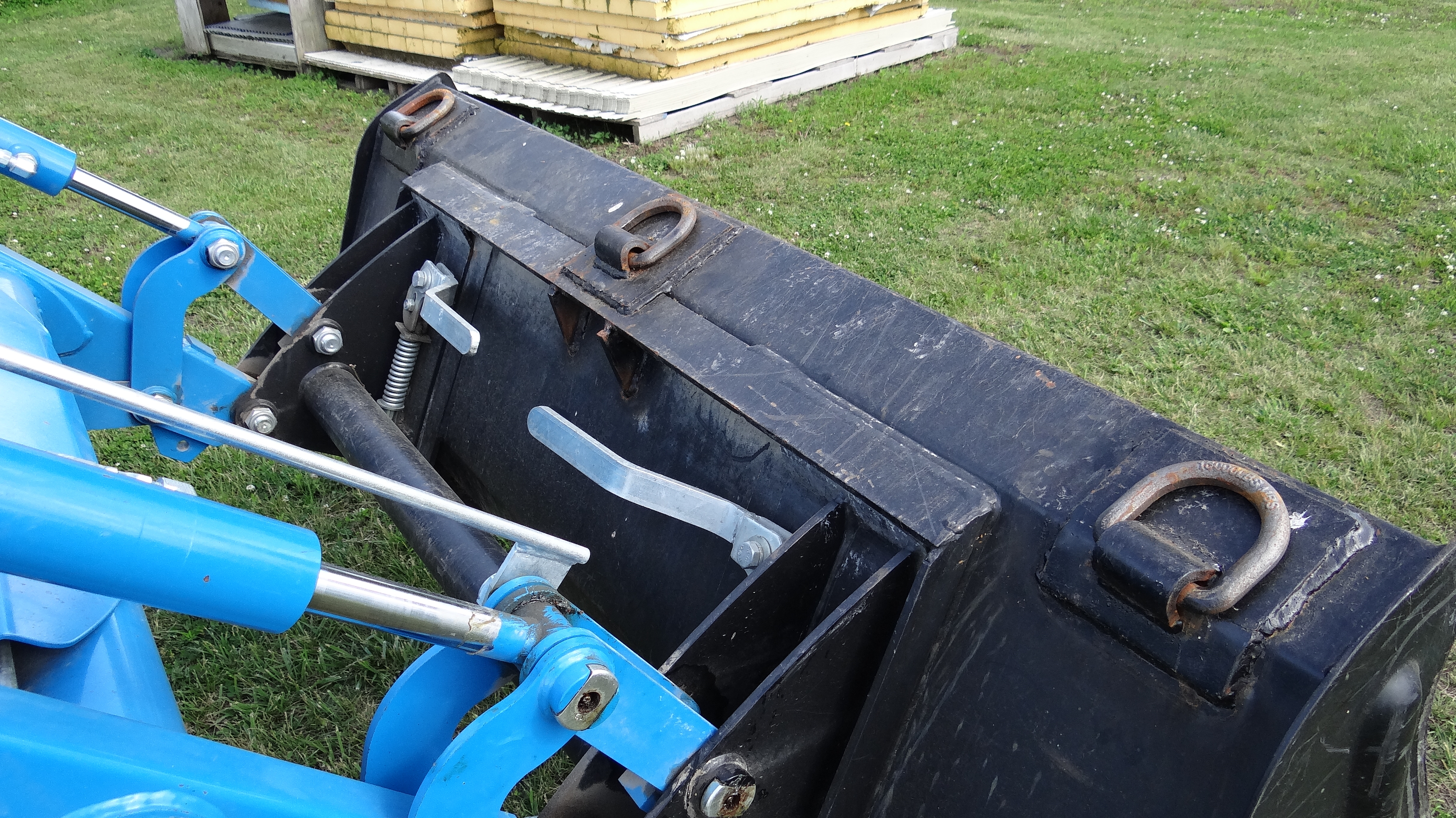

What does everyone think of welding a larger piece of plate onto the bucket first before welding the hook on, to try to spread the stress? My neighbor has a bucket that broke where the hook was welded on . Split it back about 8 inches . PS I'm not a welder.

The hook was more than likely undersized and welded too hot making the parent metal brittle.
Depending on the bucket it can be a good idea. On my Branson I welded a piece of 2" square tube the length of the top edge then installed the hooks.
I have two slip hooks over the loader arms and grab hooks on each end of the bucket.

Thats what I did on mine to spread the stress out. A hot root pass of 1/8" 6013 chip and brush and then several passes of 1/8" 7018 on top of that. Been holding up for years now and will pick up the back of the tractor
