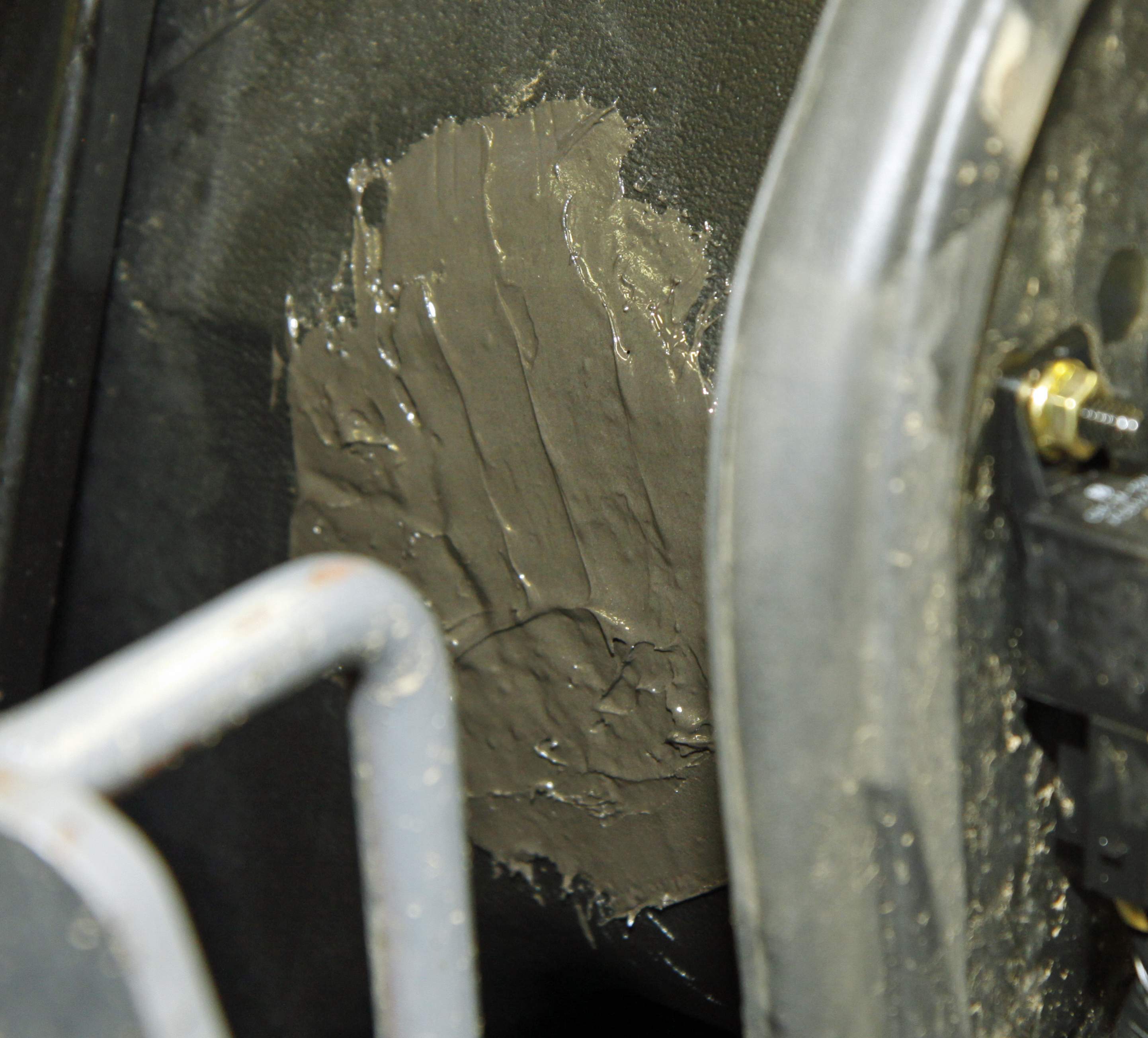

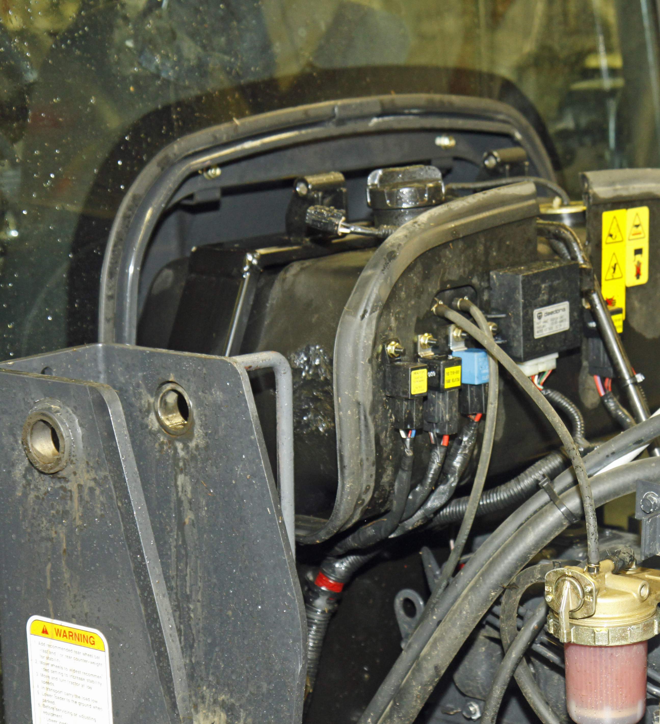

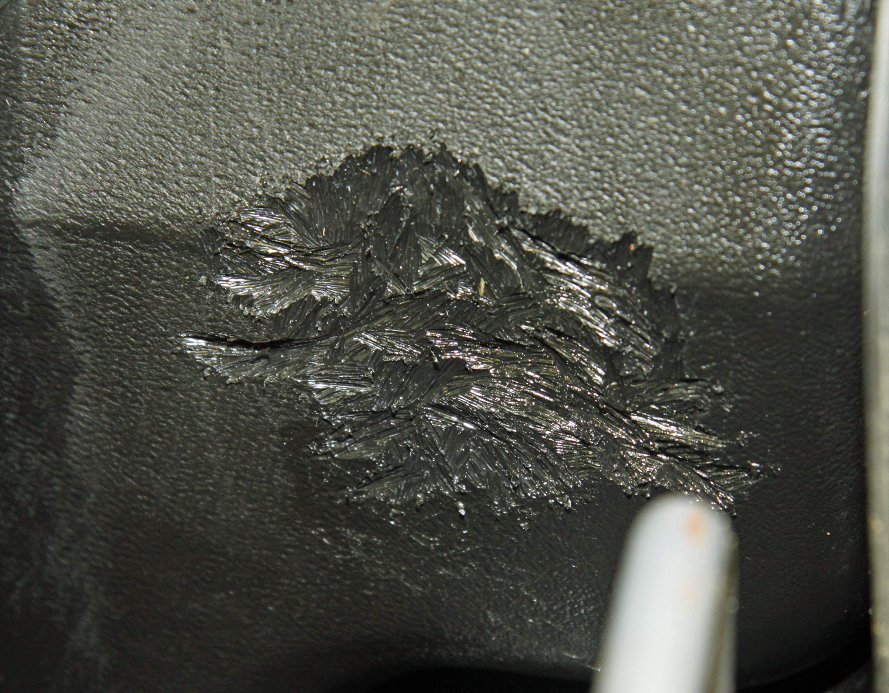

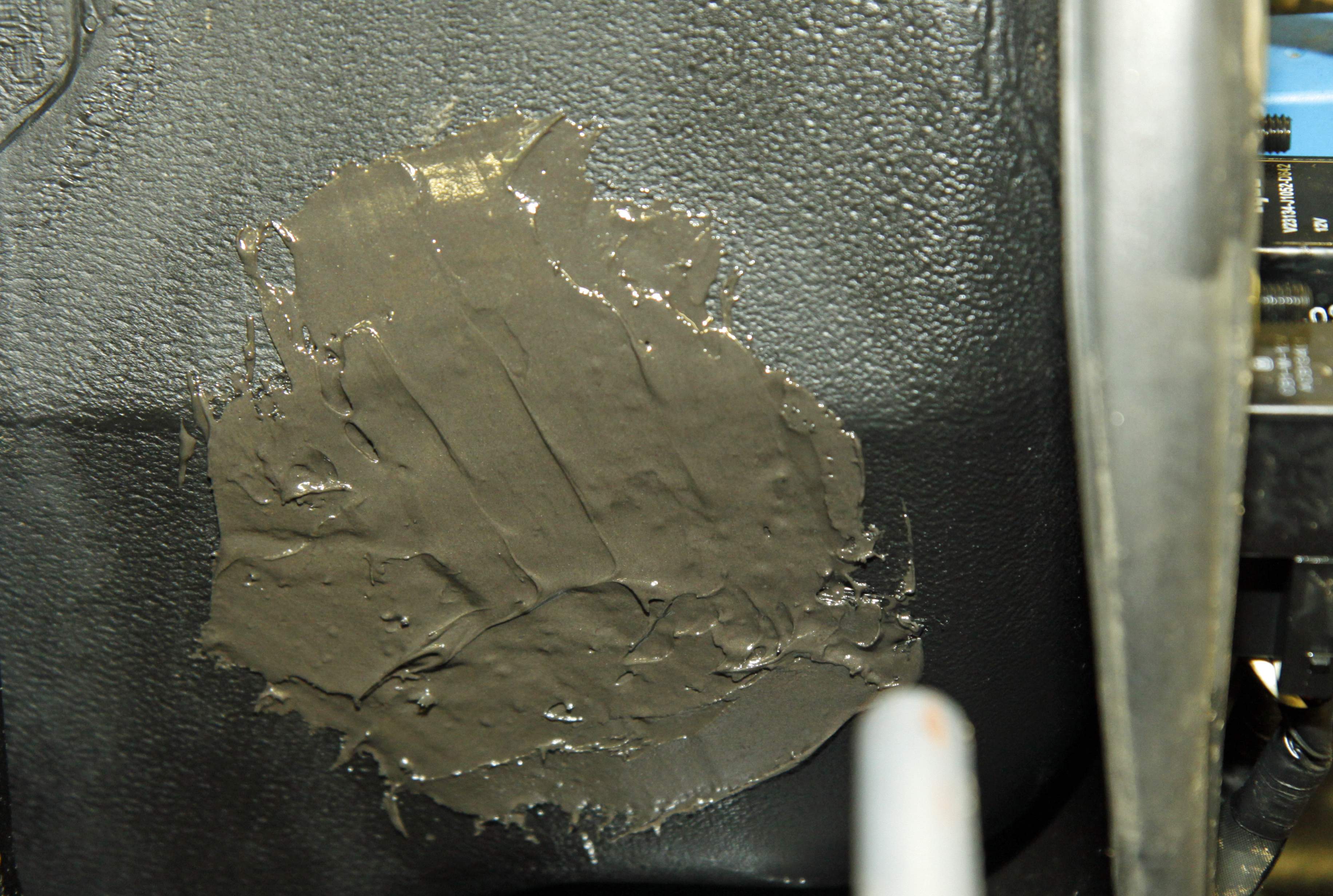

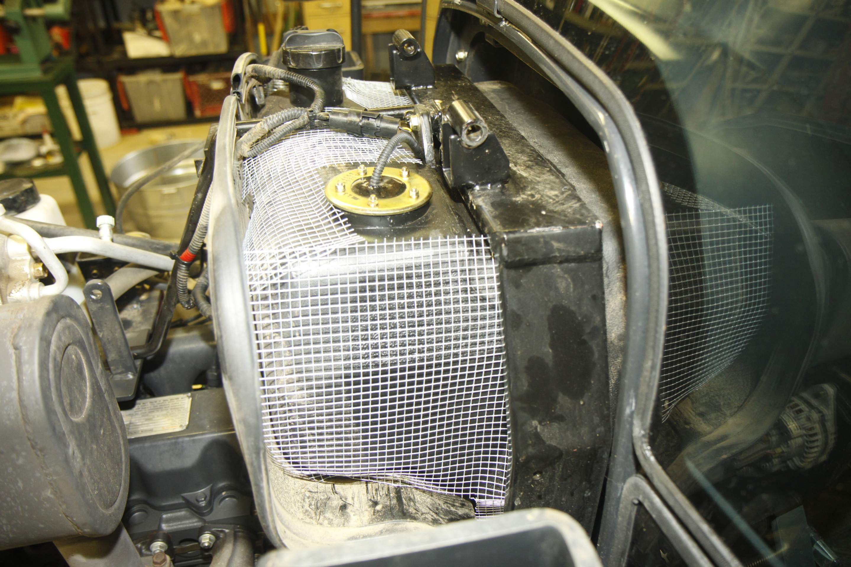

OK, today i took the loader off, and removed all panels and hood to get a better look. After power washing and degreasing the mess left behind, i cleaned and applied the 15 minute JB weld in several stages.
There was more damage than i originally thought. i hope that this method works, cause i can see how hard removal of fuel tank will be. I am now going to attach some metal mesh screens to try and keep critters out in the future. ill take some pics of this if it works out. Ive ordered a new fuel tank. my dealer is giving me a deal....no shipping charges. anything helps at this time.
heres the damage and repair to date

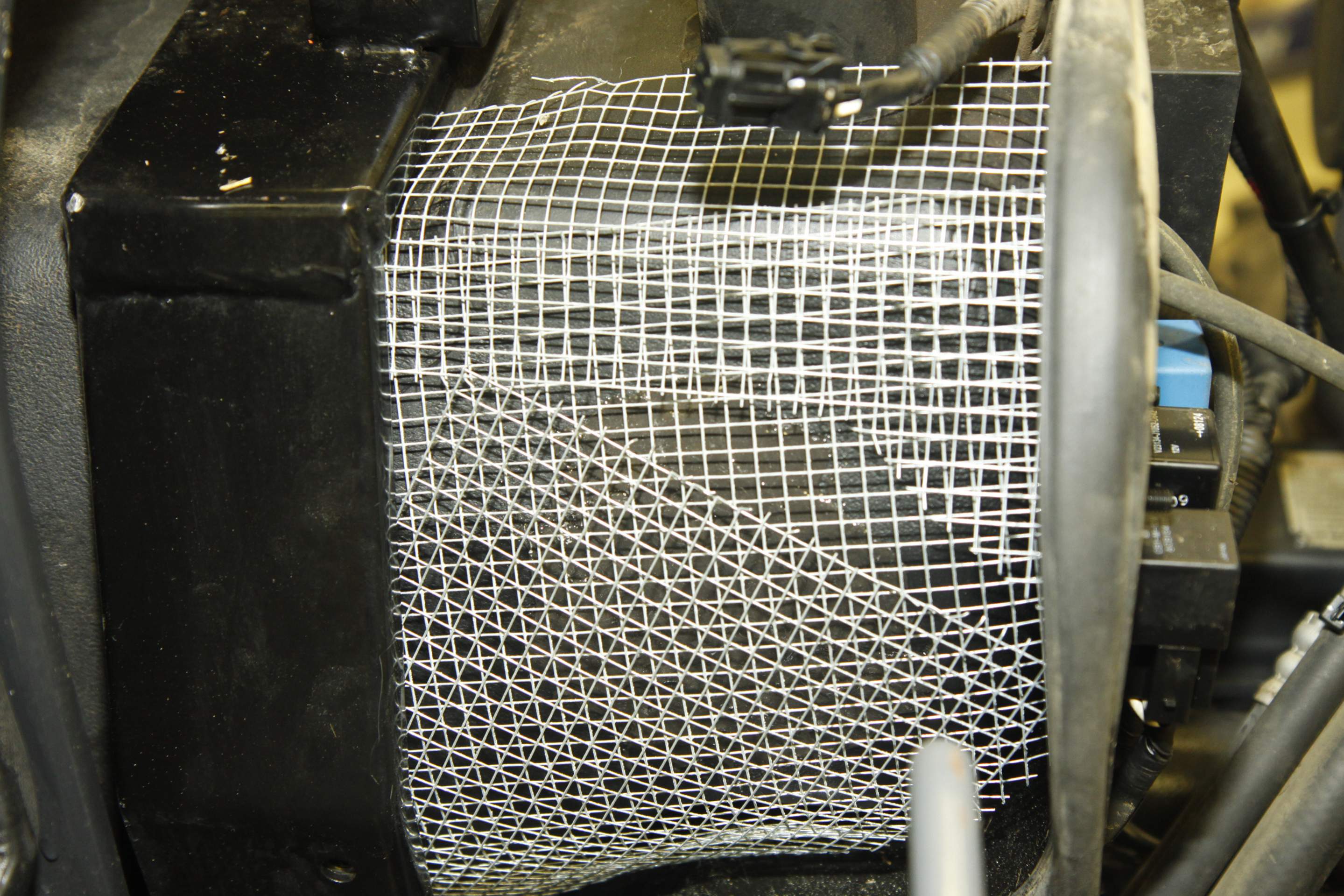

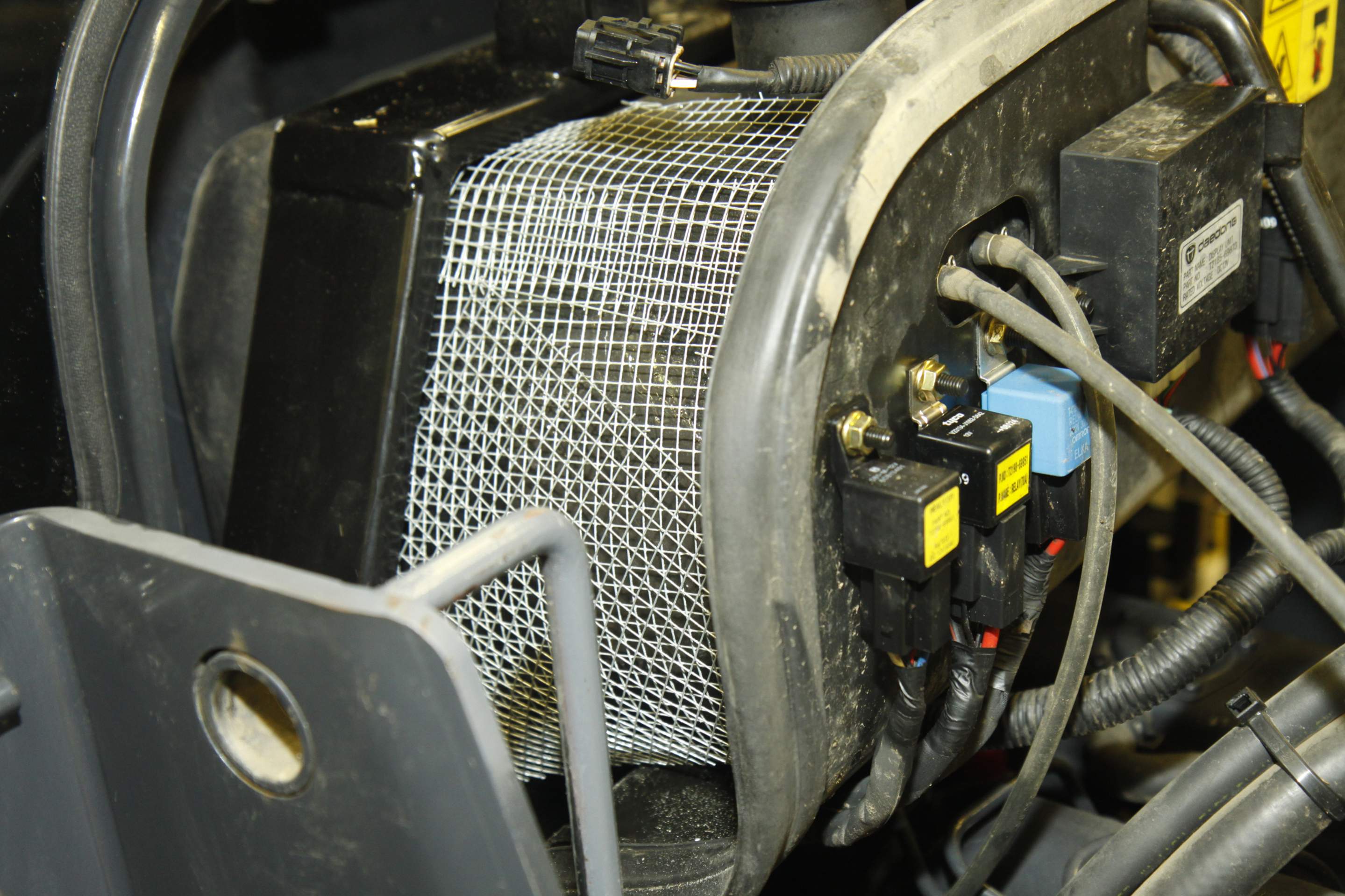

now, i added some 1/4" mesh screen to try and stop a repeat performance from said rodent. that, and ill check it every time i check oil from now on. who knew they would build a nest there and eat plastic.
Anyways, heres a few pics.

Just be careful that the screen doesn't chafe on the tank...

shouldnt move at all....really set in tight. the tank is really pretty thick. must have taken some time for rodent to chew thru it.
Ill probably swap out tank for the new one later this year...when i have some down time.

Teeth marks look too big for rodent of the mouse type, might have been a coon or a big rat.
   / rodent chewed hole in fuel tank DK45HST.....death to all rodents #39
Might have been a squirrel, they chewed into the siding on my house with just about that size hole. Screen wire stopped them. I would save the wire and put it on the new tank if you ever replace it just to be safe.

im thinking squirrel myself. I will defiantly reuse screen on new tank also.
ill be filling this tank and checking if it leaks later today. sure hope it holds
