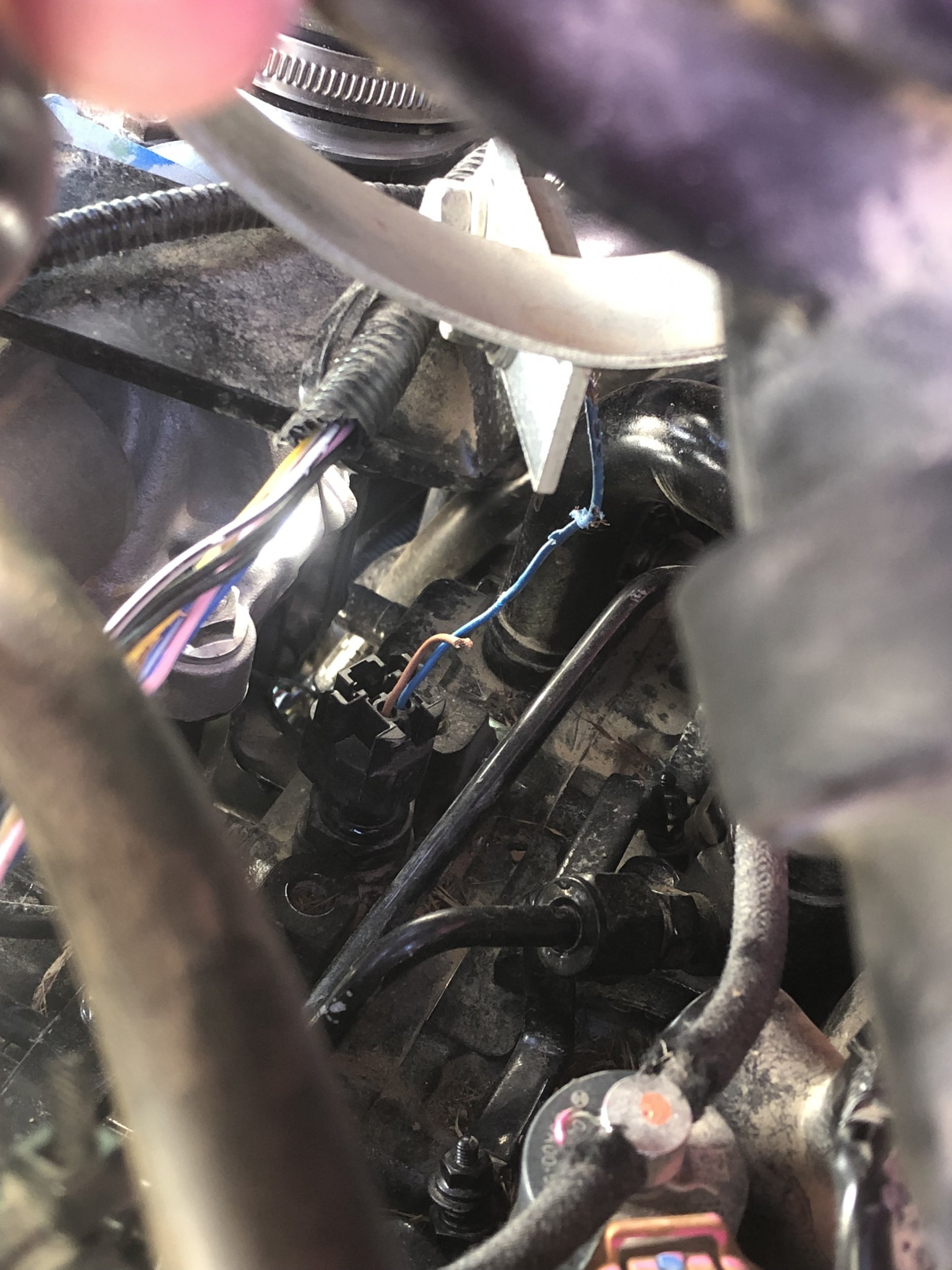

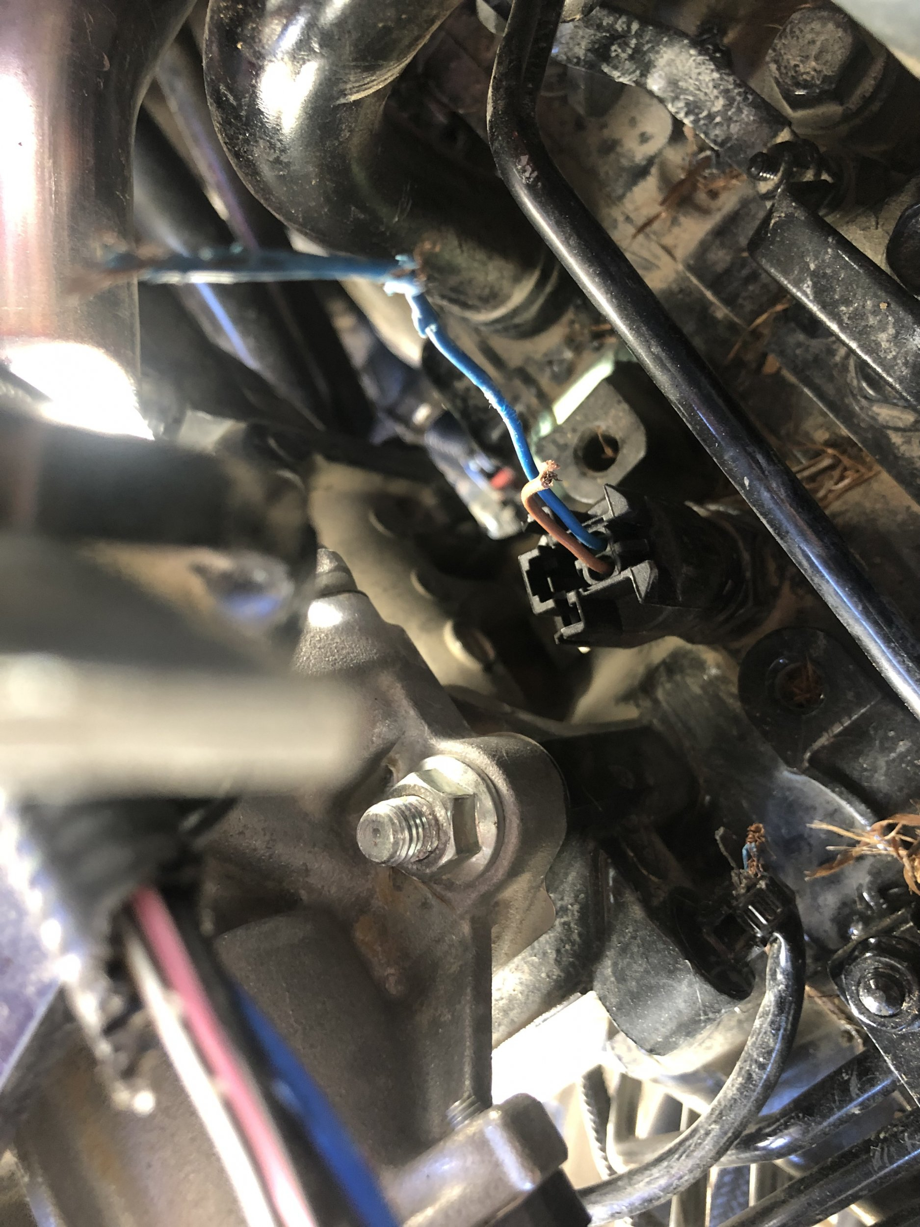

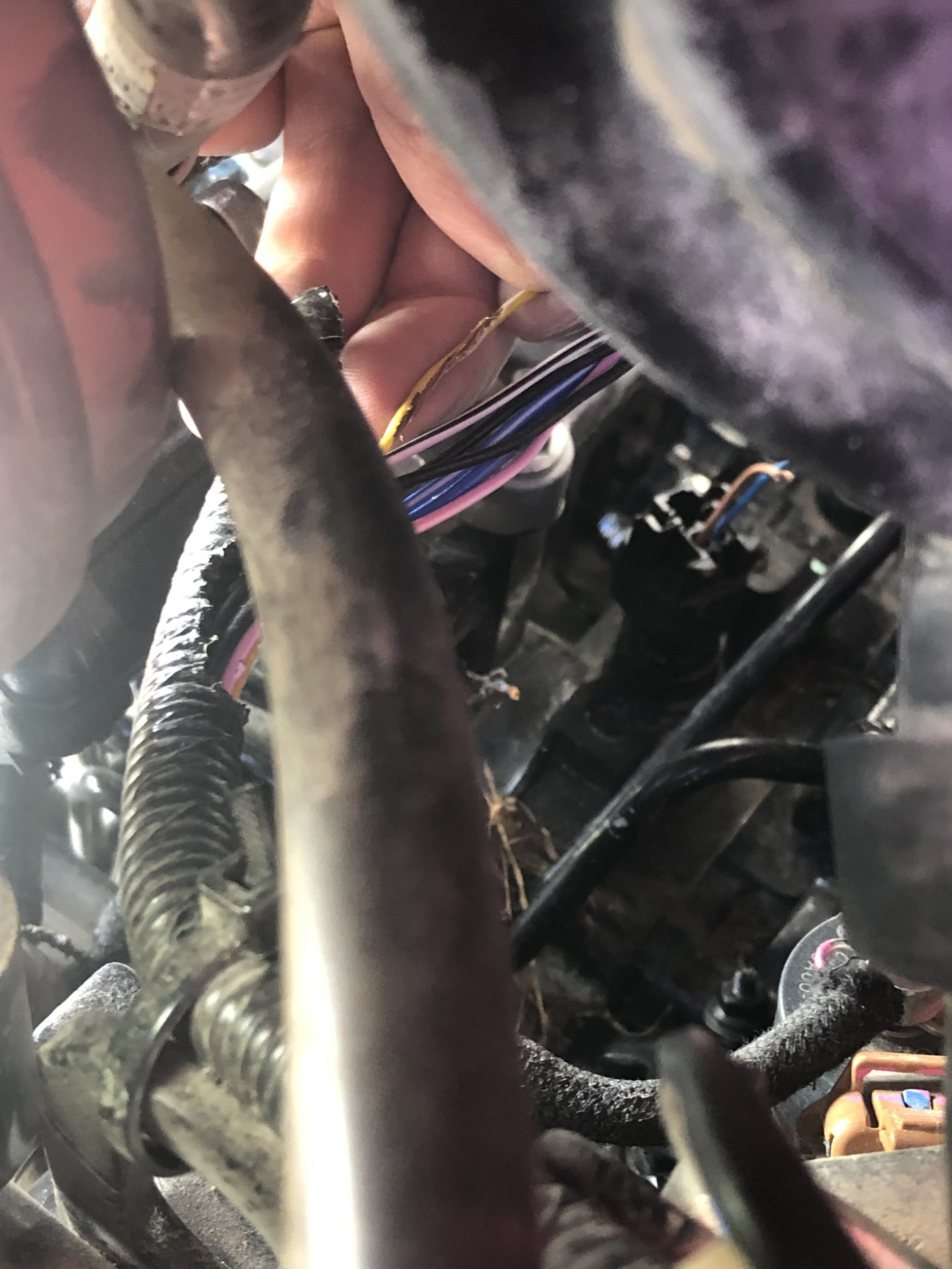

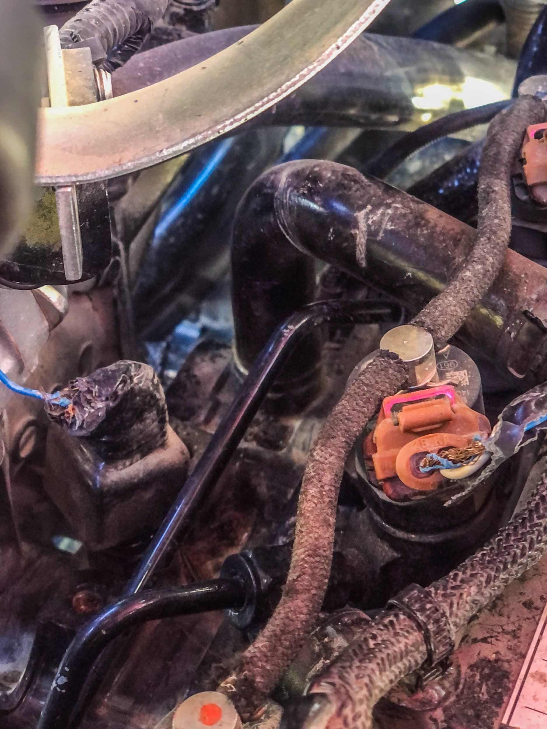

Thanks everyone for the replies! I finally got ahold of the service/parts department where I purchased the tractor. Sent them photos, they are going to try and source the connectors for me and we'll splice them into the old harness. Thats the plan anyway. Theres only 3 that need to be replaced, I'd hate to rip out the old harness just to replace 3 connectors but we'll see how it goes.

I have done frame and harness replacements and it takes forethought to do it right. Take lots of pictures and mark where the harness runs with a grease pencil. If it were mine, I would splice connectors in. Be sure to solder and use shrink wrap....seal it good. If done right it is permanent.

   / Rodents Chewed Main Engine Harness 🐁⚠️😫 #20

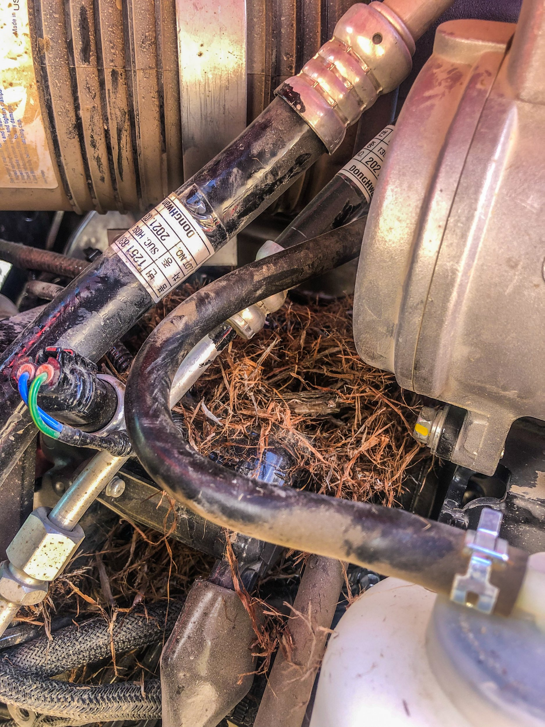

Hello everyone,
The other day I went out to start the tractor and noticed multiple check engine lights on dash. I immediately shut it down and begin to inspect the engine. Well to my horror I found a giant rodent nest. So after cleaning everything out and inspecting I found a few spots where they decided to have a snack. It looks like the main harness took all the damage. The wires connected to the middle injector, the bundle of wires that go to the DPF system and what I think is the cam position sensor. I've attached some photos. Does anyone have any recommendations for a good parts supplier ?
