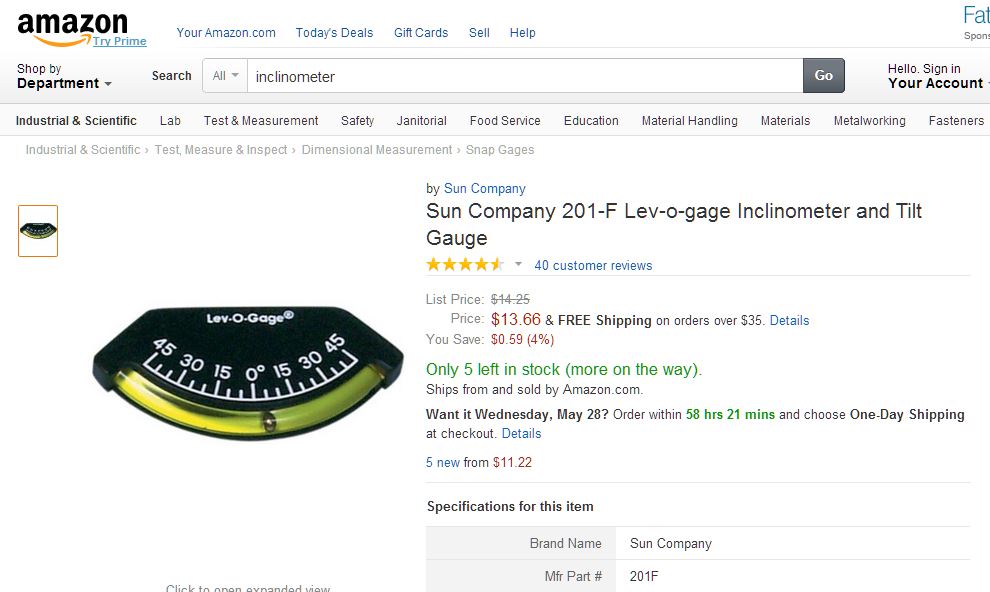

   / ROLL OVER ANGLES #5
Here's you a meter.

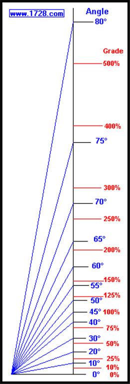

   / ROLL OVER ANGLES #6

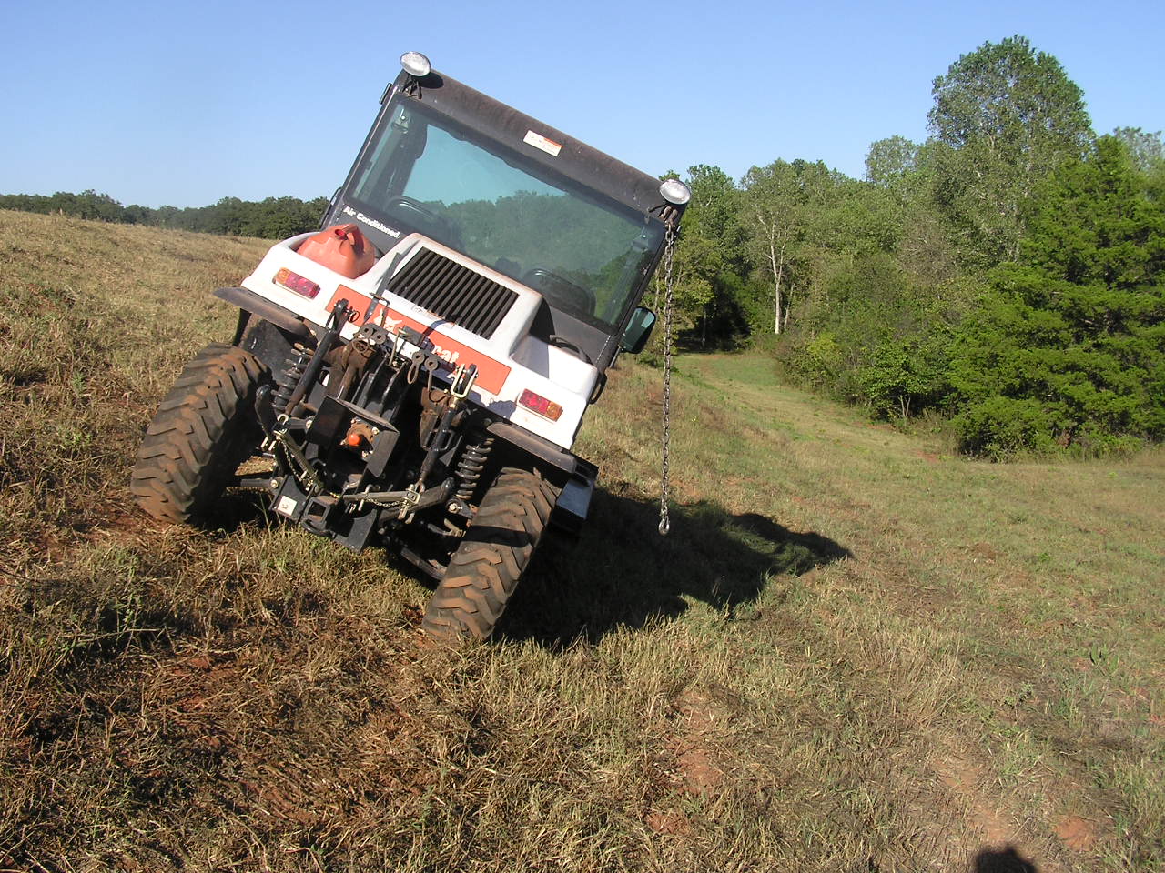

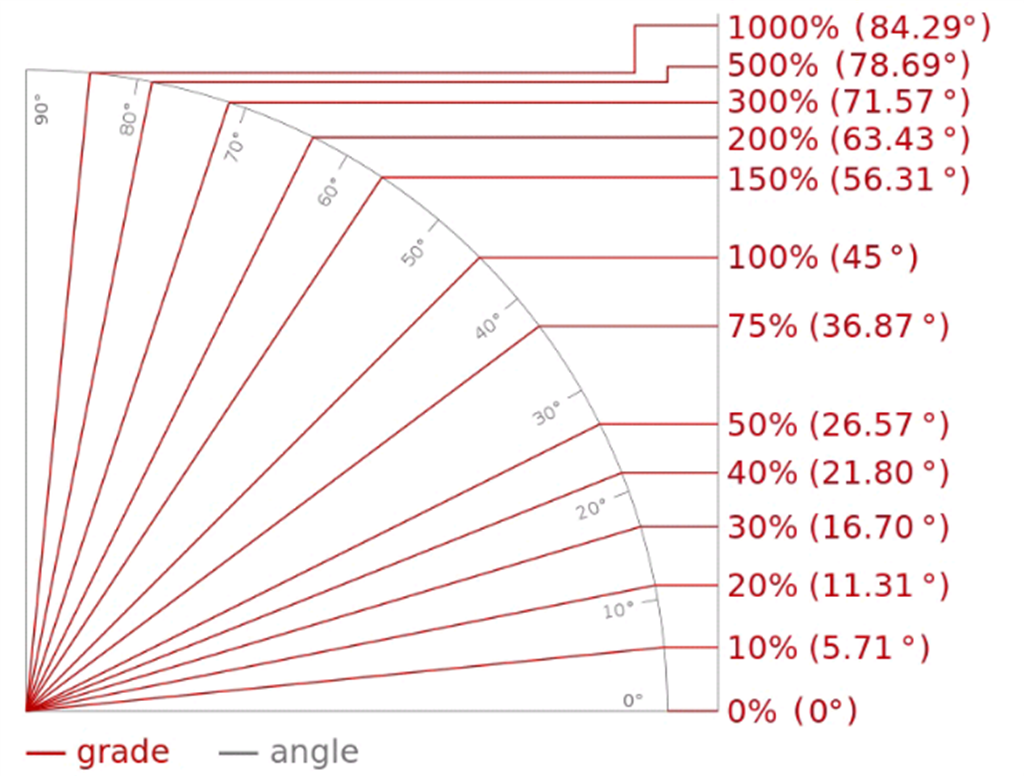

This is what 27 degrees looks like. The chain hanging from the work light shows 90 degrees.
The Toolcat has a low center of gravity.
