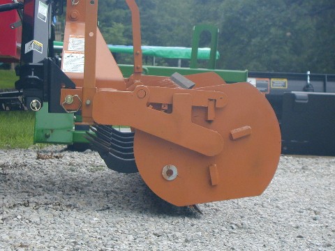

John,
I have had a Woods 60 inch rollover in the past and really liked it a lot. It has a lever you can reach from the seat to operate the latch. I found it necessary to raise the implement to reach the lever, but it was no problem. Once the latch is released you lower the scraper to the ground and slowly drive forward or in revese to rotate the blade to the proper position.
I think one of the big advantages of the rollover design is that the weight is much heavier than a typical fixed blade design of the same width. Weight is a major factor in making a box blade work well. I strongly recommend that you use a parking stand with it--either get it as an accessory or fabricate one yourself.
I am not familiar with any rollover that uses hydraulics, but they may be available.
The reverse position of the blade is used for backfilling. I used it the least of the 3 positions, but it does work well when you need to backfill.
The price you were quoted seems right in the ballpark for a 60 inch rollover.
