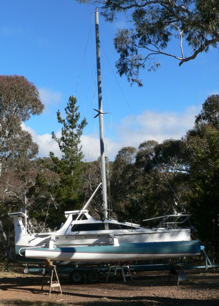

Following the advice by various members here, I have been running the 4WD up and down the road several times and after the soft stuff packed down a bit, I did it all again with a trailer carrying about 1/2 ton of rocks. The road is still a bit rough in places but I hope it will be stable enough to get the new boat out - the reason for the new road in the first place, because the existing road was too winding to take 8 metres of trailer on a 6 metre vehicle.
Here is what I have spent the last 2 1/2 years doing in my "spare time" in the bush and it would be kind of cute to get it off the mountain and down to the sea. Of course, the outer hulls (amas) fold in and the mast lowers for transit
