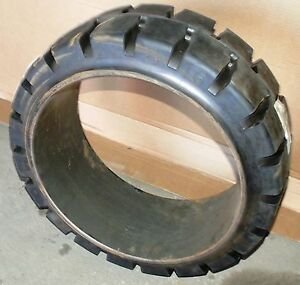

I have access to (through work) a bunch of press on solid rubber forklift 'tires' that have been worn pretty much smooth.
They are about two feet in diameter, 8-10" wide and are probably 40 or 50 lb a piece with a steel rim attached to the rubber that is probably a quarter inch thick.
Wondering at the feasibility of putting a bunch of them together with short (2-3") welds in four places around the outside of the rim, then using pieces of angle iron or flat stock to make cross bars to run a piece of pipe through to make an axle.
Once it was all together, I would probably put it on end and then fill it full of cement.
Tentatively thinking of making 4 ft sections, these would mostly be to roll out the lawn or parts of the lane way when they get rutted up from the mud in the spring and fall.
Thinking if I made three 4ft sections, one with a hitch in the center, one with a hitch on the right and one with the hitch on the left they could be pulled together as a gang of three to cover approximately 10 feet.

The center hole is probably 20-22" in diameter, they look like this when new:
The ones I can get have the tread worn smooth, but they still have the metal ring (like a piece of heavy metal pipe) on the inside.
The rubber is between 1" and 1.5" thick when worn smooth.
Thinking of welding because that would seem to be the simplest way to attach them together.

Welding them together is the easiest Aaron, but manufactured ones will have a floating axle to allow individual segments to work independently to be more effective.
/ Roller made from forklift wheels?
I agree and if I can round up a bunch of pieces of pipe that just slide inside of each other, I might go that direction. Otherwise, I am thinking of welding 2 or 3 wheels together and making sections that can spin independently.
