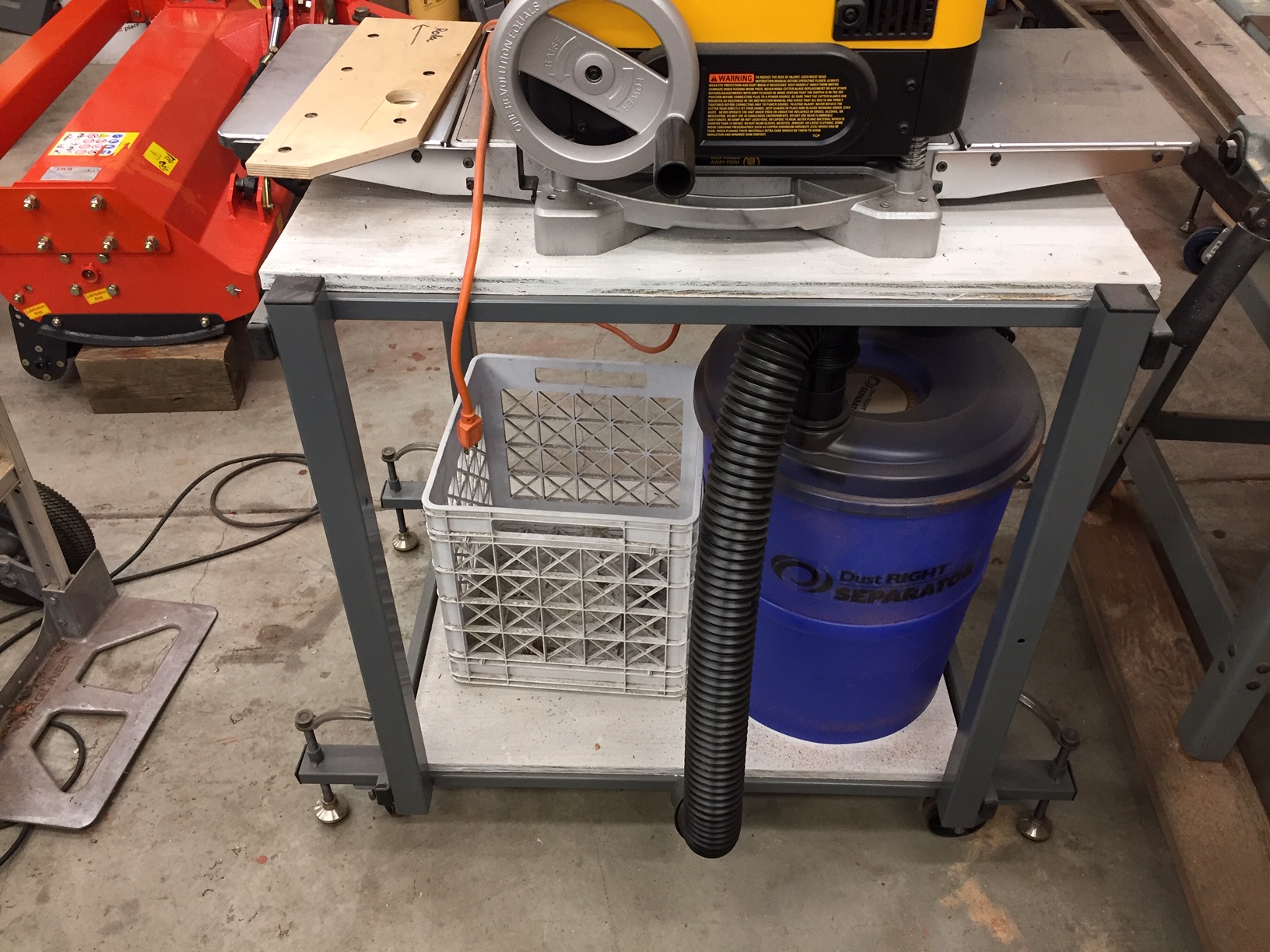

For a more secure setup for a planer I made this stand with casters for moving and screw lifts for use during operation. It is absolutely rock solid.

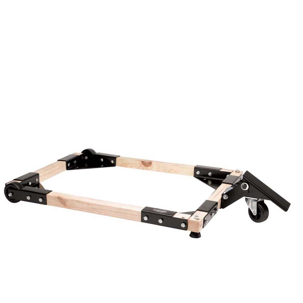

Drill Pess Mobile Base.jpg Looks like this could be adapted for your drill press.
