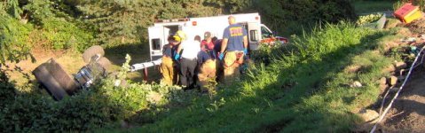

On Saturday, my Grandpa rolled my New Holland TC24. He broke his leg (femur) and is in the hospital for a while.
He was showing me how to use a chain on the loader to lift big rocks. The front wheels of the tractor were on a small mound (12" high or so) in the center of our flat garden area. Then he jumped on the tractor, released the brake, and forget to put it in gear (it is a hydro). He stepped on the forward pedal, but started to go backwards. I saw him continue to try to step on the forward pedal, but not the brake pedal. He rolled about 30 feet backwards across the flat area of the garden, slowing almost to a stop, but reached the edge at the top of a very steep hill.
The tractor went off the edge, and rolled at least one and a half complete times before landing nearly upside down on a log. My Grandpa apparently fell out on the first inversion, but I could only see the bottom of the tractor, so I don't know. I assume he was not wearing his seatbelt.
To give a bit of background, my Grandpa is 94, and has been using tractors constantly since he was 12. He lives alone on 200 acres, and uses his tractors and bulldozers nearly every day, even now. All of his equipment is manual, and this is the first hydro on which he has spent real seat time in his 82 years of operating experience.

My wife had the presence of mind to grab the camera when the ambulance was there, and captured the dramatic scene I have attached.

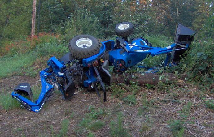

Here is how the tractor came to rest. The old log is holding up the right rear tire.

   / Rollover with Injury. #4
Wow!
That's a heck of a story!
I think your Grand Dad is one heck of a lucky guy! That tractor could easily have crushed him during the roll over. I hope he recovers quickly!
Have you righted your tractor yet? Is it damaged beyond repair?
