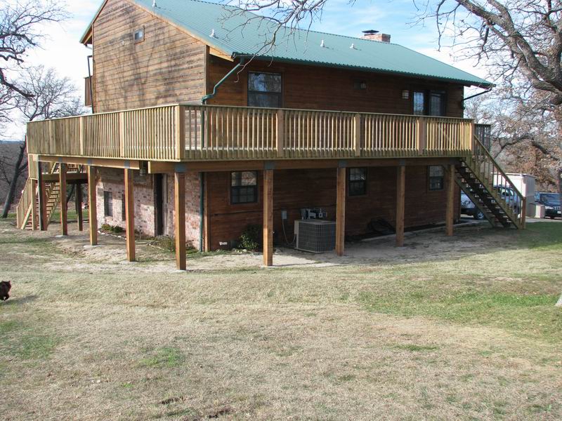

My HP unit sits on the east side of my house and away from afternoon sun. However, this last year we built a deck along the 2nd floor of house about 5-1/2' above the HP. I believe we have enough room for airflow to never be a problem and I expect even better performance during the summer. During our last snow of over a foot, it was nice to see the heat pump only got water dripping on it from the deck above as the snow melted.

If the heat pump is running, how would snow accumulate inside? It's been snowing like crazy here and we never get snow inside the unit. On top sure but not inside or above fan.
While clearing the almost 40" of snow here during this last snow, my wife and I took turns digging out our heat pump. When I went out to do it, I noticed it was filled up inside almost halfway. Yikes! It doesn't run all of the time. When the fireplace warms up the house some, the heat pump shuts off.
I decided that the next time I have room outside to work, I'm gonna build a temporary roof for mine. I'll remove it in the summer, but in the winter I'll leave it on.
I think what's most important is making sure you have proper airflow, and limit the use to the heating season. Using any kind of cover during the months when A/C is needed could cause increased pressures in the system leading to seal failures or excessive wear on the system because of the increased pressures caused by the heat. If a roof is used during the winter worse case scenario is increased run time of the heat pump. The defrost cycle will reduce the risk of freezing up, and the roof will reduce the risk of freezing rain and snow accumulation inside the unit. You'll still have to clear the sides, but at least it won't freeze up and cause the fan motor to burn up because of the fan being stuck in place from freezing rain or snow accumulation.
