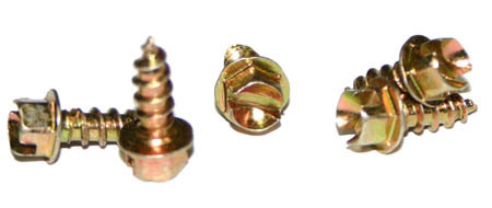

I ended up ordering chains for the rear of my tractor. Had already ordered fronts. I 'think' they will fit rear. I am slipping and sliding around blowing snow and when using the FEL the tractor will not turn. In addition, I had already ordered some gold 1/2" course thread ice screws. Bought them at Dennis Kirk. There are various places to buy them. I may even install some on the outer lugs on the fronts and rears with chains. Maybe do the ATV, etc. See attached picture of the ice screws. They have hex heads and you can remove them with a screw driver if the head wears. More expensive then just normal screws. I paid 64.94 to my door for a 1000 of them.
Regards
