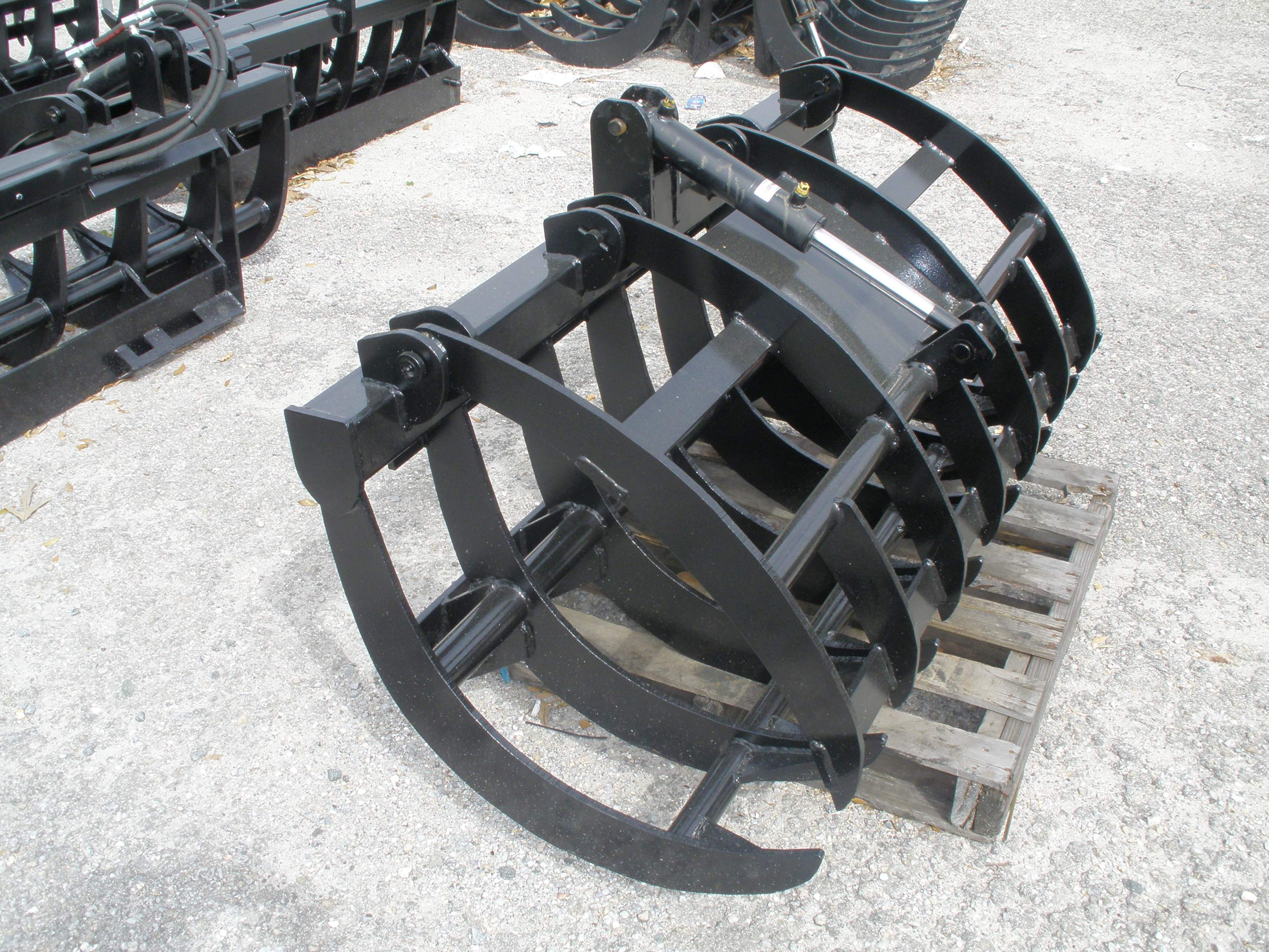

The rake grapple I'm considering (not seen much quite like this one)...Skid Steer Extreme Claw Grapple
The root grapple (same as everyone else's)
Skid Steer Root Grapple
I know they make rock buckets, but I have one from a different manufacturer and dont much like it. The tines still pick up too much dirt.

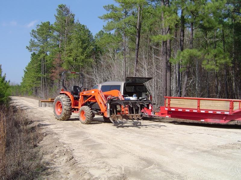

I got this grapple when I bought my tractor. Up until now I've only used it to move 2 large piles of logs but I'll be trying to rake some with it in the next few months. As far as picking up things with it I've learned to tilt it all the way down and come down onto what I want to pick up rather than try to slide under; it works much better that way. For what I've used it for anyway. And almost all of the dirt falls right through.
One consideration; you need to figure the weight difference between the bucket and grapple. A 600 lb grapple in place of a 100 lb bucket takes up 500 lbs of lift capacity.

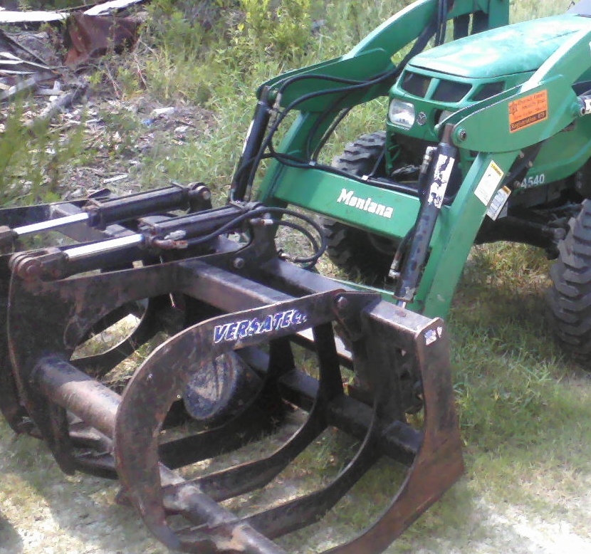

To answer your question Carver, the answer is yes. I have used mine in the way you have mentioned, except for roots and root balls instead of rocks. I think you need to consider the shape of the lower jaw as to what you want to do, too.
Everyone has their likes. I have a WRLong grapple and really like it. It is the root grapple.

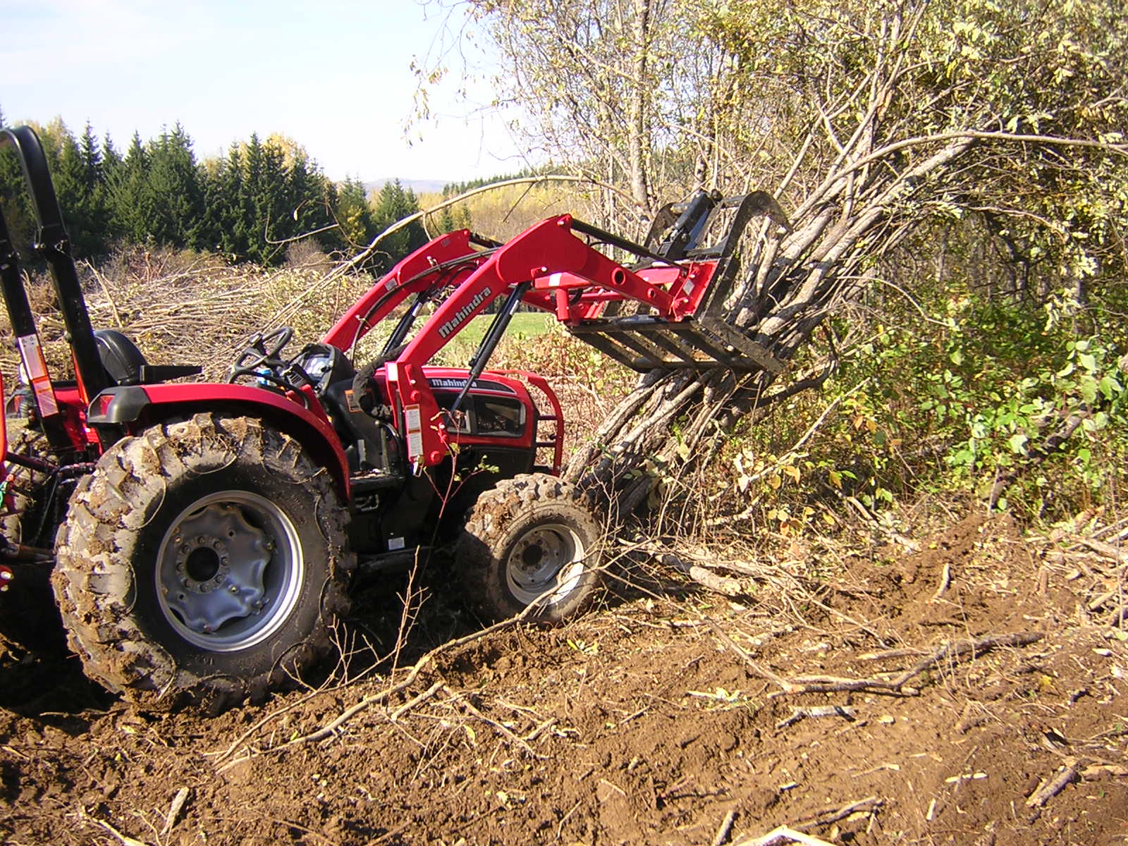

I have a Root Rake and I use the top as a rake to back drag and gather brush and undergrowth and clean up dead trees and brush.I pick up and move anything I want with this and also dig out stumps. Works good.

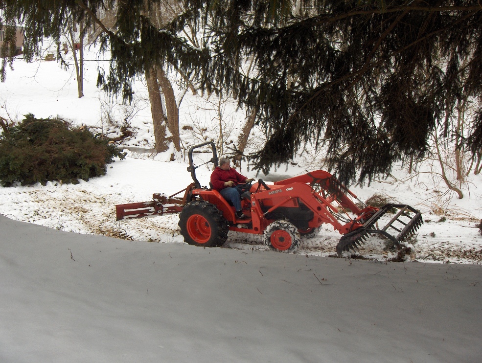

I use my root grapple like this,
but before I can get to those trees I have to rake the alders out of the way. I put a shallow angle on the rake so the tines dig in a little but not to much to stress the cylinders and rake up a pile, clamp and back up. It works great. I don't know how much of this stuff I've cut with a saw and it's a pain. No more.

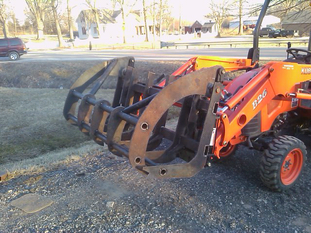

I have a grapple rake and I like it. Now each type has their pros and cons. The model I had is an Anbo GRM66 and it is a nice tool to have. I use the upper rake to back rake into a pile. One warning is to fully extend the rake against the stops when back raking or you can blow a hose.
