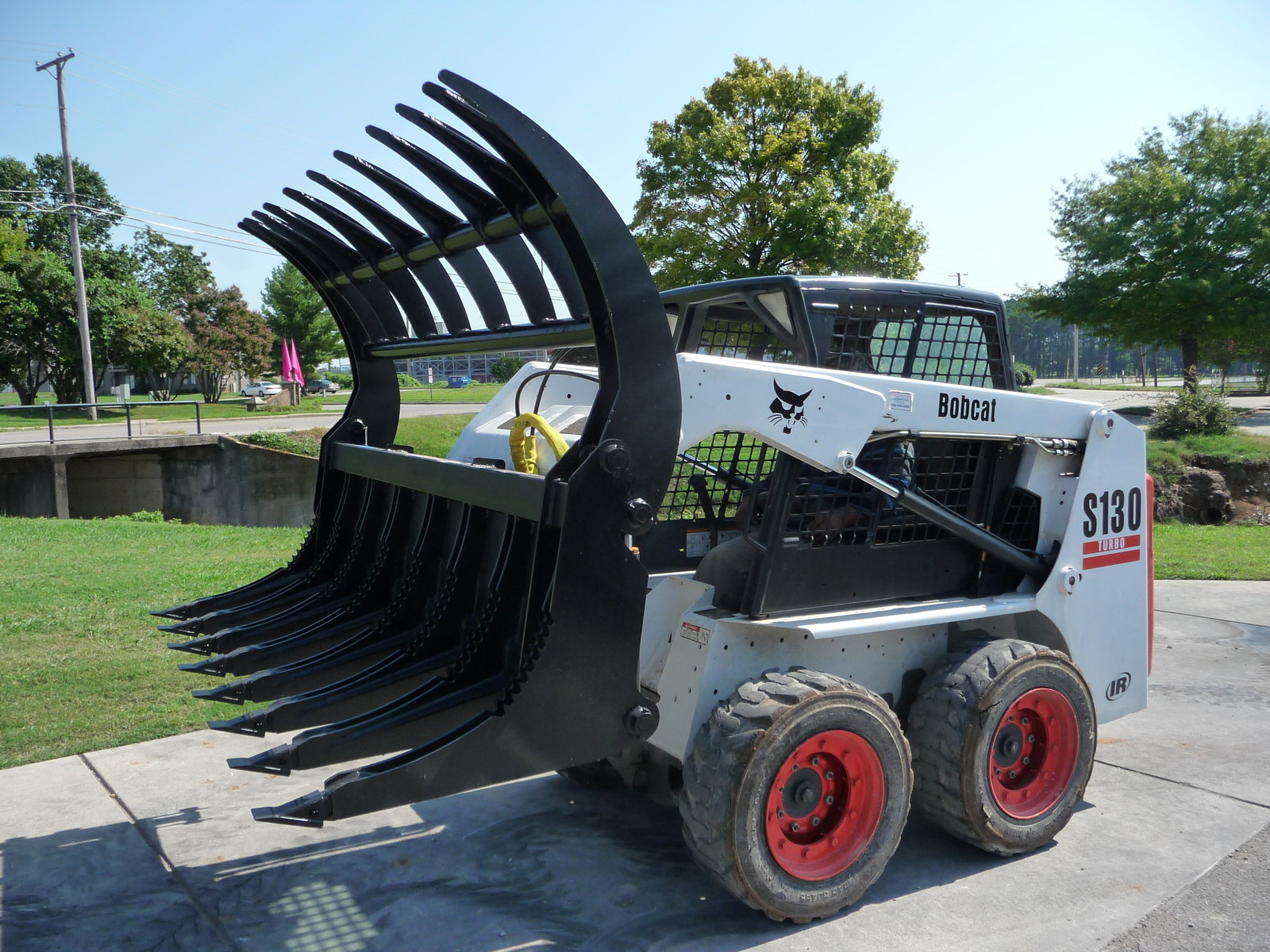

that's what I envisioned, chomp up a big pile into a smaller pile. then if need be, pick it up. I don't want to have to change attachments back and forth.
I mean with the grapple and shears.
Rough idea:
   / Root Grapple with shears
#22
maybe a diverter valve to switch from one set of cylinders to the other set then I wouldn't need a new spool valve.

this is the grapple I want to modify. $T2eC16VHJGwE9n)yTeKUBQNRwh8od!~~60_57.jpg

What model tractor are you getting? That style grapple with added cylinders and what not could start getting pretty heavy.
I'm getting an LS xr4046hc with backhoe.
#28
I'm clearing brush and limbs that are on the ground in the woods. I will be working down low to the ground.

that is the one, I may have to look into a 48" grapple.
