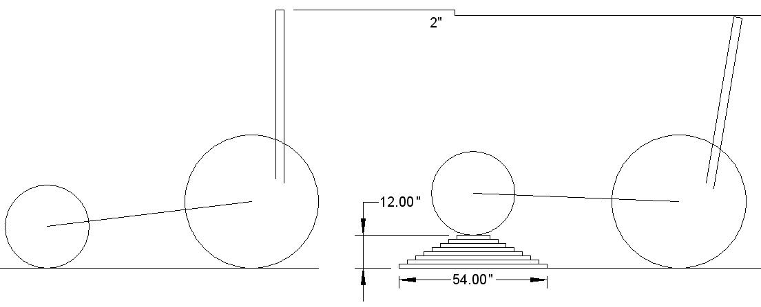

Beppington's idea is certainly a good one, but knowing me I'd forget the ramps one day and back it out, tearing down my shed. I think the risks are too great that you'd have a senior moment and damage the shop one day. I personally think folding ROPS are a pain in the butt. Mine folds but I've never used it, thankfully my door is high enough. I can't imagine folding and unfolding that thing every time I put the tractor up. The same principle applies about forgetting as the ramps, sooner or later you'll forget to put the thing down when pulling into the shop. Airing down the tires isn't going to do it.
Bolt the ramps right to the floor? :)
