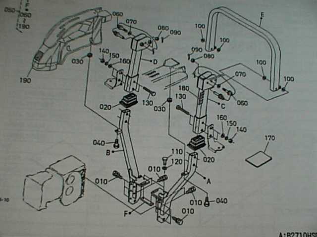

I have a B2910 and my ROPS is now loose. I think a bolt (or 2 ) has vibrated out. I cannot find the right size bolt to replace. I tried a 12mm (too small) and a 14mm (too big), and then I had the Kubota place order some for me, and they don't fit either ( They may have just ordered for the wrong tractor). Anyone with a service manual has the right size bolt to hold the Foldable ROPS onto a B2910

Hi Jim,
I'm not sure which bolts you need, so I'll list all of them for you.
Starting from the bottom:
#10 = 01123-51235 bolt (10)
#40 = 6C040-5134-2 bolt (2)
#110 = 75599-04320 bolt (2)
#130 = 75599-04665 bolt (4)
#060 = TA240-4846-0 assy bolt, set (2)
The numbers in parenthesis are the total quantities used.
Well the picture didn't work, so I'll have to use an attachment.
Those who live by the sword, get shot by those who don't.
   / ROPS Bolt Size for B2910 #3
Jim,
It looks like Bubba got all the numbers shown on the parts breakdown. Its kind of hard to tell which one you might need, and naturally, Kubota doesn't specify what size the bolts are..their way of making you buy from them instead of going to the local hardware store..I guess. One thing you might do when you get a chance...go to www. tractorsmart.com, and you can download a parts breakdown for your 2910 and FEL. The tractor file is quite big, and you need Adobe acrobat on your pc, but having those files could come in real handy if you need a part, or just need to see how something goes together.
