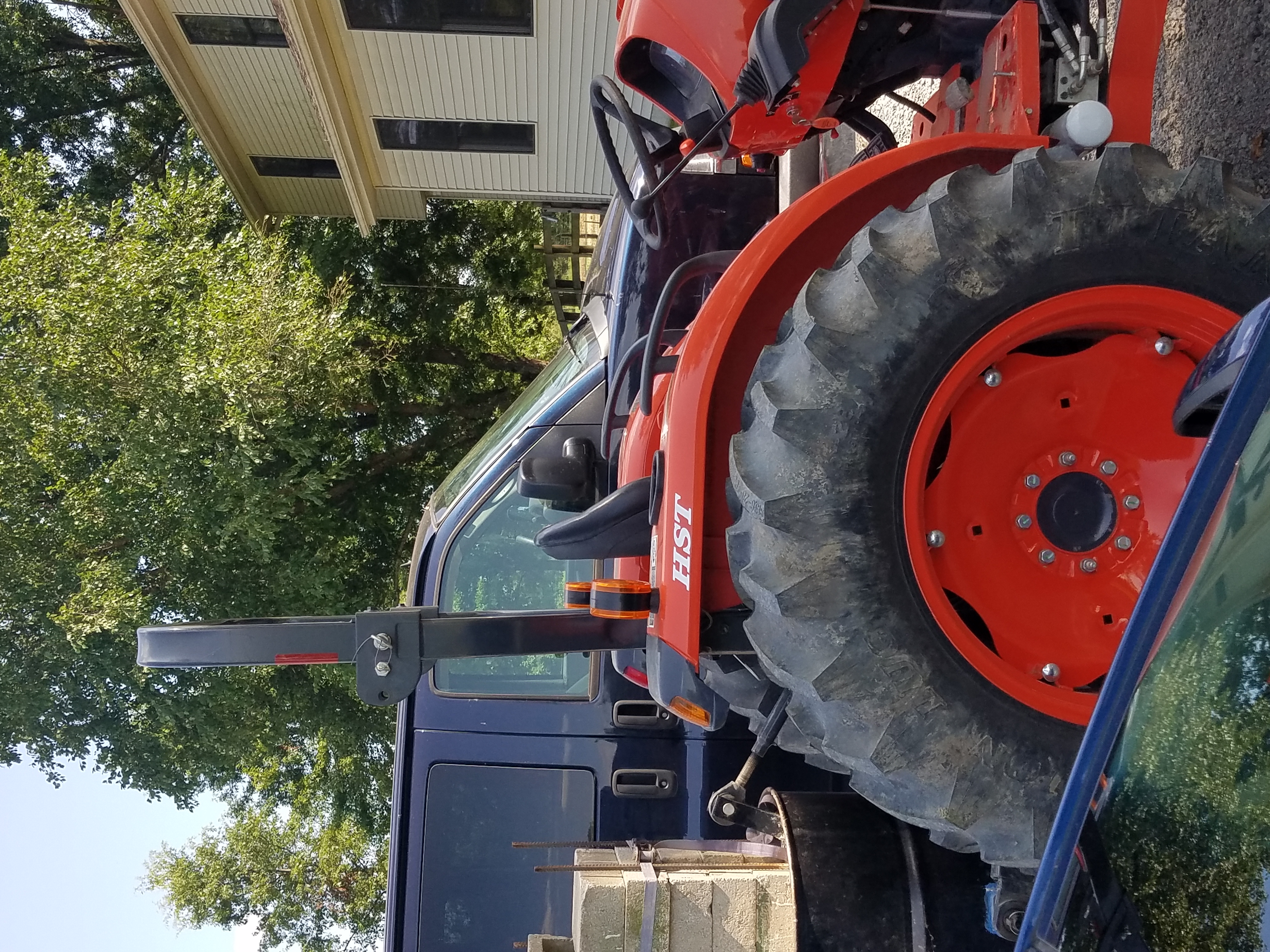

2018 MX5200 purchased new. Made it all of 85 hours before I ran into a barn header board today with the ROPS. Looks like it bent back a little. I couldn't find any cracked welds or metal. Should I be worried? Feel like a dumbass.

I would check the mounting plates and bolts. Unless you really were moving doubt you did any real damage to it.

It doesn't look to bad,I wouldn't really be worried about it that much,those rops are pretty tough.

Are you sure it bent back? Many ROPS come sightly leaned back from the factory. They're really sturdy- thick wall large diameter tubing and thick mounting plates that tie into the axle or transmission. They're designed to support the entire back half of the tractor when it rolls over, with a significant overbuilt safety factor. It'd take a real hard hit to bend one.
If it was bent, it'd be bent more on one side than the other. From that pic I don't see that, but it's just one pic.

If it was bent, there'd probably be a stressed area where the paint started to flake off. Check the mounting plates where it bolts to the frame.
If you don't see that, don't worry about it. If you do see that, I still wouldn't worry about it.
I did the same thing to my GC1720 with 12 hours on it. I actually ended up ripping the front fascia off my garage when I tried to back out while panicking after the initial hit going in. I felt sick about it for a while but couldn't find any evidence of bending. I checked squareness with string and everything. Now I just don't care.

I have a new B2650 and my ROPS appears to be at that exact same angle. Most of the Kubotas that I have seen are angled back a bit. If you bent it, it would likely be out of square, is it?

I doubt any damage to it. As stated above, the paint would have flaked or wrinkled. I doubt the bolts stretched, but you could check tightness to confirm.
