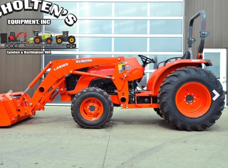

I would check the mounting plates and bolts. Unless you really were moving doubt you did any real damage to it.
Went over everything. It all appears in tact.

Are you sure it bent back? Many ROPS come sightly leaned back from the factory. They're really sturdy- thick wall large diameter tubing and thick mounting plates that tie into the axle or transmission. They're designed to support the entire back half of the tractor when it rolls over, with a significant overbuilt safety factor. It'd take a real hard hit to bend one.
If it was bent, it'd be bent more on one side than the other. From that pic I don't see that, but it's just one pic.
It very well may have been like that from the factory but I don't know for sure because I never really checked until now. It definitely flexed backward because I could see it flex forward when I reversed away from the board. I was hoping others would chime in saying theirs looks the same

This might help a little.
Idk. Looks like the one you have may be a touch swept back. Its really hard to tell.
The "flex" you saw may have been the front end getting light or rear tires compressing a little, then when you backed up, the front settling or the rear tires unloading. I doubt it flexed and did not leave any evidence like damaged paint or stretched bolts (you did check them for tightness?)

I don稚 think I would worry about that much.
My rops is at about the same angle as that, since I bought it new. They are designed to take much more abuse than that.

It wouldn't have been much of a ROPS if you indeed damaged it from that.

Well - it looks the same as mine on the M6040. And I've never hit anything with it. Check that your mounting bolts are tight and don't worry about it.

Double check welds bolts,doesn't look like any damage...part owning tractor. ;)

In looking at the pictures, I don't think you bent anything permanently. You may have temporarily flexed the ROPS but it looks like it went back into position. These things are tough and are built for rolls and tumbles. Any bend could be a liability on the company in the event of a roll. They may be designed to flex to prevent a "break" or bend.
