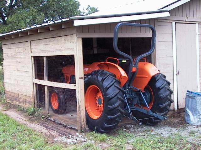

Re: ROPS for L345 installed
Bill,
I installed the ROPS on my L345 this past weekend, with help from my father-in-law. Only hard part was holding the arms up while I lined up the holes. A hoist would have been handy!
One interesting problem. The ROPS fits between the transmission case and the top link bracket, and the draft control arm has to be removed, lengthened, and replaced. The instructions say to measure the length prior to removal, add 76 mm and replace. Of course, it can't be extended anywhere near that much, and Kubota (or anyone else, for that matter) doesn't have a replacement part that is any longer.
I asked a Kubota mechanic today what he would do if he were installing the ROPS, and he said he'd cut the arm and weld an extension in the breach. I guess that's what Kubota had in mind? I guess that's what I'll do - as soon as I find a welder who will do it for me.
Of course, adding the ROPS has created yet another problem. See the attached picture./w3tcompact/icons/hmm.gif
