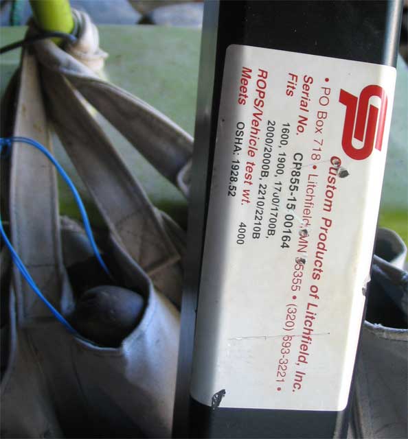

Did they indicate if they will be certified to meet OSHA 1928.52? If they aren't certified to meet OSHA, they're of limited value. I won't dispute that a non-OSHA device might save a life, but for a landscaper, etc., actually anyone who might have an employee on the tractor, they had better have an OSHA certified ROPS, or they'll go under paying the fines. Additionally, if I didn't know what standard the ROPS met, and what that standard stood for, I'd be leery of trusting my life, or my children's lives, to just any old ROPS when an OSHA certified ROPS was not much more costly.

My question is, why would you want to buy a ROPS from a place from overseas. We need to support the companies here, to much money going every place else now. The ones here aren't all that much higher, maybe around $100, and I'm sure better built.

I am not saying they are not, I am still uncertain...is "OSHA compliant" the same as OSHA certified? Particularly to the applicable standard here, 1928.52. If so, there should be a tag on the ROPS stating such and listing the standard. For appearance I think the one made by Custom Products in MN is more impressive.
