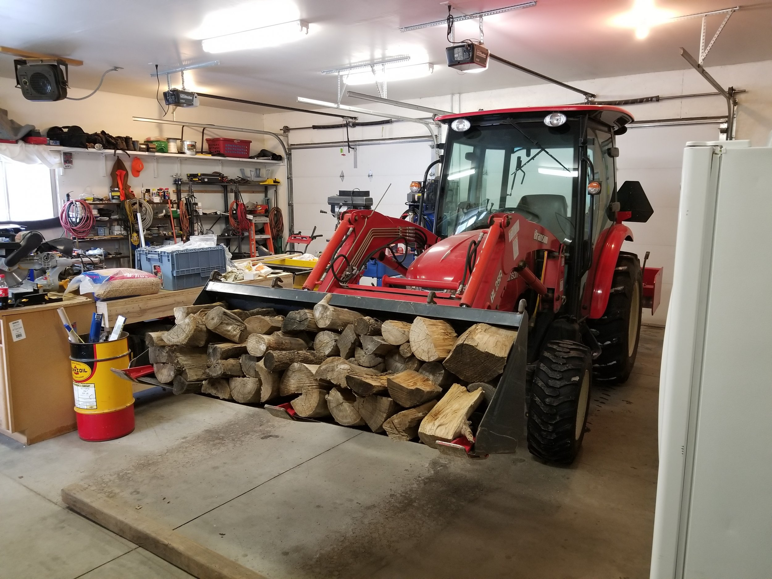

I would also get tired of hearing the pins rattle if you opened the hole up for easy clearance. But I can see how hammering out the pins every time you have to park the tractor would get old pretty fast.
I'm fortunate that I have a cab and tall shop doors.
It even (barely) goes under my garage door on the garage attached to the house.
