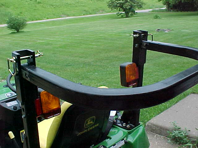

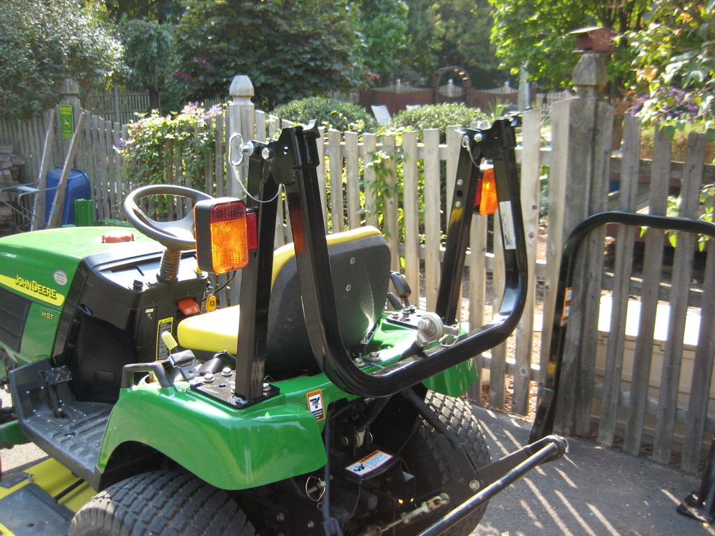

The hinge should be very easy, here is some pics I stole off the net; the second one looks fairly easy to make. Note that the side plates are spanned at the front into a U shape, keeps the side plates from bending.
If you design your own remember that it should handle side loads (if you tip on your side) and also if you roll over backwards (stand it on end).
Some have built their own using a "barn hinge" as the hinge and using cross pins to lock it in place (the hinge is not used as a structural compenent when the ROPS is locked upright).
You will have to consider the thickness of the tube on your ROPS; the wall thickness might not be heavy enough for cross bolts, you might have to add some plate to the increase the wall thickness.

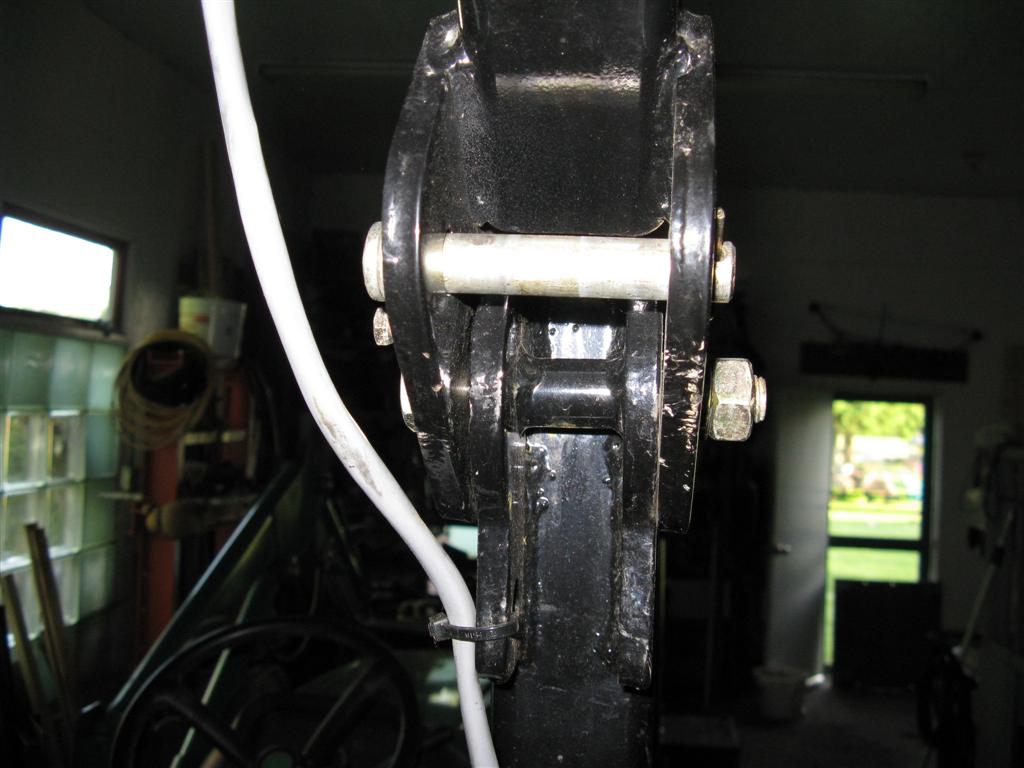

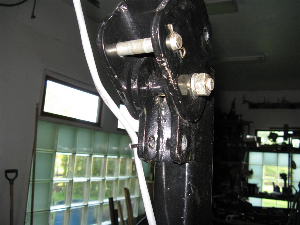

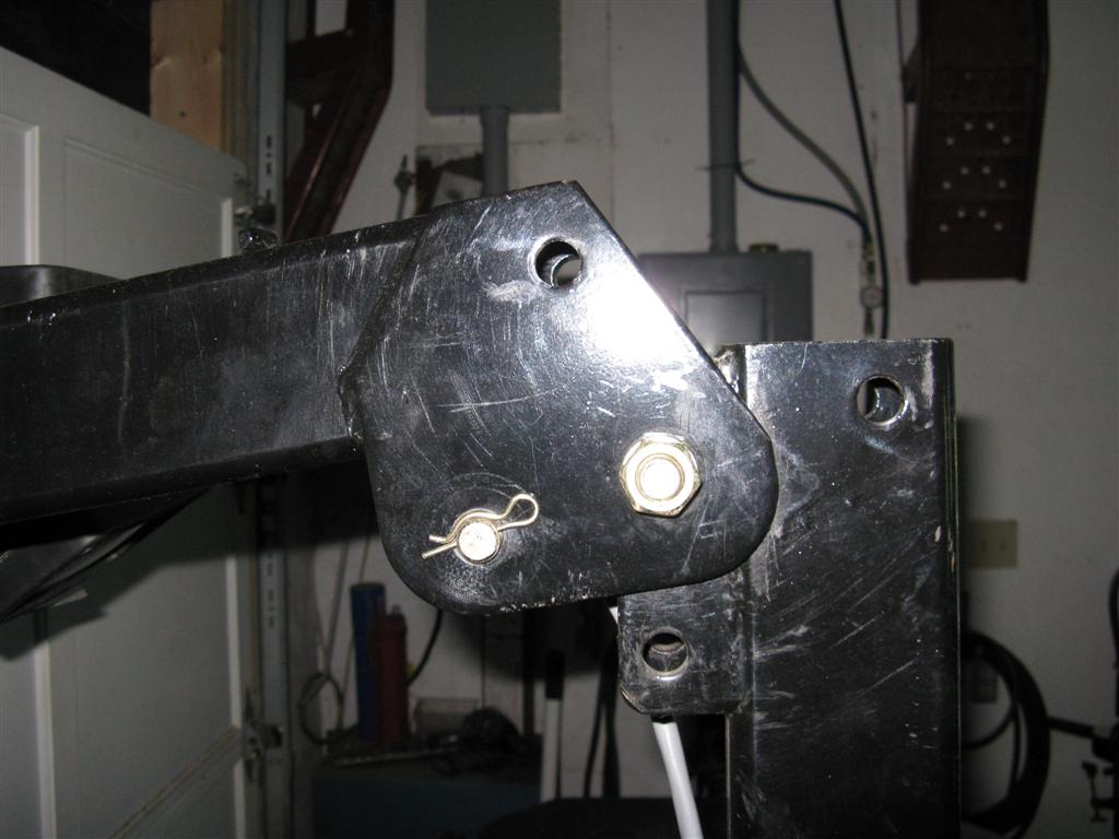

Here is a close up of the hinge on my Montana. Hope it helps.
Cheers,
Mike

Thanks for the helpful information , time to get some stock and start welding. Great photos.

You have a couple good pictures from mwb and j. j.'s suggestion is even simpler. If you plan to make a hinge it would be helpful to see one in person. Hope you show us what you decide to do. Richard
