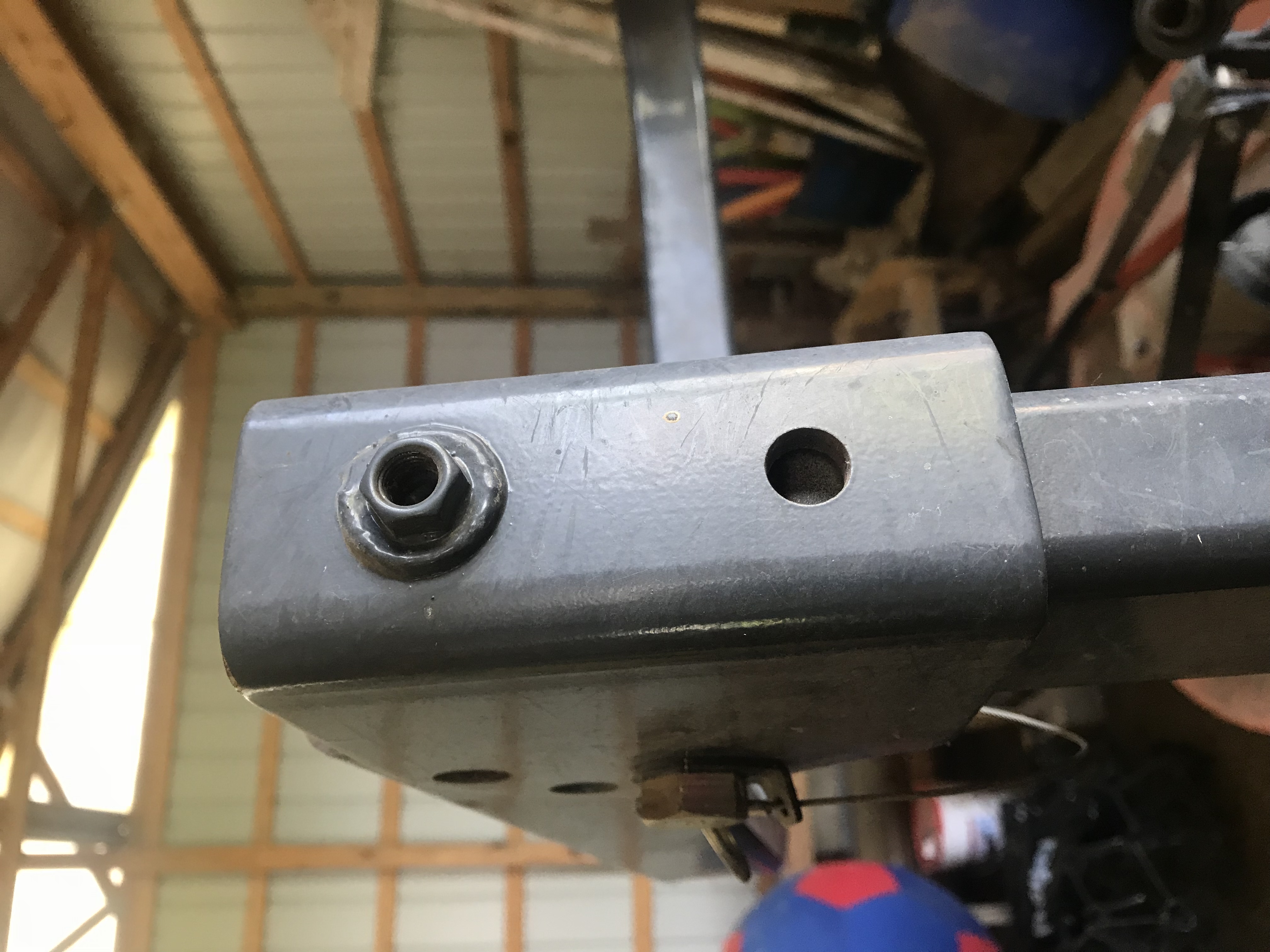

Anyone know what thread size is for these locations on ROPS on B3200?
Jun 18, 2018 / ROPS mounting lights - need info #1 mjw357 Platinum Member Joined Jan 30, 2011 Messages 706 Location The Sticks, Ohio Tractor Kubota B3200 Anyone know what thread size is for these locations on ROPS on B3200?
Jun 19, 2018 / ROPS mounting lights - need info #2 s219 Super Member Joined Dec 7, 2011 Messages 8,608 Location Virginia USA Tractor Kubota L3200, Deere X380, Kubota RTV-X Probably M10x1.25

Jun 26, 2018 / ROPS mounting lights - need info Thread Starter #5 OP mjw357 Platinum Member Joined Jan 30, 2011 Messages 706 Location The Sticks, Ohio Tractor Kubota B3200 s219 said: Probably M10x1.25 Click to expand... Yes, thats what they turned out to be. M10x1.25. I got 30mm long but had to cut about 1/4 off so the ROPS wouldnt hit them.
