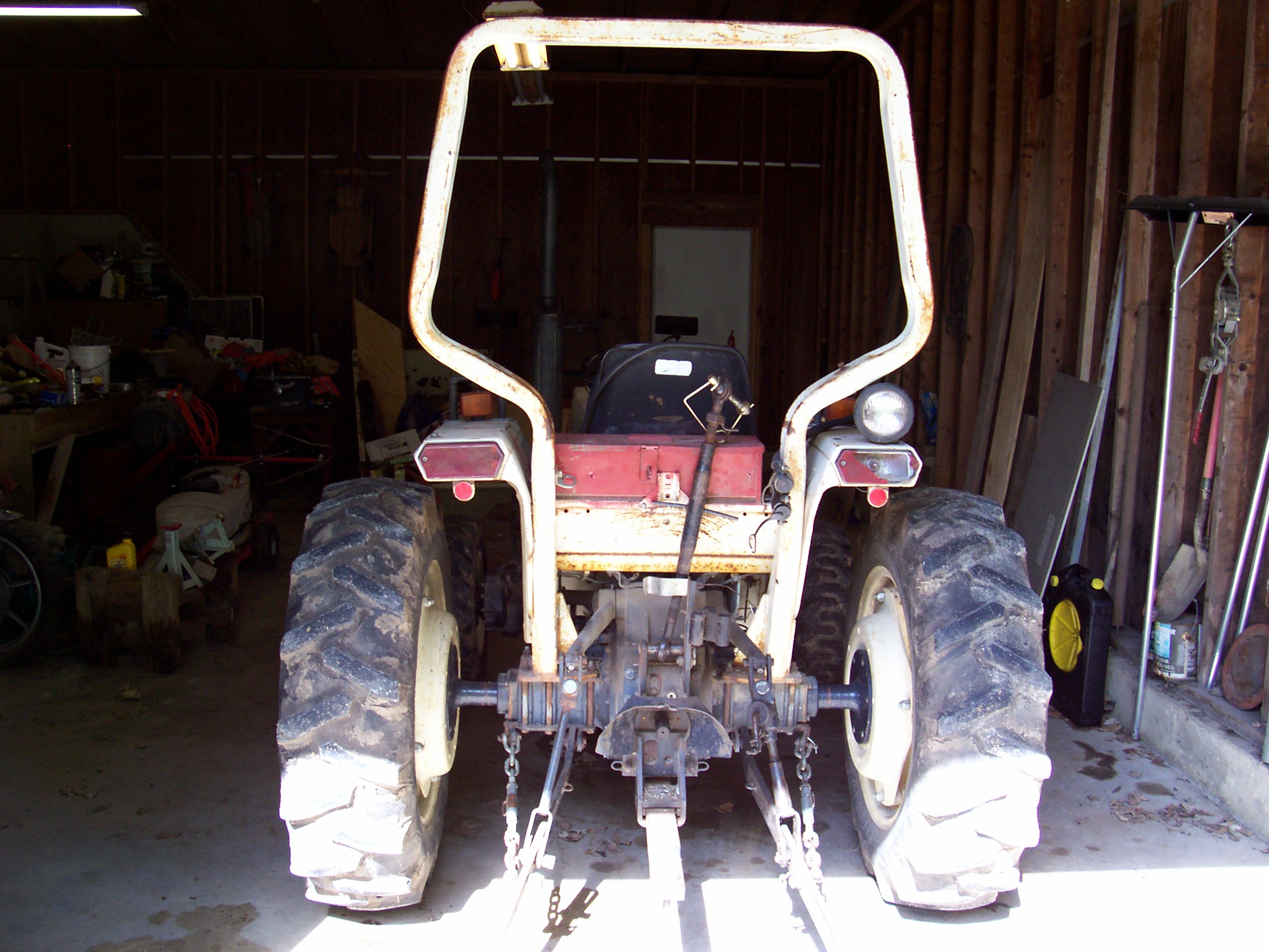

I have a White FB 31 and it has a ROP's on it. The tractor was made by Iseki

Howdy Ivan , I,ve Heard there very Close to the Same, Any chance of seeing some Pics of Where it attaches & How it is Mounted ? Thanks , Bob :D

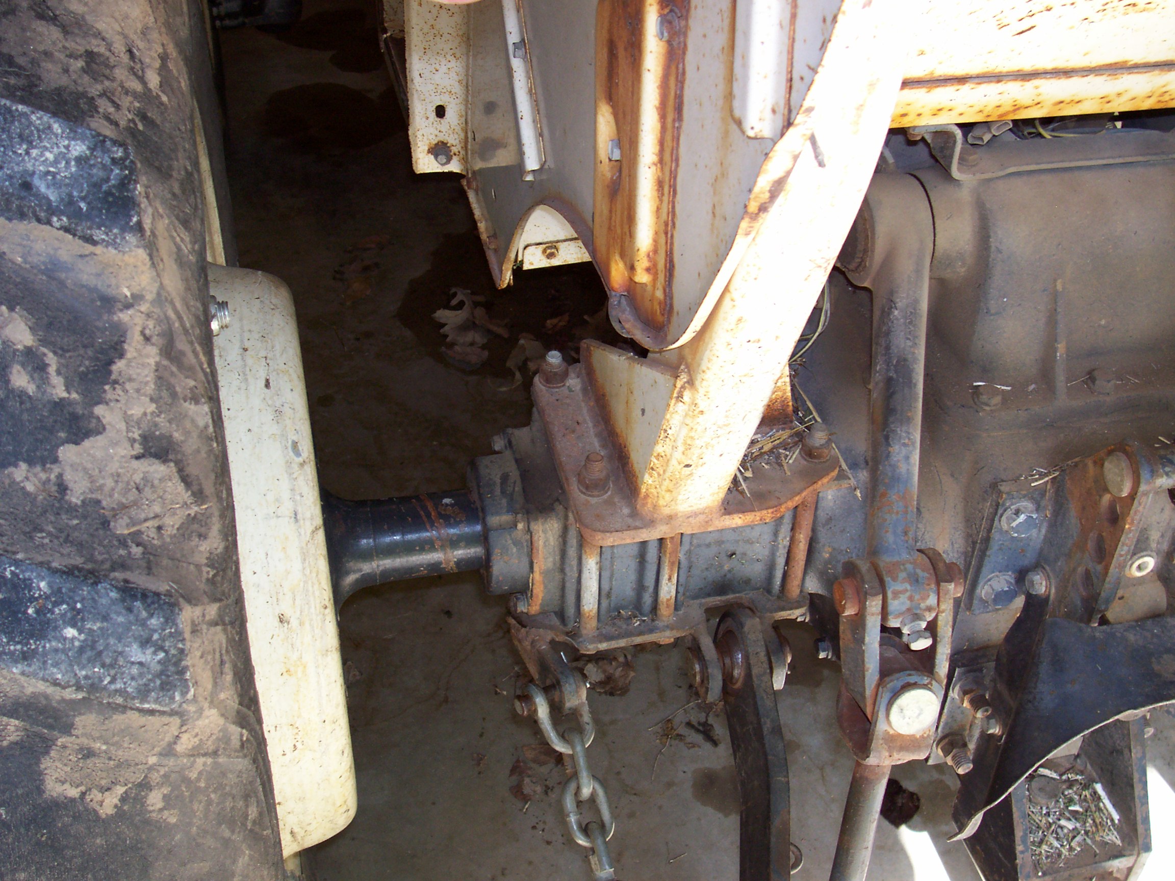

Here are some photos from my Bolens G247.
I hope they help.

Well DUH !!! :eek: You bet They helped & Thanks for the Pics coolnick73 , I never Even thought about those Ubolts used for mounting :D .
I Am Curious If thats the Way Most of Them are Mounted Though. Seems Some I Have Seen Look Like There Mounted to the Tops of the Fenders somehow, Which I Cant Figure out how They could be That Much Protection in a hard roll over . But then again anything is Better then Nothing I recon .
That Also looks Like it Would be a Handy place to Mount some lights for After dark Use , as My headlights seem to be Perty Much Useless with the Loader down low . I,m assuming that Came installed on the Tractor, Certainlly doesn,t appear to be Home Built & Also would Guess I Would need longer & Better Ubolts for the install ? Or At Least not With What I have to work with . Thanks again For Your time . Bob :D
