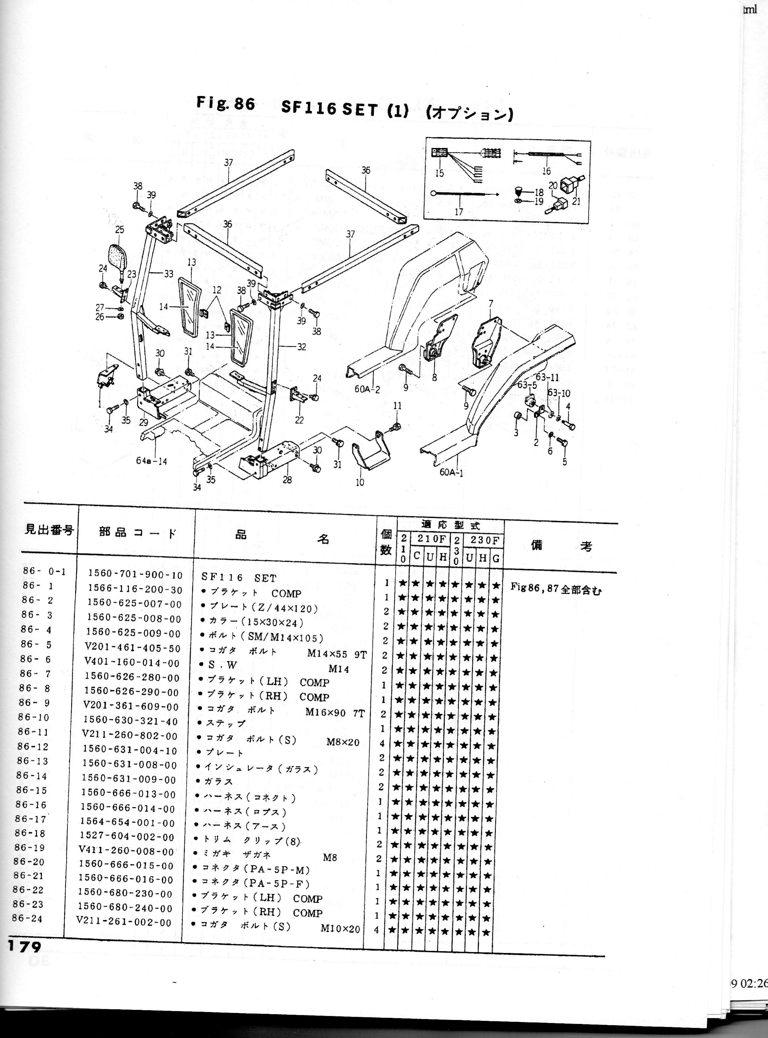

No sorrys needed Reg it Wasn,t Taken that way , I Appreciate the concern & Its Great advice . :D
Yes I Could hire it done with Bigger Equipment I Guess , but I Do Everything by Myself With what I Have to work with including a 12 thousand pound forklift I,d say That would make the best thing to tie onto, that I Can get Out to that Area & on Solid level ground , now that You Mention it & I have tons of chains . :D So Thanks for the Input once again .
I,d Rather not Have to Buy a Rops , if I Dont need to , As Other then That Project I dont really have Any other issues I,m Worryed about As we Live on Perty much Flat Land as You would Expect in Kansas . So I Might Rethink things now & Go for the Seatbelts & Hold off on the Rops for now at Least on Both Tractors .
I Still Might want to Get one for the Bigger of the 2 though Because I Also Have a Small pond Project I,ve been Working on , & It May Come in Handy for that, Just in Case . So any & All Info is still apreciated . Thanks again , Bob

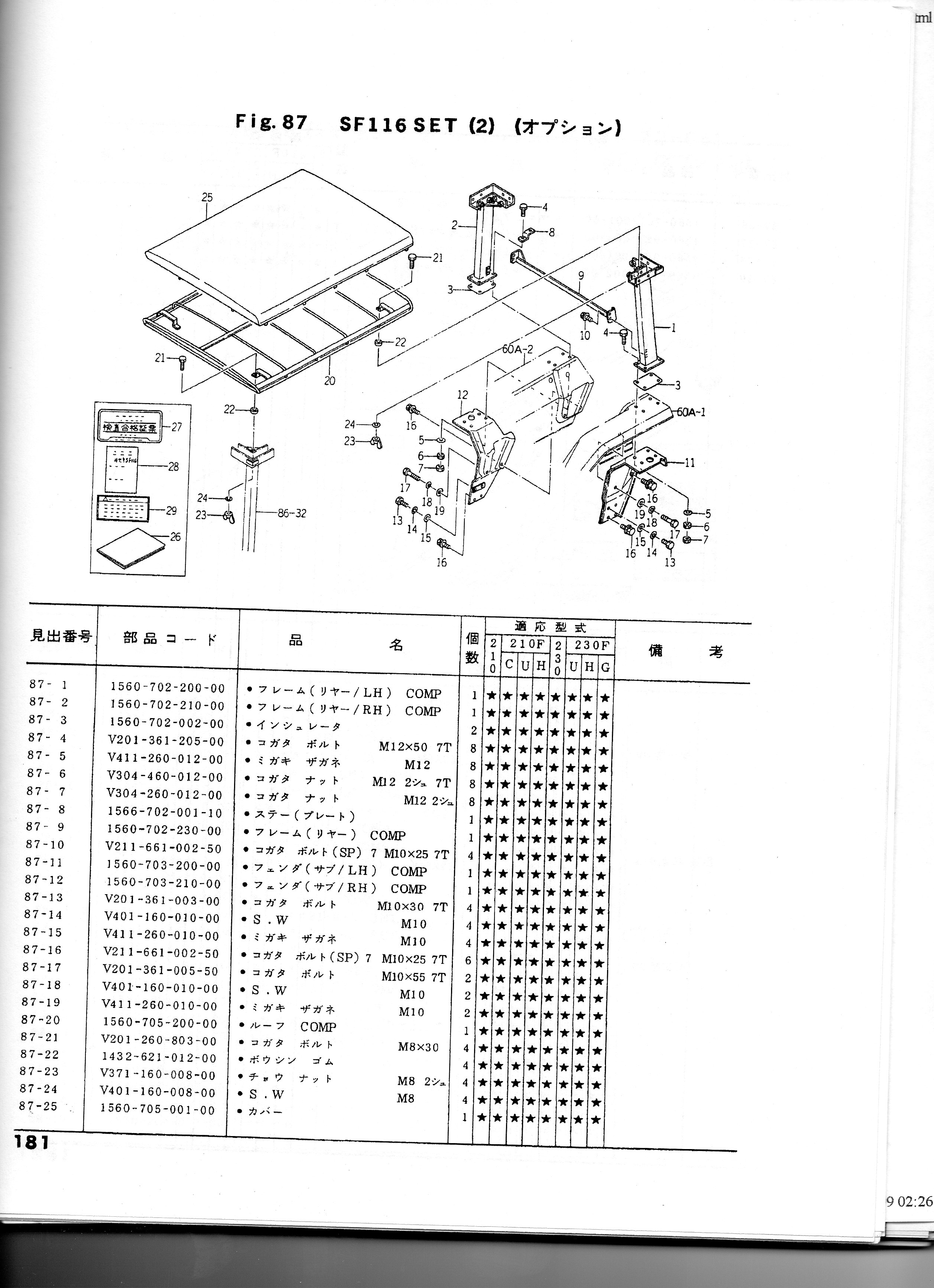

cowboy357..... While the ROPS on the Iseki looks like it's attached to the fenders there is a lot more to it than that. There are additional structural members on the underside of the fenders as well as the canopy and front supports. That ROPS depends on all of the pieces for it's structural integrity. See attachements scanned from the parts manual for my TA 210 F.

I see Wayne , That Makes sense , Thanks for Taking the Time to post the Pics . :D . Bob
