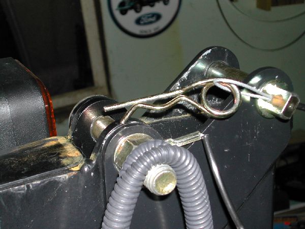

Does anyone have a better (quicker) solution for keeping the pins in place beside the 'rings' that come standard with the ROPS pins? I hope this question is clear, at least to those who regularly fold/unfold the ROPS as I have to do to clear the garage door.

jd; Get rid of the rings, and use lynch pins instead. Thats what my DA came with along with what I'll call a keeper strap. It's nothing more than a small cablr covered with heat shrink attached to the ROPS so you don't loose the pin or lynchpin. One improvement the dealer didn't have to adjust. /forums/images/graemlins/grin.gif

jd2210va; Here is a photo showing what I've got. If you've got a decent TSC near you, the parts could probably be gotten there also. /forums/images/graemlins/grin.gif

Lynch pins are fine, but I've lost two already. Better yet, change to the lynch pin system NH now puts on the DA models. The pin is held by a steel cable which also holds the large pin in case either falls out.

Thanks for that info. I'll check with my NH dealer next time I'm there to see if they sell them for my tractor (don't see why they wouldn't). /forums/images/graemlins/smile.gif
