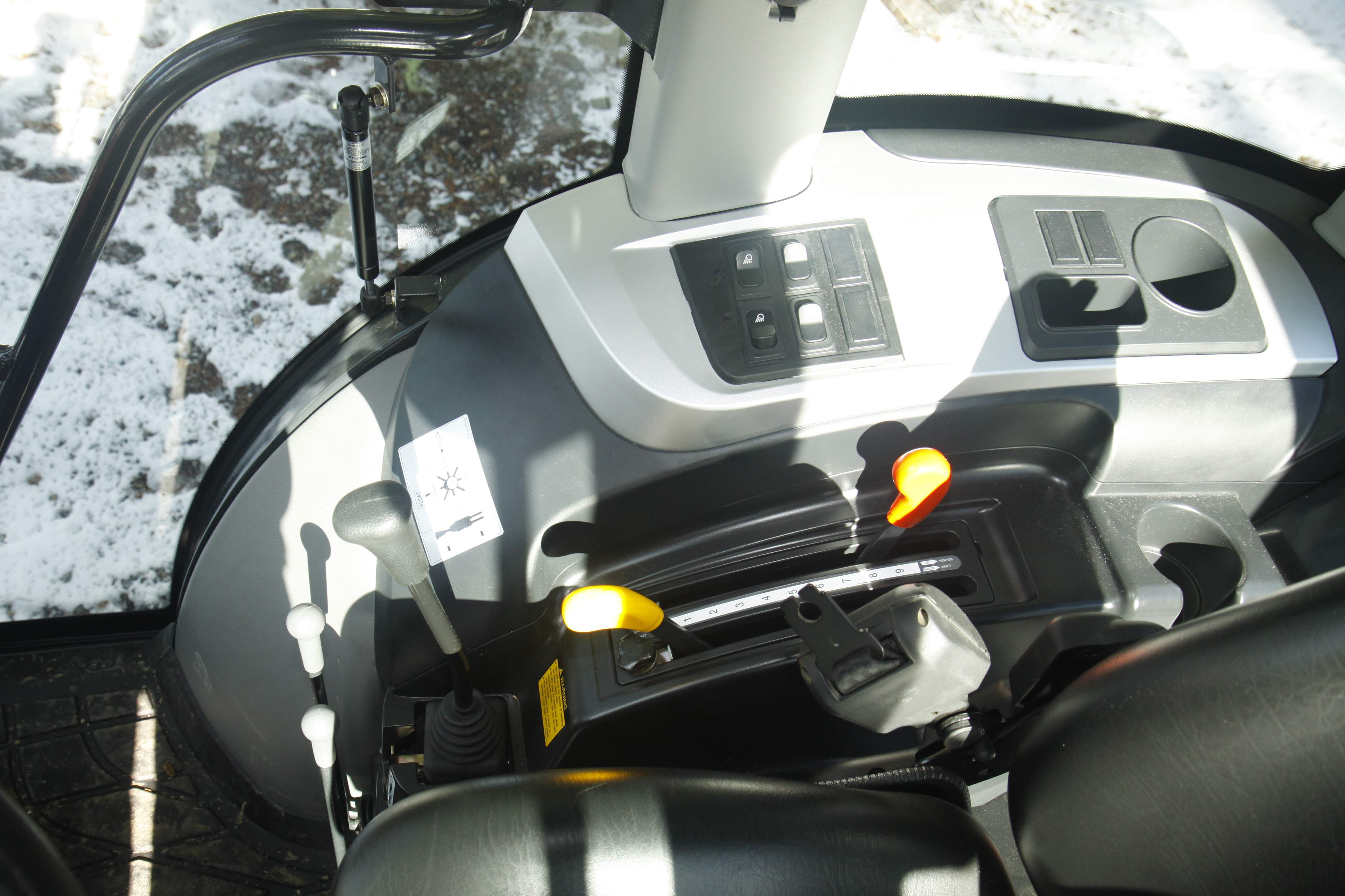

I have a sop model for the DK40 tractor, and it shows a plug already available in the rear fender area for work lights. i assume that this can be used. let me attach a drawing
the book has a huge section describing layout with a cab, but not much for open station. i dont know if there is a place reserved for adding a rocker switch to control the rear lights. i have a cluster available for switches, and have 4 additional spaces available with some control wires already in place.
im not sure if there is a similar place for the open stations.
