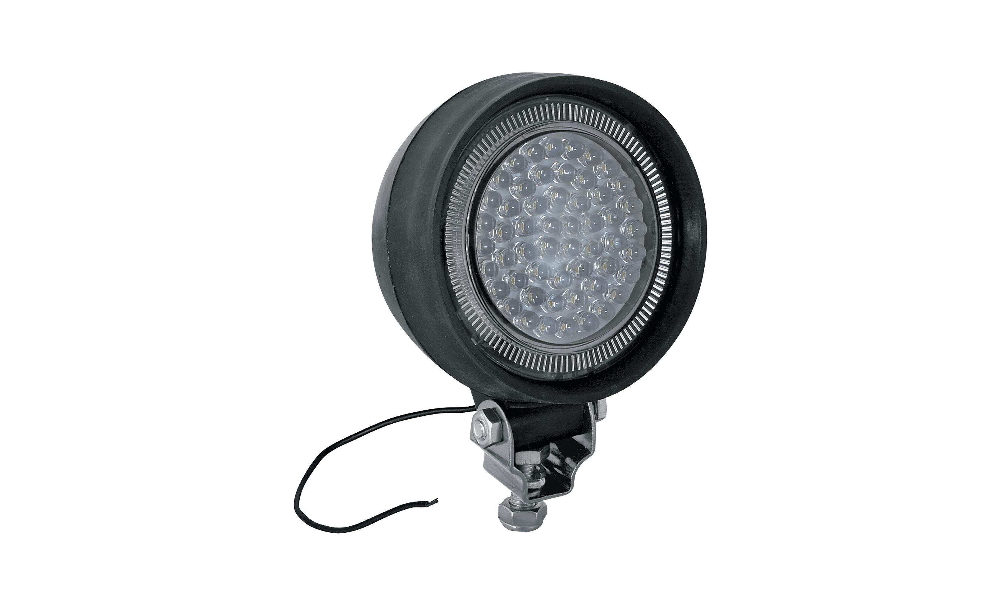

Good thing that you guys are talking about LED lights.
I have been thinking about one of these (see attached image) from Northern Tool. The $150 price tag on the NAPA lights is just too rich for my taste and this thing is about $35. Anyone used them? The reviews seem positive.

   / ROPS work light power source? #24
For 35$ it's worth a try.
An LED is kind of a all-or-none device. Should be good.
-Jer.
