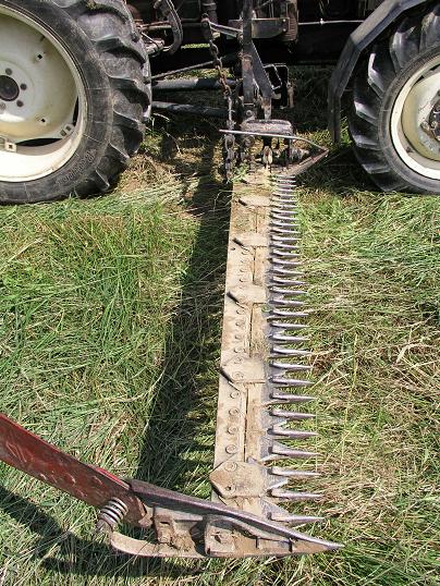

Bob,
When you have rear 3pt mounted sickle bar, grass covers your sight to bar. And when it clogg, you can't see this. Another reason is that you need to look back whole time, or turning your head front - back permanently.
Another reason is that we have G&S licensed mower producer close, and they make side mounted mowers to most common tractors, or adapt one to any tractor you have.
Lot of people cut fresh grass for cattle food. They pull trailor to grass field, disconnect it, cut grass with tractor and haul full trailor home. You can't do it with rear mounted mower.
Maybe this is a habbit here, maybe there is different.
If you didn't see side mounted mower, go there

Thanks for the explanation Darren. Knew I was missing something. Have never seen a double action mower.
Also thanks for mentioning the Rossi's advantage over the NH451. Guys who have both can be a big help to those of us who have neither.

I gotcha now ZJ, thanks for taking the time to spell it out. I'll give that some thought.
Things are a bit different here. Biggest thing I'll be worrying about using a sickle bar is branches and newborn fawns in the grass. Rear mounted might give me a little more time to detect these things.....or maybe not.
