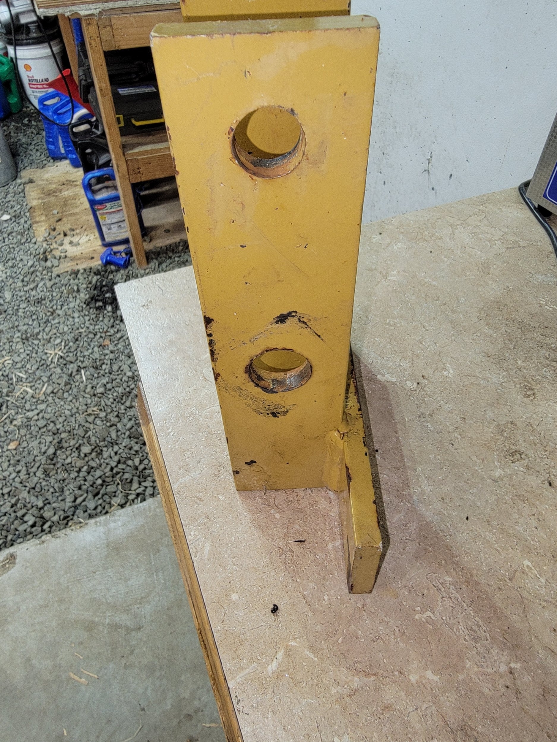

I think this came with a used Behlen rotary cutter I bought. Any idea what's it for, and how to use/attach it? Thanks

It's a bracket that allows the cutter to float better.
Let's say, you go across a ditch, by the time your rear wheels are on the bottom of the ditch, the tail wheel of the cutter tries to "lift" the cutter and push on the top link. With this bracket, it allows for a little bit of movement which then allows the cutter to follow the ground better.

Awesome! Thanks for the help!
