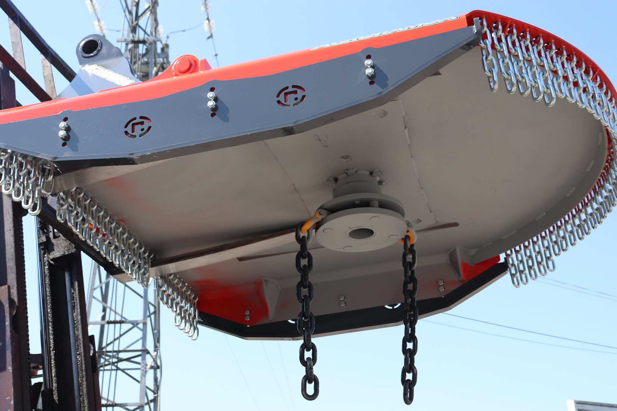

My light duty 500lbs and 51" wide brush mower which equates to a medium duty in the US will eat easily stuff up to and above 2" using grade 80 chains instead of blades.

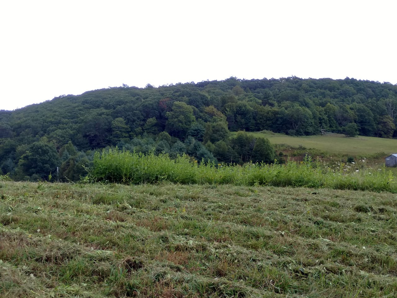

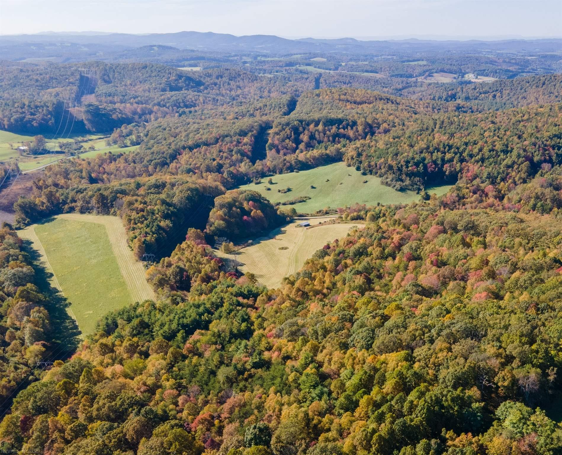

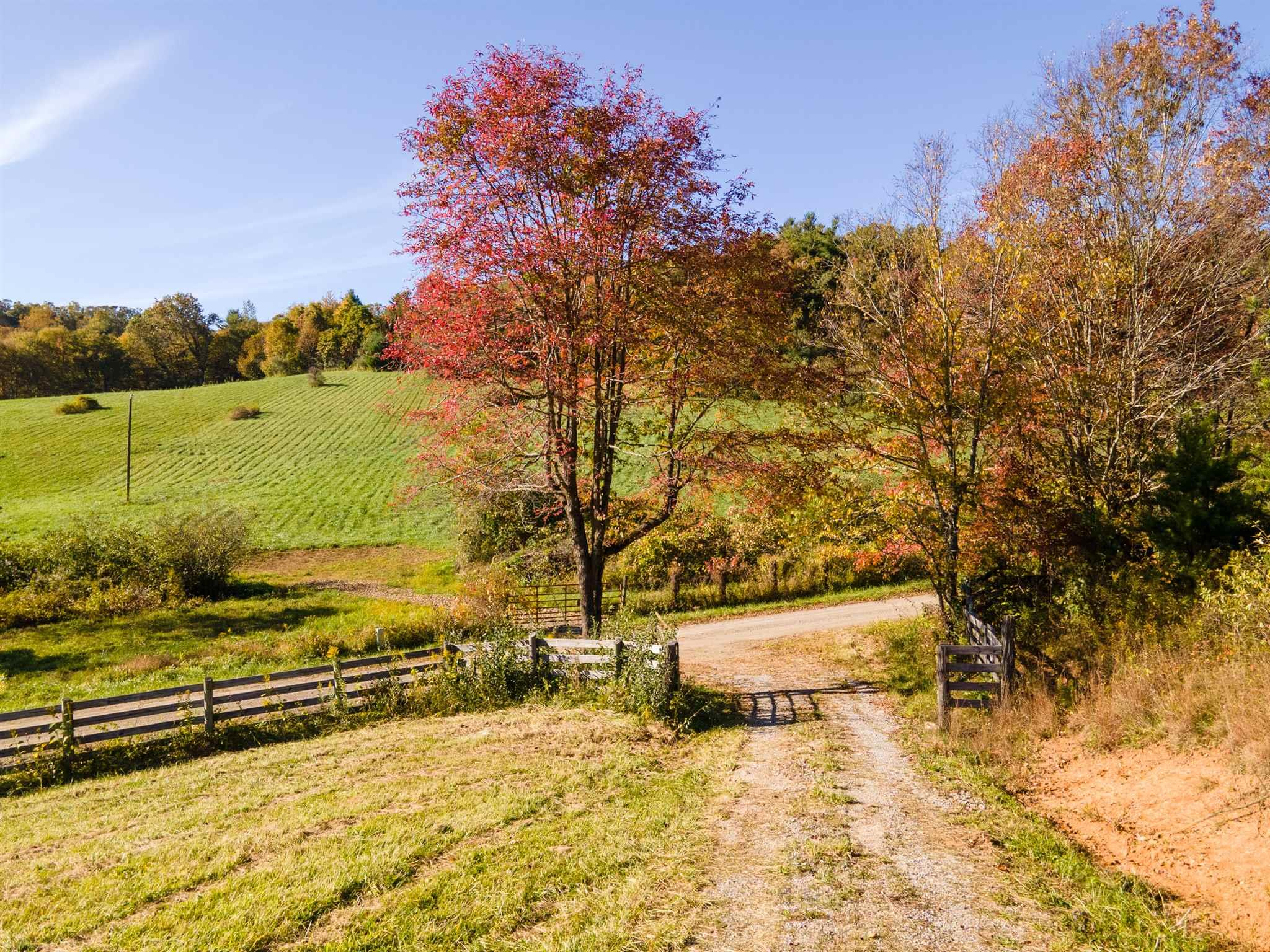

We run a 60" brush hog on hills. Last Fall, vegetation was so thick after 3 years of mowing 2x a year, that I had to slow from 3.5mph to 3mph. I may try to dress up the blades this year as they have not been sharpened. We cut a lot of brush but nothing above 1-1/2".
Hog is a Mahindra standard duty 40hp gear box, weighing 510lbs. Tractor is 33Hp with PTO power of 28Hp if one believes the specs.
The nice green triangle piece shown here is the field. The second photo is taken from the neighbors field near the top of their hill. The last shot is taken from the tractor seat atop our hill looking to the neighbor's property from where the previous shot was taken. The 3rd photo was last Spring at first mowing of the year.
